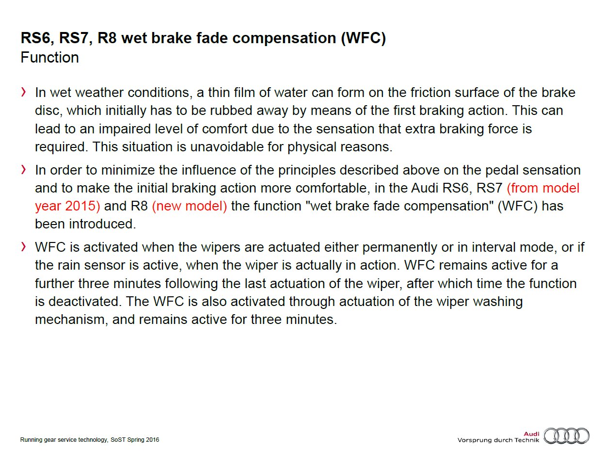

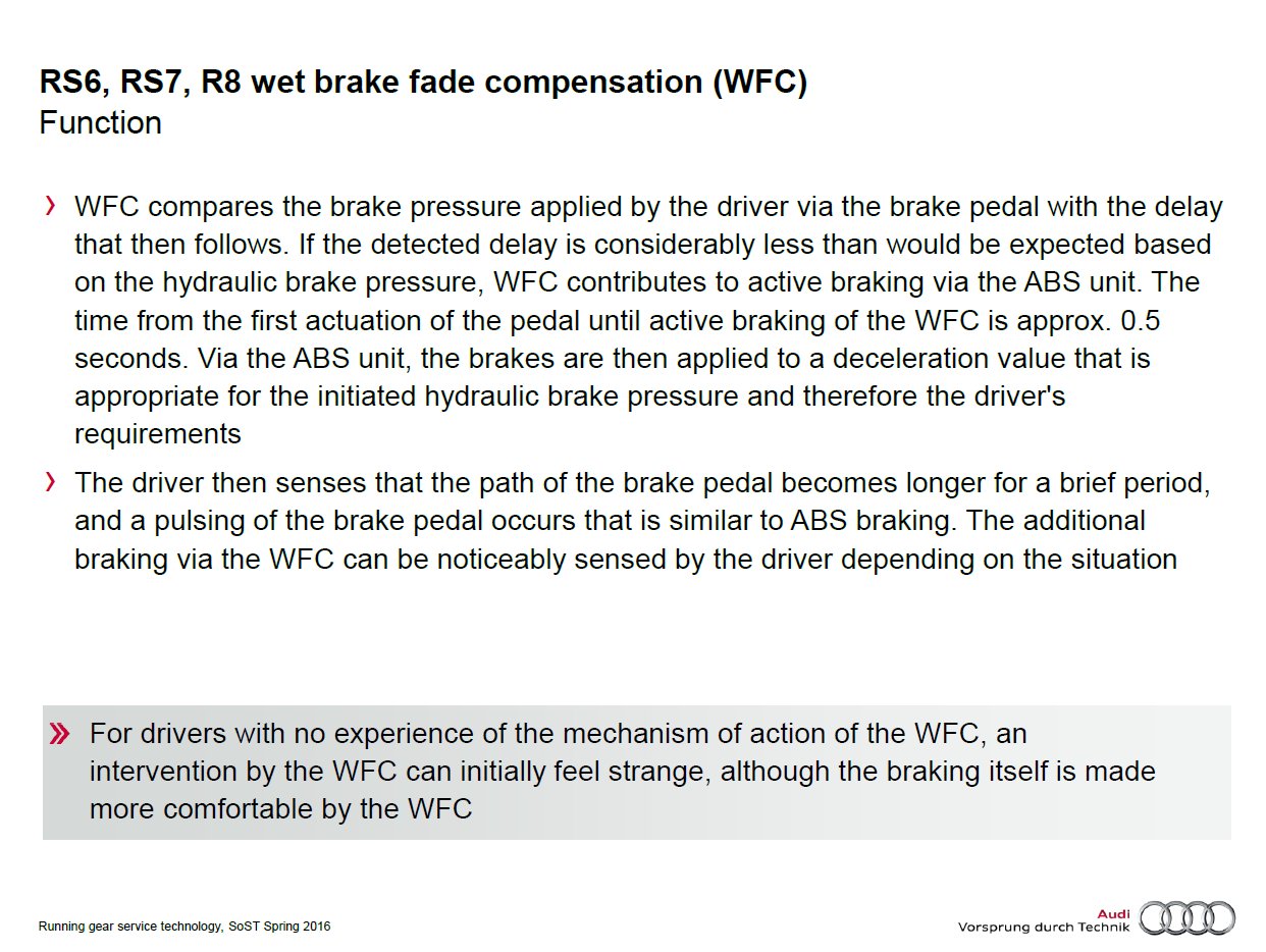

This is what Audi UK say is causing such a weird and unpleasant experience... and it's not just a ceramic brake issue as i have standard steels.The problem is that the system is floored and prone to malfunction. This then becomes extremely dangerous and quite terrifying but sadly not enough complaints mean it has not been taken seriously or investigated further. You can actually trick the car in to behaving normally in these conditions by operating the wipers manually every few seconds - it's an absolute joke.

Re: Ceramic Brakes - Soft Pedal
Thanks Scotty,
Mine is a 2014 model, so I presume I don't have this - just the underlying wet cold disc problem.
I can live with it
I can live with it
