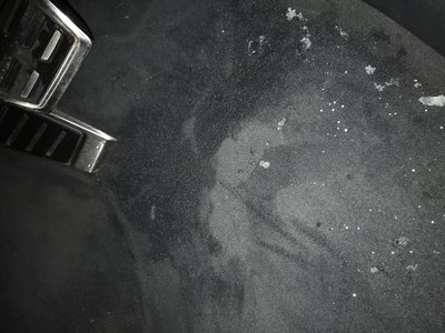

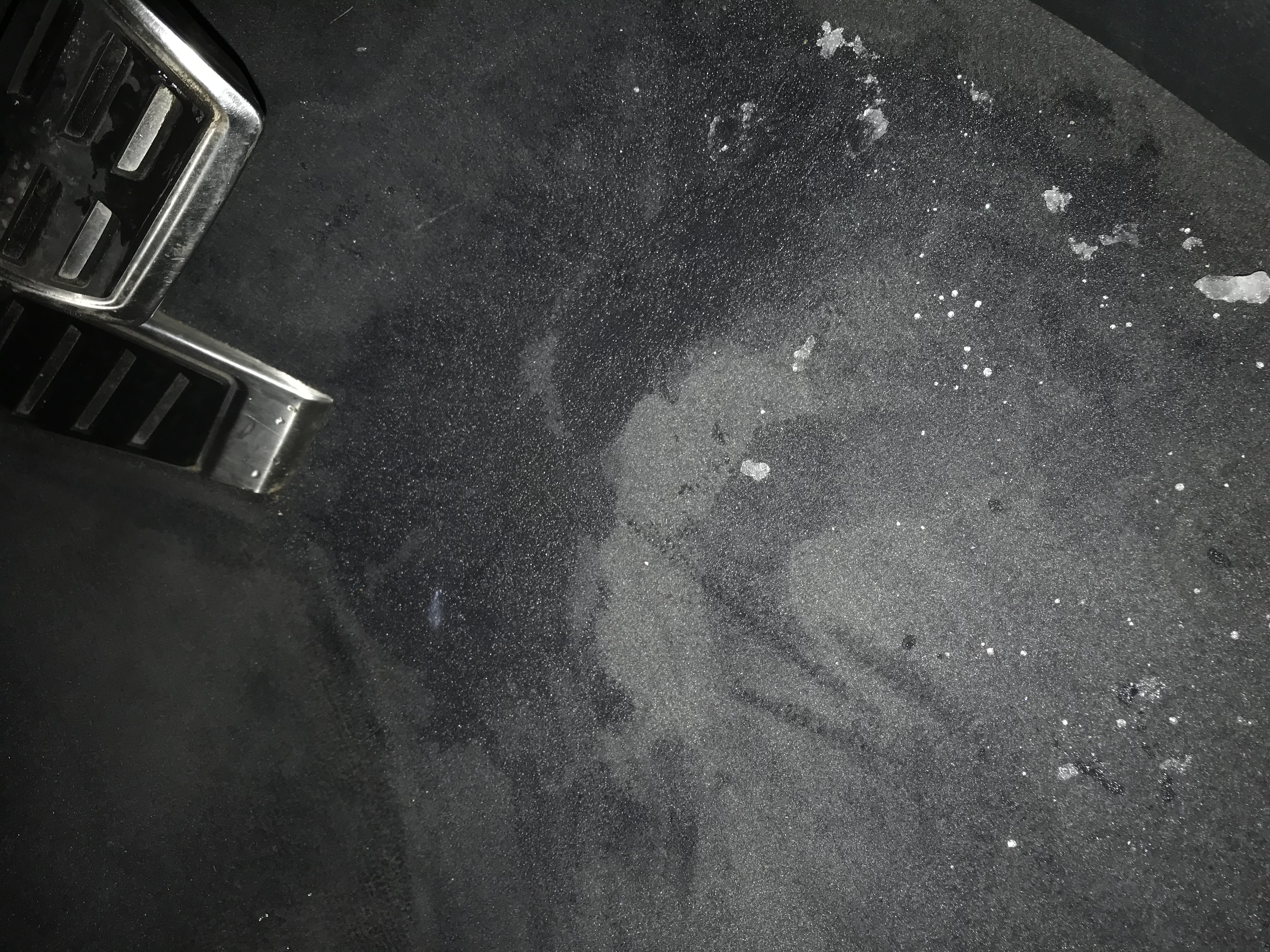

Hi,
I’ve had my car nearly two months and ever since I’ve had it I’ve noticed that it was getting misted up quite a lot. The other day I noticed that the carpet on the driver side and mat was rally wet. The passenger side was a little wet also. I thoroughly dried the the carpets last night. We had a little bit of snow today (near Manchester!) and when I got into my car after work I noticed that it was wet again!!
I’ve heard of problems with blocked drains but I’m not sure which ones to check!

Done a bit of investigation work this morning and it looks like mine is leaking from either the pan roof or windscreen! The water is running down the roof liner, down the sides of the dash and into the foot wells.
Both the drivers side and passenger side is the same so I’m leaning more towards the pan roof leaking. It would be interesting to find out if everyone else facing this same problem have the pan roof?

Those pics definitely look more like pan roof / A pillars than through the scuttle / bulkhead
