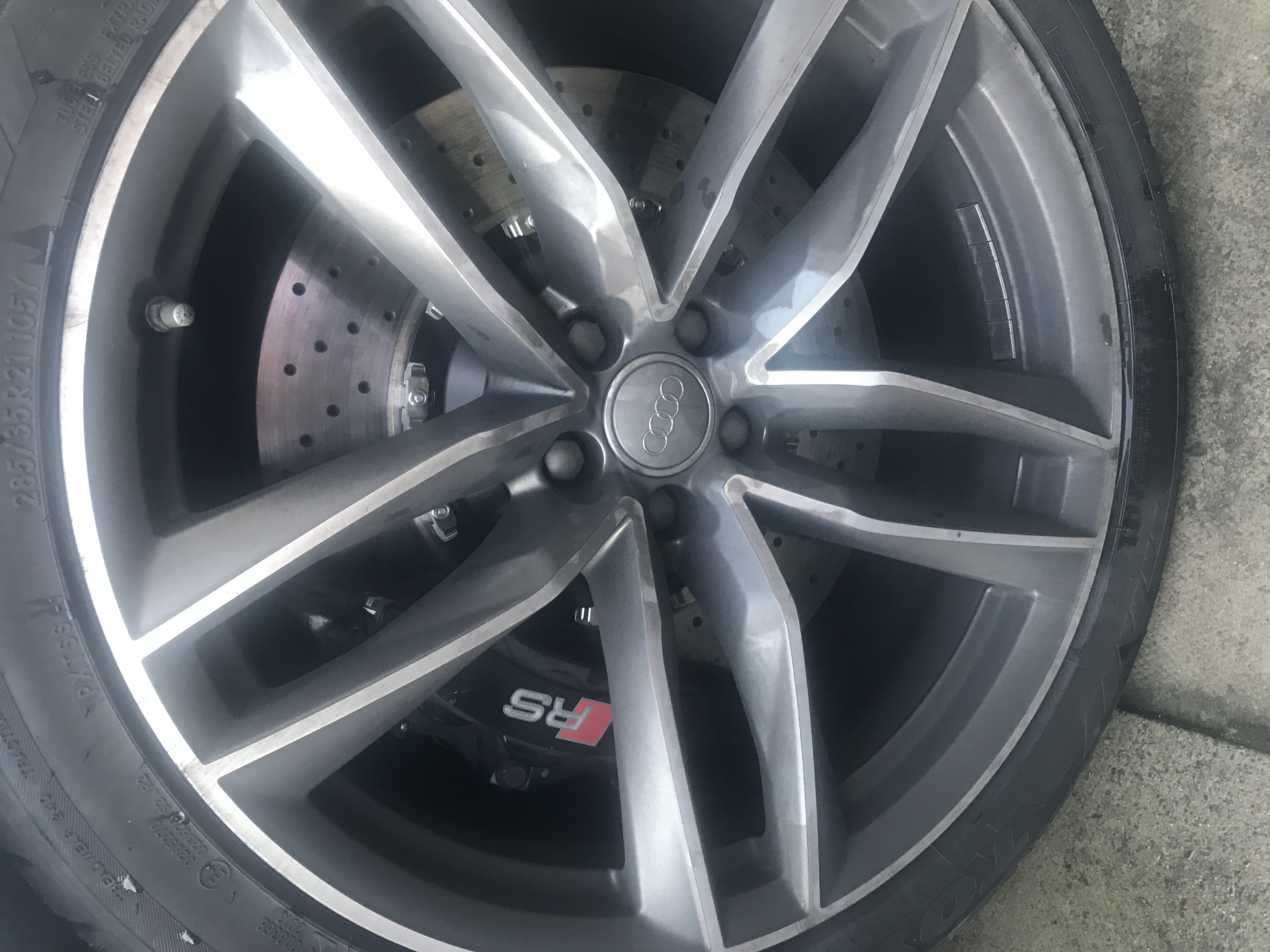

I have big 410mm rotors but the pads are TRW and I did not bed them in. The horrible noises etc have gone but vibrations are horrific and the discs seem to have continual residue on them.

Re: Front brake pads
Excuse the very unclean wheel....
You can see the brake pad residue on the disc surface...
