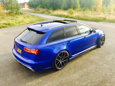

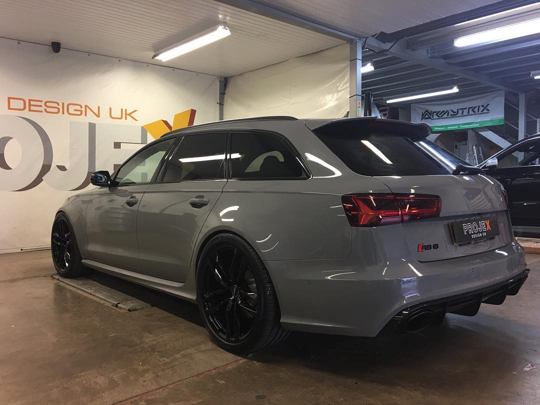

Hi all,
I want to space my 21" alloys, and thinking 15mm front, and 20mm rear, im trying to acheive the absolutely perfect look like this one below, does anyone have experience of what fits best?
Re: RS6 C7 | Spacers, whats BEST combo?
Post by MikeFish » Mon Feb 05, 2018 1:28 am
That car is lowered. How low you go will dictate what spacers you need.
I run 15mm rear spacers and none on the front with my 21s and 12mm spacers with my 20s. Both sets rub at the front.
That is with 40mm springs all round.
Older cars sit a little more level in my opinion.

I will be lowering 20mm

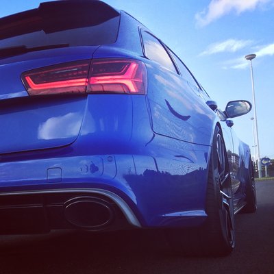

Post by MikeFish » Mon Feb 05, 2018 1:36 am
This is a close shot of 15mm rear spacers. 20mm rear might work but it'll be close.
Sent from my SM-G935F using Tapatalk

Post by RS6chris! » Mon Feb 05, 2018 8:18 am
Approx 25mm drop
15mm front Spacers
20mm rear Spacers

Post by Yossarian » Mon Feb 05, 2018 11:42 am
finance-nick wrote:
Mon Feb 05, 2018 1:18 am
Hi all,

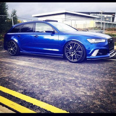

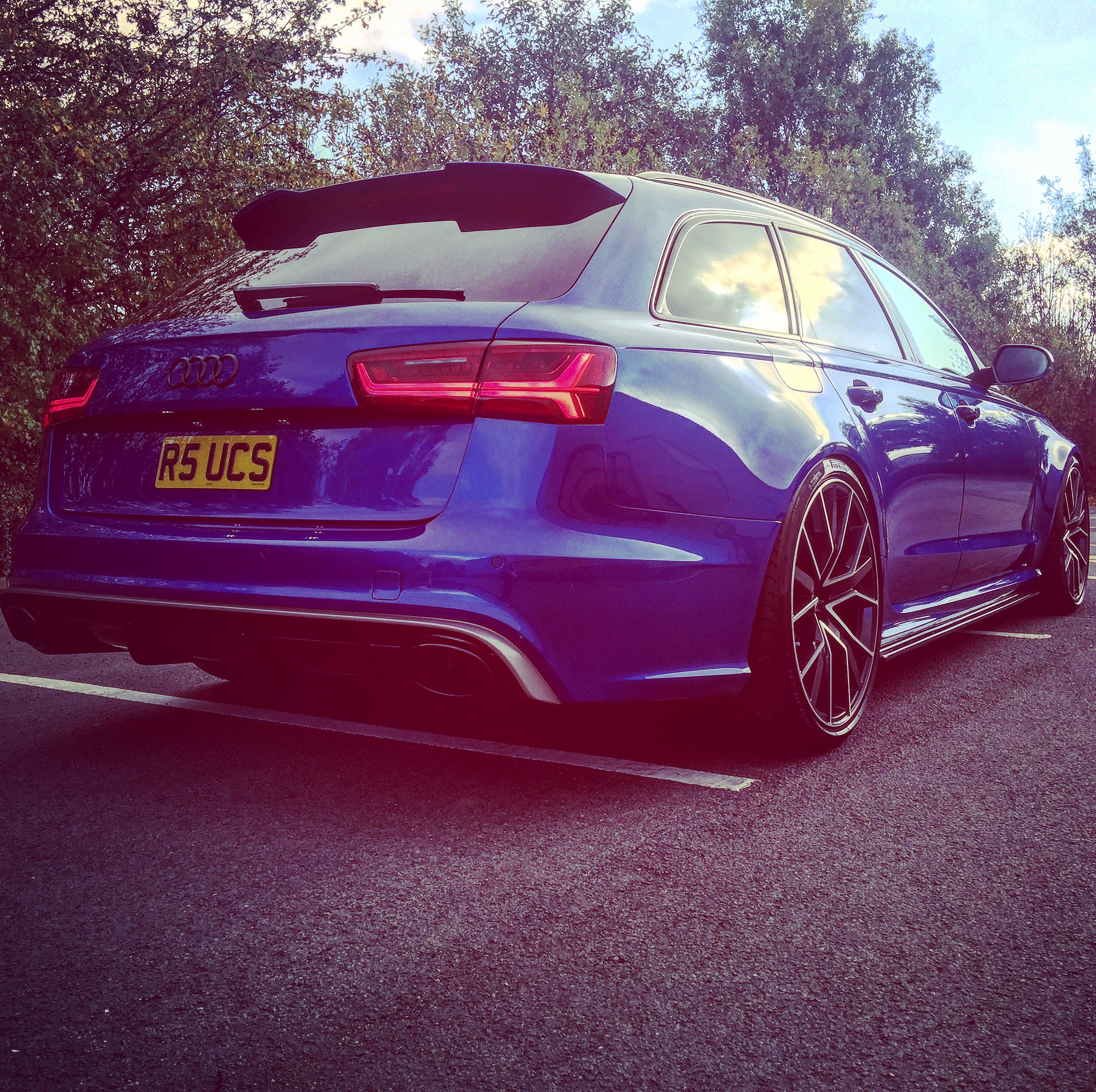

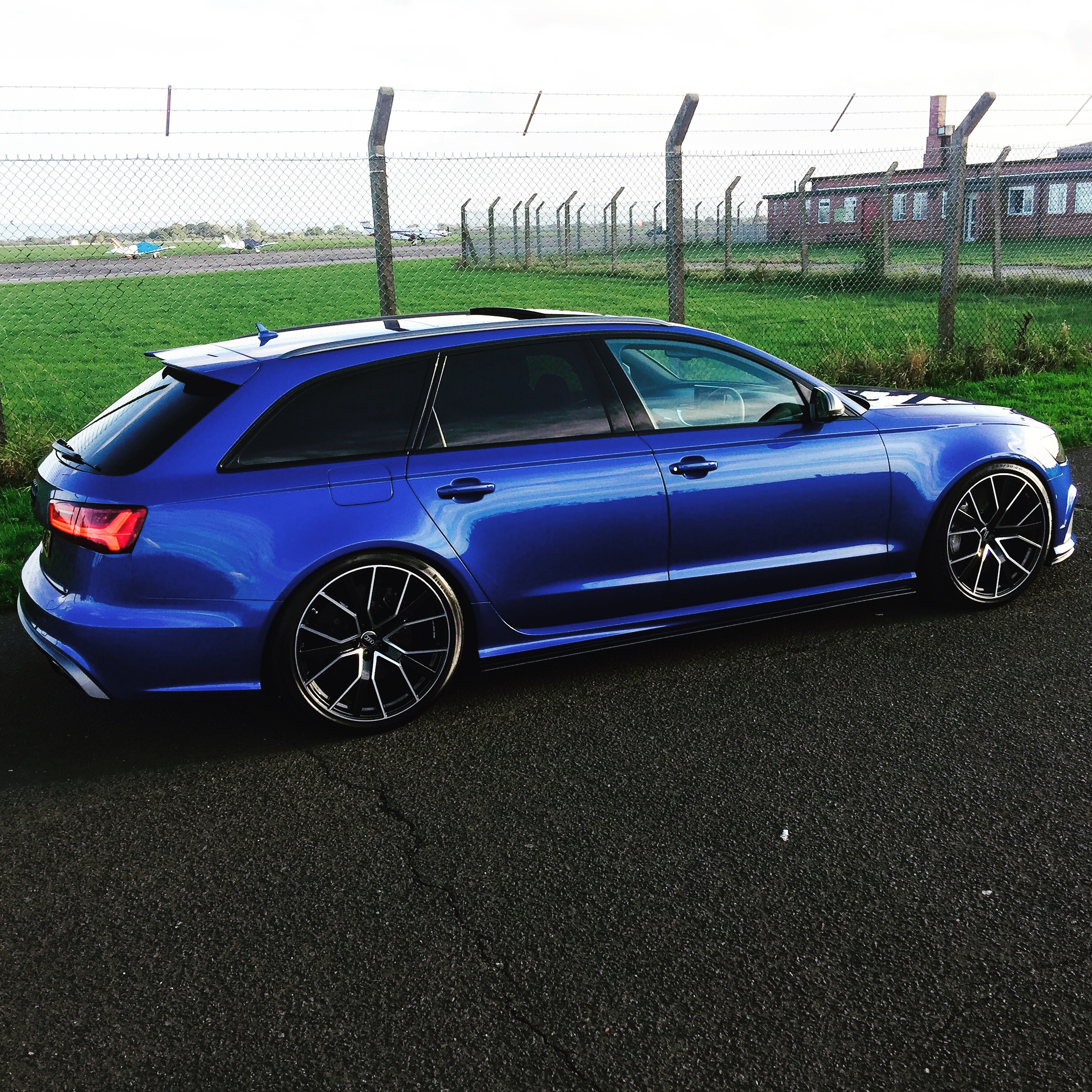

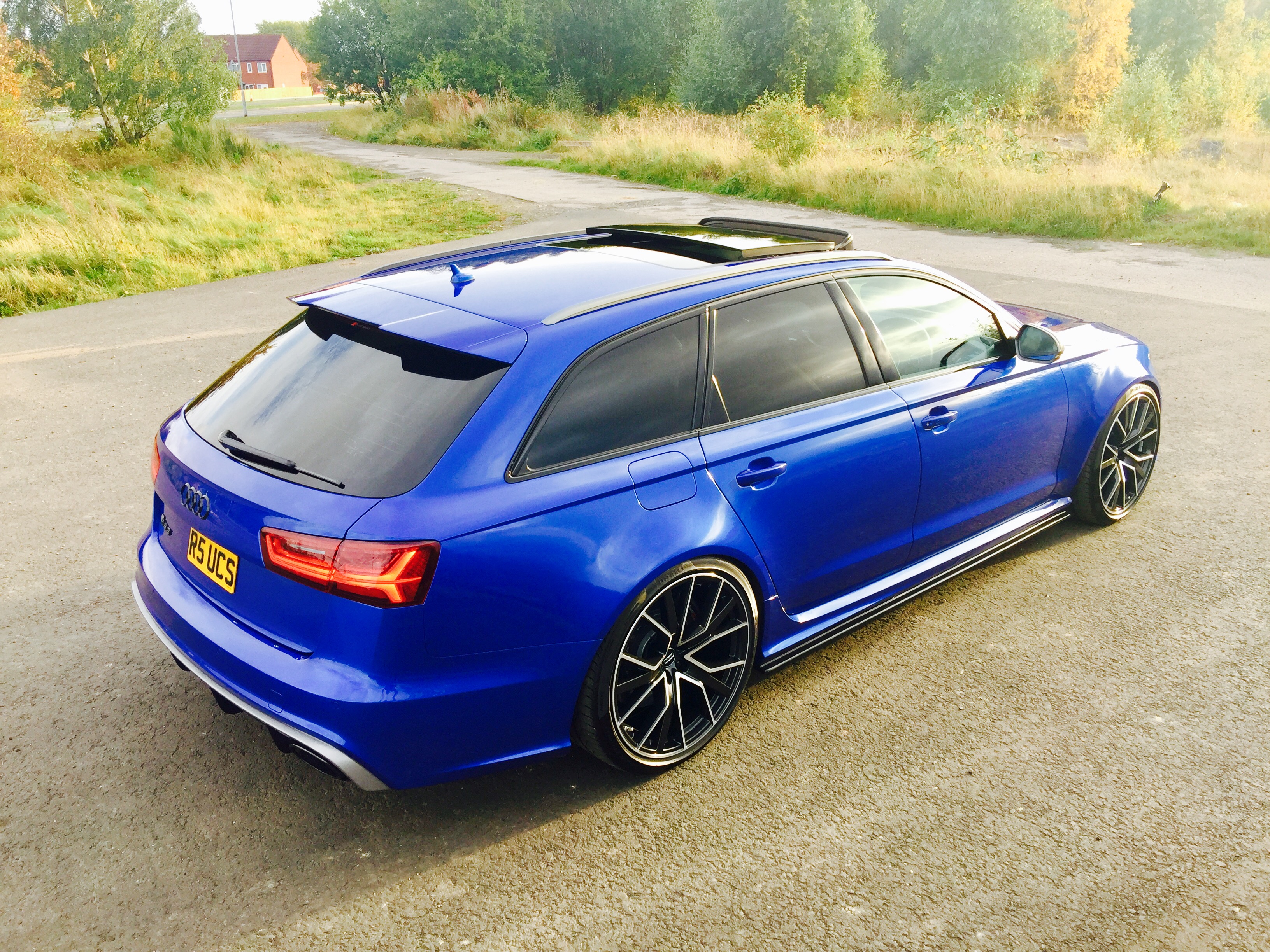

I have 15mm front/20mm back with Cete lowering module as on air... the spacers work perfectly and I just had to adjust the ride height carefully to ensure absolutely zero rubbing. Fronts are nicely tucked with the geo I had done at Centre of Gravity and back sit flush.
Steve

Post by finance-nick » Mon Feb 05, 2018 7:51 pm

Here you go:
finance-nick
Posts: 81
Joined: Tue Jan 02, 2018 11:15 pm
Post by finance-nick » Mon Feb 05, 2018 10:11 pm
wow looks great thanks steve, what drop is that?
Yossarian
Posts: 57
Joined: Sun Apr 27, 2014 9:52 pm
Post by Yossarian » Mon Feb 05, 2018 10:34 pm
Thanks - not sure of the actual drop from standard air height but on the Cete lowering module is 10mm lower than standard Dynamic (which is already quite low on factory air). I'm really pleased with it now.
