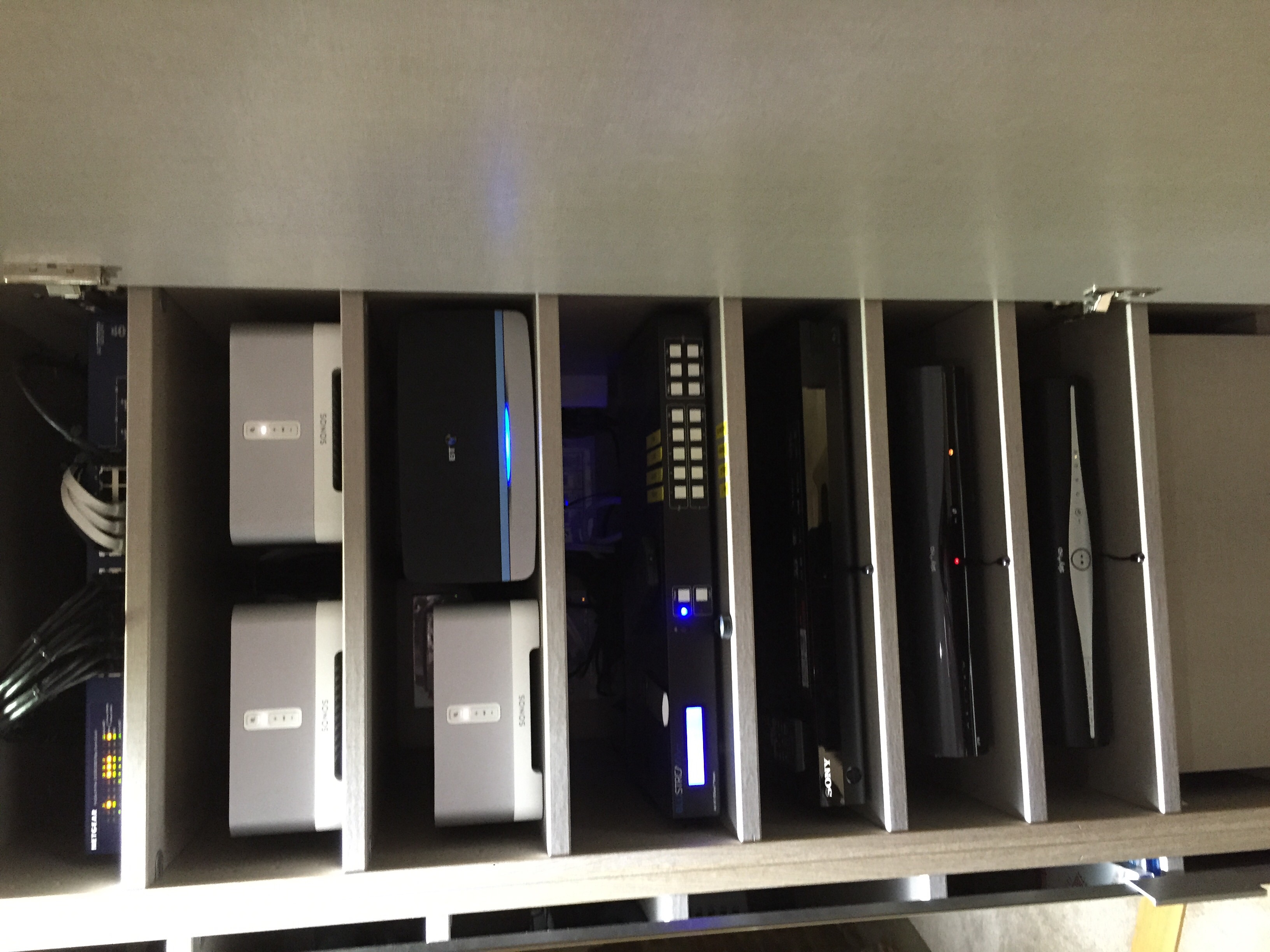

There both upstairs in a cupboard, here's a pic of the cupboard I'm having the trouble with,
They all have the infrared senders which are what are bouncing back to each other.

I'm with Mike, you can feed RF2 with the IR signal. You can get a jobby that'll take an IR signal from a 3.5mm connection and feed it to the RF connection.

Noice set up bitch! Can't you cover the inside of the door with a Matt wrap?

Cheers! There's another cupboard with more Sonos and gizmos in it too..love the man toys!
I might try the Matt wrap thing, nothing better than pimping out the cupboard even more! I'm not sure the matrix will accept any other ir signal other than the ir extenders it supplies as it distributes the TV and the ir around the house over cat 6 to each TV.

Those IR senders look like standard stuff, what do they connect to? Bet there's a 3.5mm jack on the other end.....

You need the IR senders that stick to the front of the sky box, not send the signal to bounce off the door. Alternatively, put one sky box at the bottom and one at the top and if that doesn't work try and place something between the 2 shelves to block the signal.

Sky boxes and IR senders don't mix that well, there's no defined point on the front of the STB. Plumbing it in direct is the best solution, as I found.
