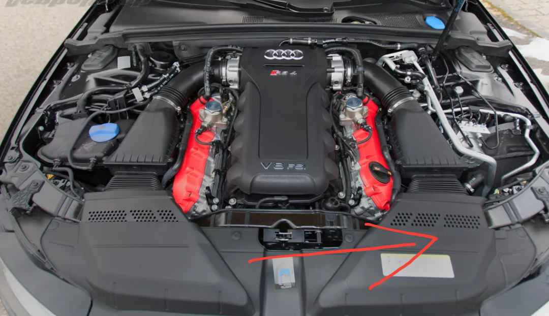

Is there an actual dip stick on these engines? And where/how easy is it to access?
Re: Dip stick oil levels
I believe there is a dipstick hole situated on the left hand front of the block (obviously!
) - right hand side if looking at the engine. The plastic trim has to be removed to access it, and it is plugged - intended for a workshop manual dipstick check if necessary. Dealers have a dipstick with different capacity markings for different vehicles solely for manual checks.
I only believe this is correct as I watched an RS5 of the same era as the B8 RS4 having its level checked manually at a dealership, so I presume the RS4 is the same.....but will stand corrected of course!
I believe this plastic intake has to come off and the access to the dipstick hole is underneath.
Cheers johnnydog, may have a look, if have share day to take trims off!!
Assuming that you find the bung for the dipstick hole, don't forget you'll need an actual dipstick of the correct length and level markings. There won't be one in the block.
Found it, got rubber bung on top, couldn’t be bothered to take air inlet cover off
Good to confirm at least that the RS4 actually has one as well as the RS5
