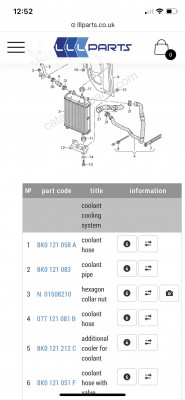

Got a intermittent plant leak, looks like it’s coming from passenger side aux rad.
Went to audi a got a rad which is 8E0121212H
But my mechanic is saying the rad on the car is 8k0121212C.
Did they changed part, or have Audi given me the wrong part

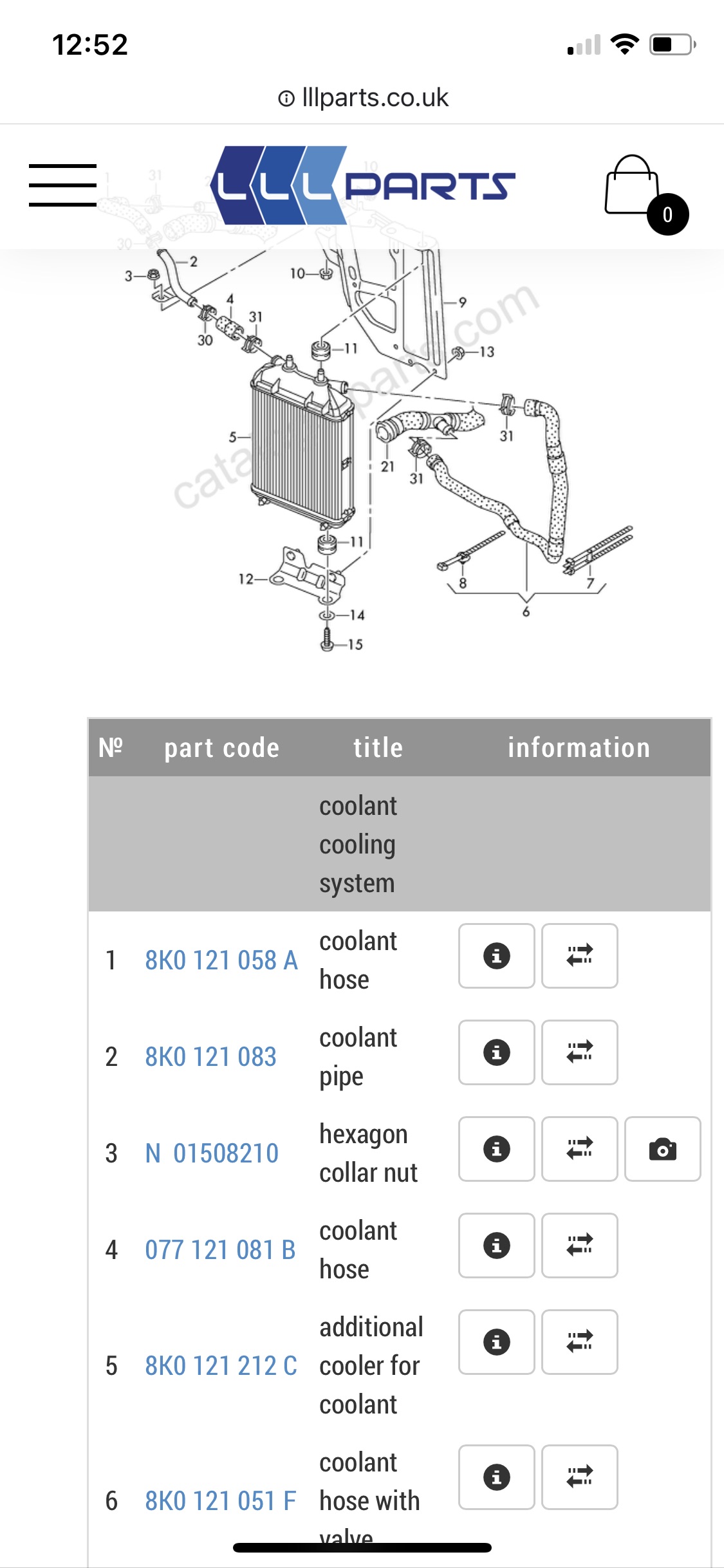

8E in the part number would denote it’s for the B7 chassis, 8K would denote the B8 chassis, it sounds like your mechanic is correct.
I’ve also checked on lllparts here https://www.lllparts.co.uk/en/audi which confirms your mechanics advice.

Thanks pal,matthew.lewis2 wrote:8E in the part number would denote it’s for the B7 chassis, 8K would denote the B8 chassis, it sounds like your mechanic is correct.
Dealers do my head in, why can’t they get simples things right.... they had my Reg.... how is it so difficult
