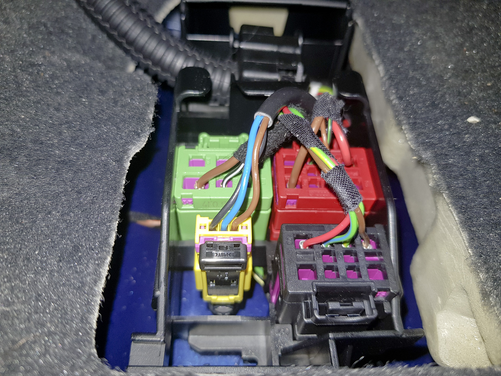

Pics of passenger side plugs??

jangol wrote:Image
Any views of the pics..
Want to see what thoughts are on this subject

Well the Blue and Black wires have been cut and they're for the side airbags, have you un-ravelled the tape going down the side of the yellow connector to see what going on there. That's your side airbag plug and where the resister should be I'd have thought.
Here's mine (normal seats) for reference.

Professional install my butt.. Not an ounce of solder anywhere. Anyhow, any ideas on how I can resolve this issue, do the black & blue cables from main loom need to join the yellow plug & resistor also?
or just need a good purchase between plug & resistor ImageImage
Quality bodging! :bash:
