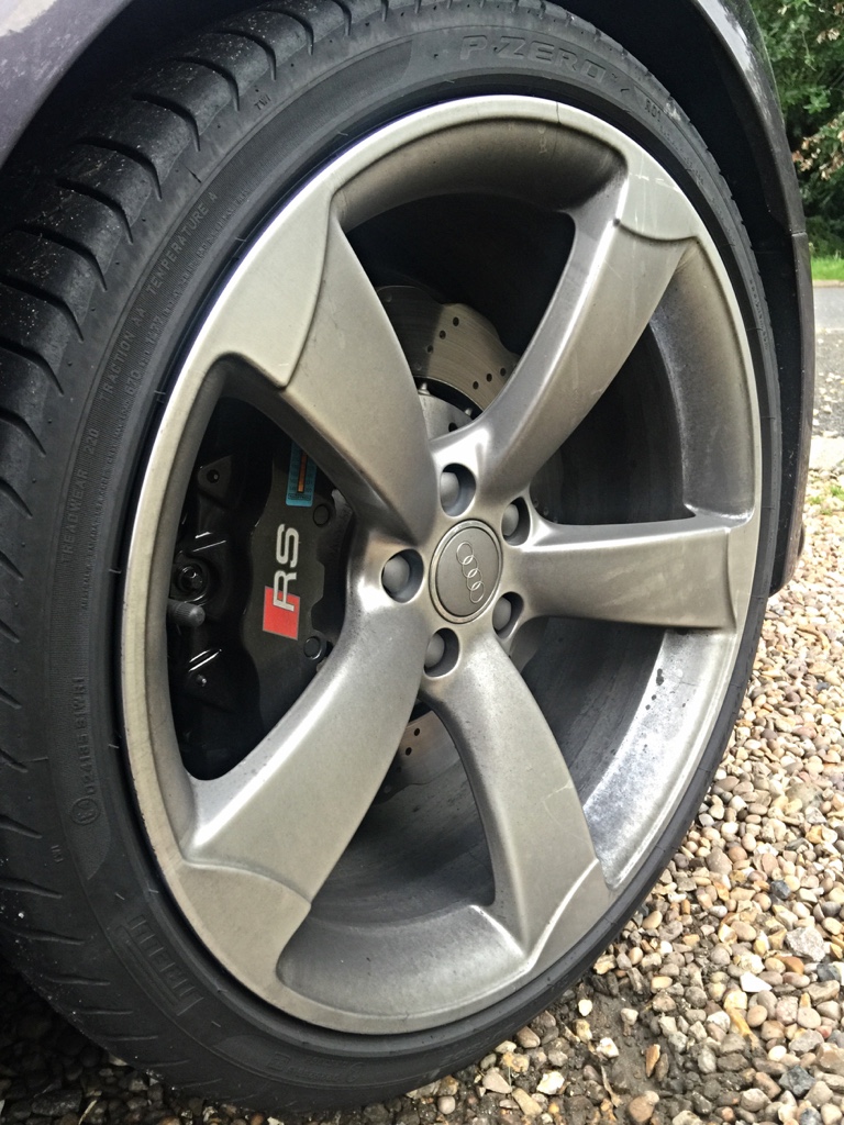

I had EBC yellow pads fitted just over a week ago.
800 miles later.
I've never seen brake dust like it, I've cleaned them off twice and the wheels look grey dipped.
EBC have offered to change the pads if I find the compound in them no good!
I can see why now!
However the harder compounds will kill the discs sooner, currently mine have 22mm left, min 20mm, so the discs will need changing next time, which may be soon! Looked at JP drilled discs, apparently they are more actual "floating" discs which should help the heat/fade issue with stock wavey discs. With paigent pads (may have spelt that wrong !).
Any thoughts on that ?
Anyway, the EBC yellow stuff, 800 miles.
More dust than stock pads create in thousands of miles.
Mine are currently still squeaking at slow and crawl speed braking, particularly when coming to a stop!
After appx 100 miles at motorway speed braking I'm not so sure, they don't seem to good when they are heated up.
Early days ? I wouldn't have them again, I can't see them improving, I will be changing ASAP !
800 miles later.
I can see why now!
