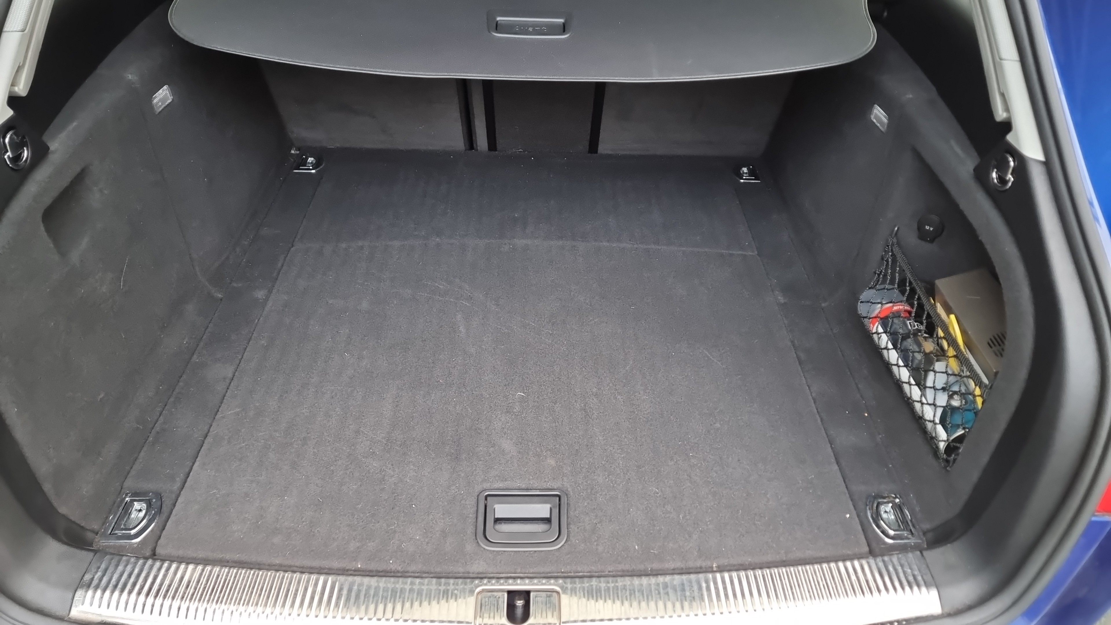

could you show me a pic of the wheel in the boot? Im not sure it would fit in mine with the battery and other stuff?

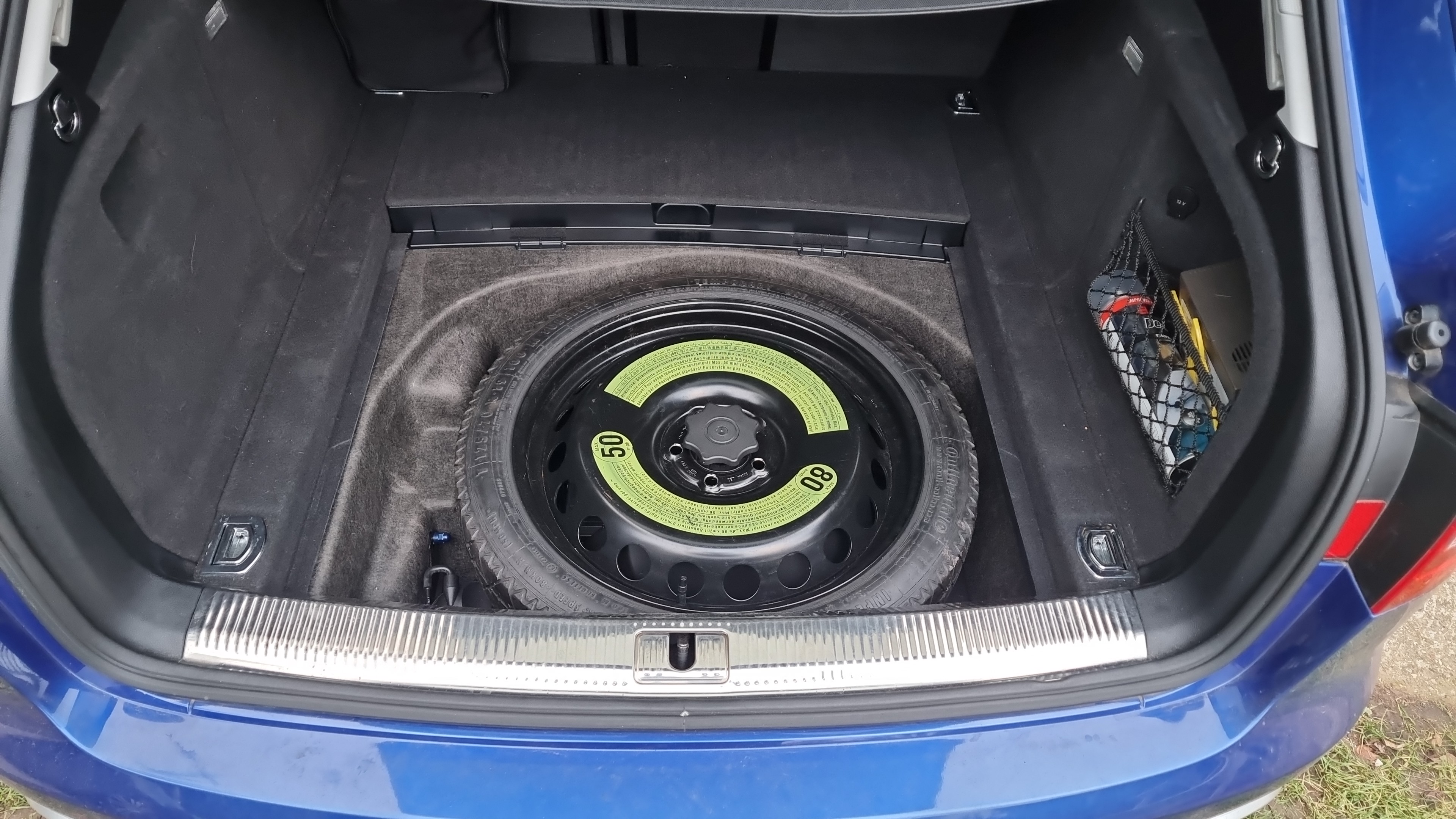

It can be done as you can see via my attachment.
Just need to remove the plastic holder for compressor etc and it all fits in as factory etc.
If you have a flat on the front just jack up rear, remove good wheel and put spare on rear, then jack up front and replace etc.
You should still have full tool kit for this from factory in the boot.
So now our b8.5 rs4 has a genuine spare just in case.

wow i didnt think that would fit over the battery!
