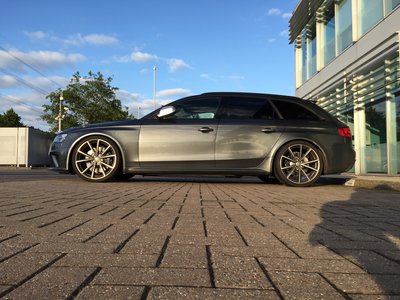

So took a trip to QST yesterday, could not be happier.....!!

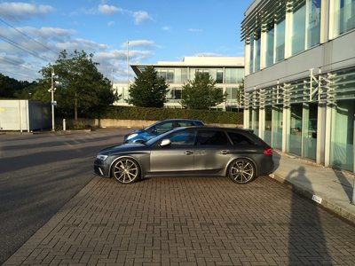

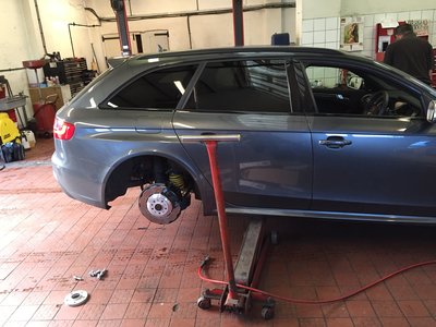

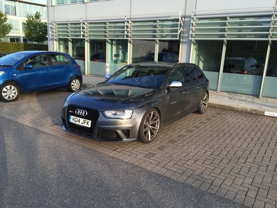

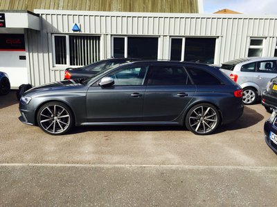

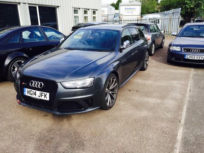

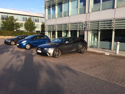

The car needed some new brakes and whilst i was in two minds whether to chop her in for something else, i just couldn't find anything id rather have, (that i could justify buying, sure, id rather have a 675LT...) So, one thing led to another and the midlife facelift has begun....
I went with the KW adjustable springs and 10mm spacers all around. (Tried 15mm spacers on the back while i was there but there was a tiny rub on the off side rear, with driver and one passenger, and as i use the car daily, (and its due some new tyres which will fill the arches a bit more), i decided to go with 10's). Wanted the adjustable springs because i was keen on a very slight, nose down stance, (plus, i was advised against the HR's).
All i can say is, if you have standard suspension, get these fitted.
In comfort mode It has taken away 90% of the front end wallowing, is more comfortable, and, the DRC has stopped knocking!! (not sure if this is a good thing or not warranty wise!). In dynamic its firm, sure, but only marginally more so than std and where its lower it corners even flatter. God help the new set of tyres when there fitted next week.....!
Here's a few, (crap) photos for you, (i know it needs a clean!!).

10mm spacers do change the stance of the car perfectly and along with the KWs it looks good.

Looks great, however check the inner edge of your tyres after 5 k
They will be scrubbing out!!
You need adjustable top arms,some people will say you don't, but it's impossible to set be camber up properly without them.

2nd from the bottom looks great, Daytona really shows the cars boxed arches.
