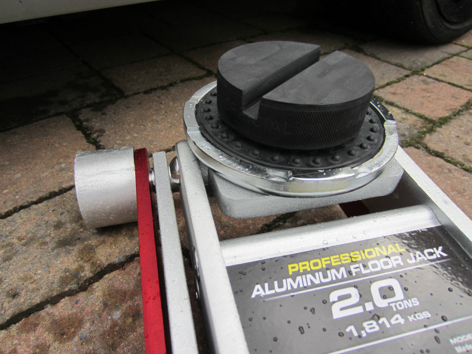

Don't know the answer but could you not use one of these?
http://www.ebay.co.uk/itm/Rubber-pad-ru ... 418fecd2a8

I used the points as mentioned above with no problems. I did make a tool the same as the rubber one out of wood
I did contact the guy on Ebay as it doesn't mention RS4 fitment and got no answer, however i think you would need a slot of approx 12mm wide by 20mm deep and 110 long maximum if i remember correctly. If you trawl through all the different ads it does tell you the slot sizes
I was going to machine one at work but couldn't find a suitable material

It doesn't fit.
Better off with attic sheet if neoprene on the jack pad.

Aye I've got a couple. The slot is too narrow. I just use them on axle stands on my MK2 golds.
If you have a low profile jack some neoprene or heavy rubber sheet is best really.
