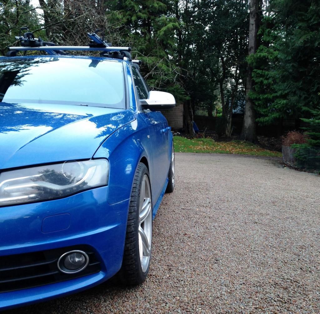

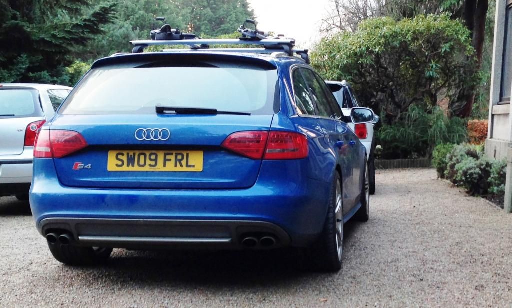

So I tried the peeler 19in S5 wheels and sure enough the front would not work. Interestingly there was no rubbing on the front, rear there was but only on a very severe dip with loaded car. See below.
Anyway Im loving the car and how it drives on 18's and was looking at spacing stock wheels but then thought about the 18in S5 wheels that are available. These are 8.5 et29 so will be 3mm further out that the 8.5in S5 19in and I have the stock 245/40/18's in the shed to use so a narrower tyre that the Peeler wheels. Should work, just wondering what it might look like. Photo below shows how the car sat with 9in et33 and 255 tyres.
Anyone tired these S5 18's on a B8? Its the snowflake style ones.
