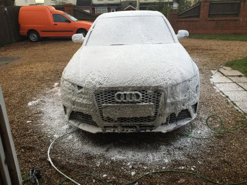

Post by robokn » Sun Nov 30, 2014 12:19 pm
Well car getting snow foamed,
And here are the images
TechNick
Posts: 1147
Re: B8.5 RS4 Bumper to fit B8 NOW with PICS
Post by TechNick » Sun Nov 30, 2014 7:28 pm
Looks great, but are you missing a parking sensor there?
Post by robokn » Sun Nov 30, 2014 11:09 pm
Yeh th glue wouldn't set back in tomorrow for full alignment and gluing, ran out of time Friday night

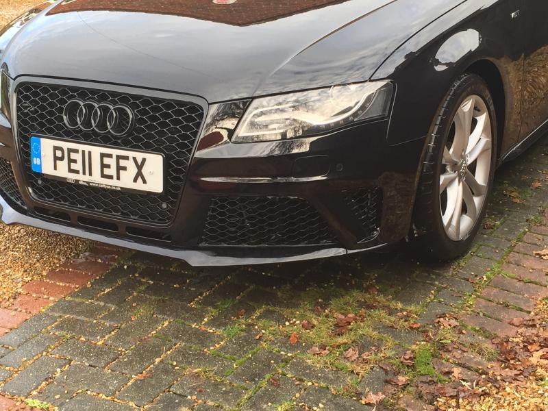

Post by jaygemson » Wed Dec 10, 2014 9:48 am
Hey Rob, did you get the final parking sensor and alignment sorted? Any more pics? :bigblink: :biggrin2:
robokn
Posts: 159
Joined: Mon Jan 14, 2008 9:54 pm
Post by robokn » Wed Dec 10, 2014 10:15 am
Yes was a little long winded TBH as we had to
*cut some of the under tray away to keep it aligned
*shave some of the actual washer jet no effect on it at all
*re route some of the wiring
and trim the washer jet housing
But sounds alot but actually took about 30 mins all aligned and working so happy days, only one in the UK
