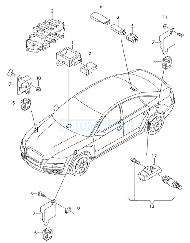

Re: TPMS Error Code 01521 after 10mins of driving
Since the sensors work initially, has anyone ruled out a fault in the TPMS receiving antennas/transceivers? On this platform (C6 RS6), are the receivers integrated into the wheel well liners, or is there a central aerial system that might be failing after sustained use?Jim Haseltine wrote: ↑Mon Mar 10, 2025 6:38 pmI regularly but at random intervals get two errors:
From the diagrams, the receivers are in the arches but send their info to a central processing unit behind the dash with the rear sensors using an antenna to do so, which is in the right rear boot area (by the jack/locking wheel nut etc).
