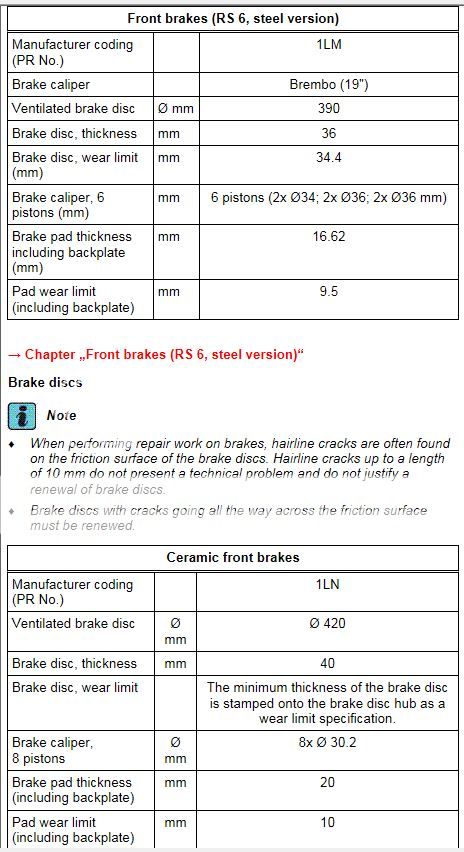

Guys looking to purchase a rs6 with ceramics fitted
Wanted to know if the wheels I have sitting in my garage will for the rs6
Anyone here can tell me what the overall diameter is from edge to edge on discs/calipers?
So I can see if the wheels will fit over the brakes
I’ve measured up the wheel and it measures a just under 450mm

The front discs measure 420mm, so that leaves just 15mm for the caliper, which seems a bit slim.
What diameter, width and offset are the wheels?

20” Rohana alloys
11j
Will have to check offset
I don’t see the calipers being more than 30mm
If the discs are 420mm
Let’s say calipers are 20mm
Still 10mm left to play
I think it should be ok
Unless anyone else here has the ceramic brakes option and can measure edge to edge for me just to be 💯

Depending on wheel options the standard C6 offset for the 9.5J 20" rims is ET36 for both steel and ceramic disc versions; for the 9J 20" its ET38
Disc comparison
