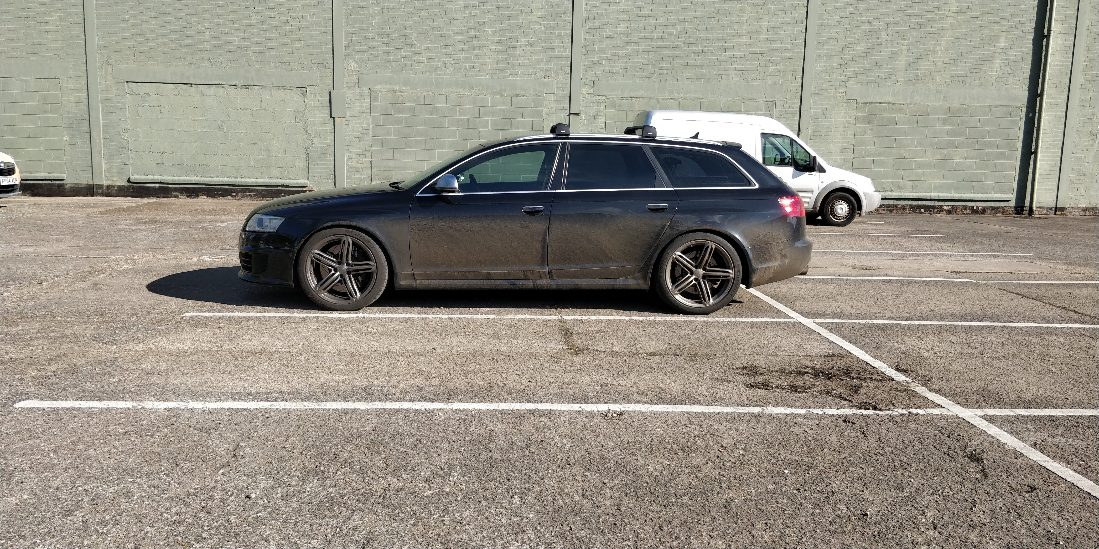

Just to chuck my 2 pennies worth in, I did have a snapped rear spring and have just gone for the KW height adjustable spring kit, paid about £725 for it but had to be shipped from germany so expect a 4-5 day lead time if ordering direct from KW UK.
With regards to height settings, as a rough guide to get a 1 finger gap between top of tyre and arch you need to max out the rear spring adjuster so the purple adjustment ring is flush with the bottom of the threaded part. For the front about 20mm between the bottom purple adjuster and the bottom of the threaded part.
Seems I have had a broken spring for a while so hard to get an accurate comparison but the car feels a lot tighter now

ignoring the state of the car, photo to show ride height of the KW setup. rears are wound up as much as possible, fronts have 20mm between the top and bottom of the adjustment collars
