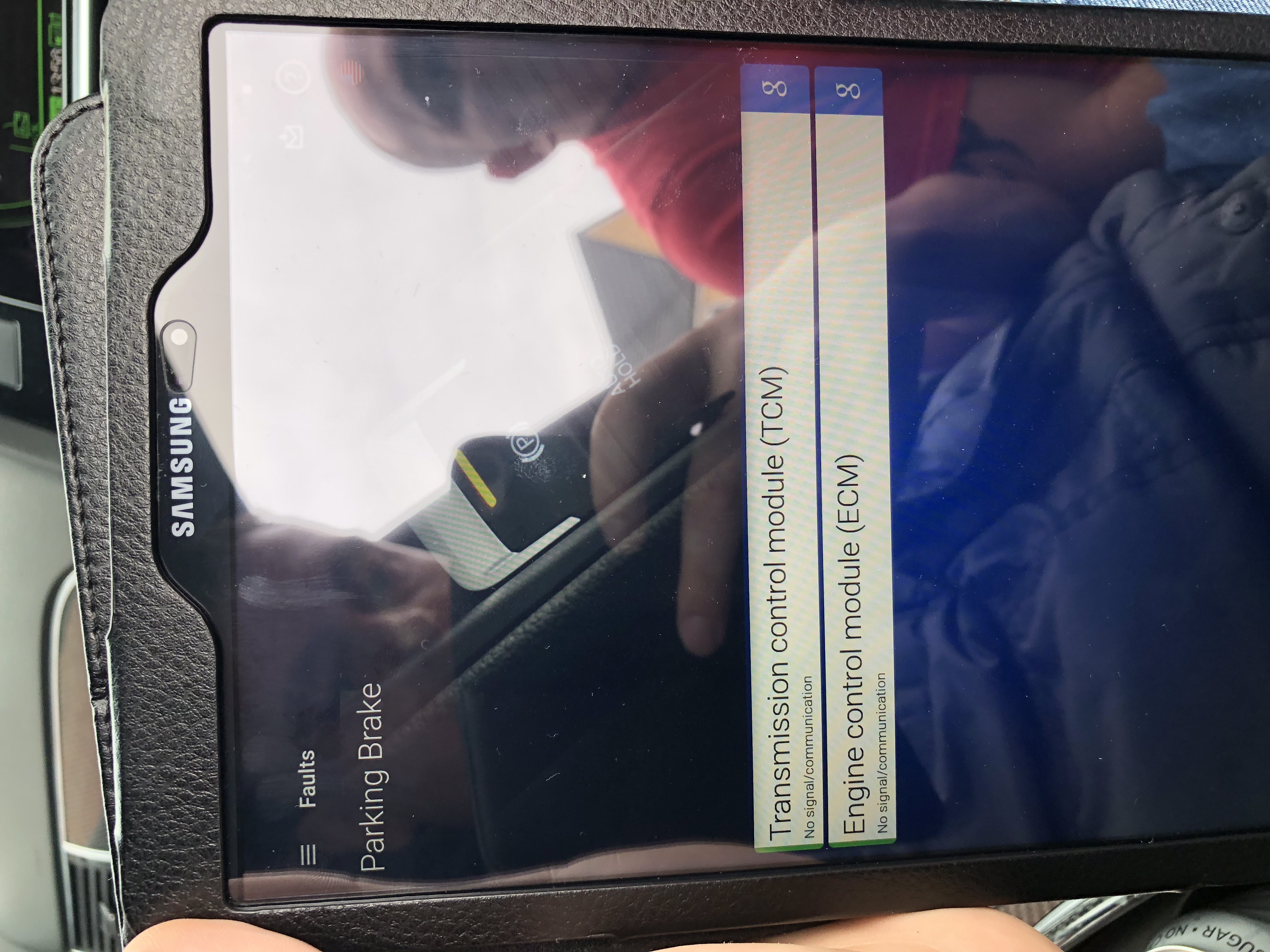

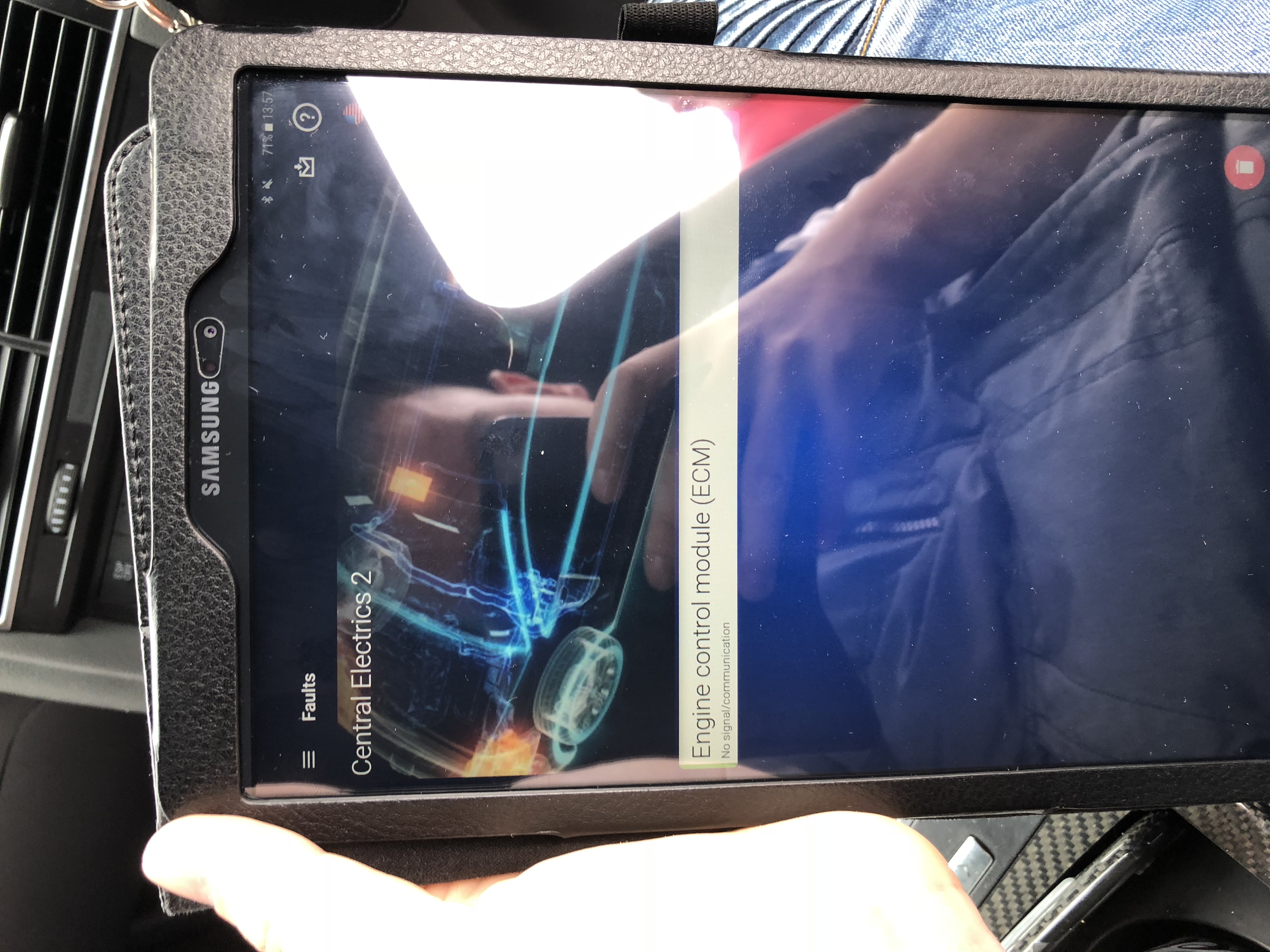

Post by Woodygo » Tue Aug 28, 2018 4:22 pm

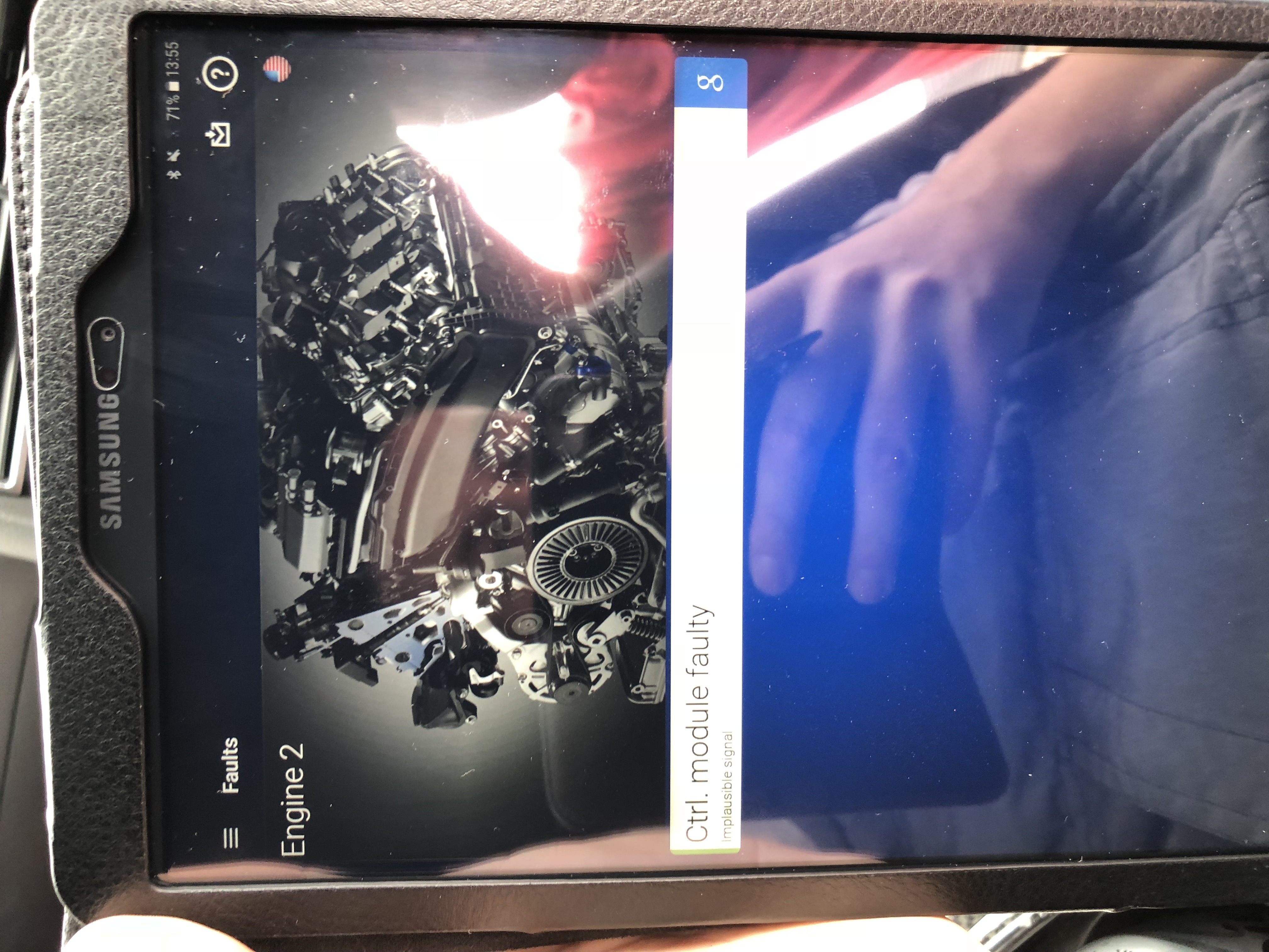

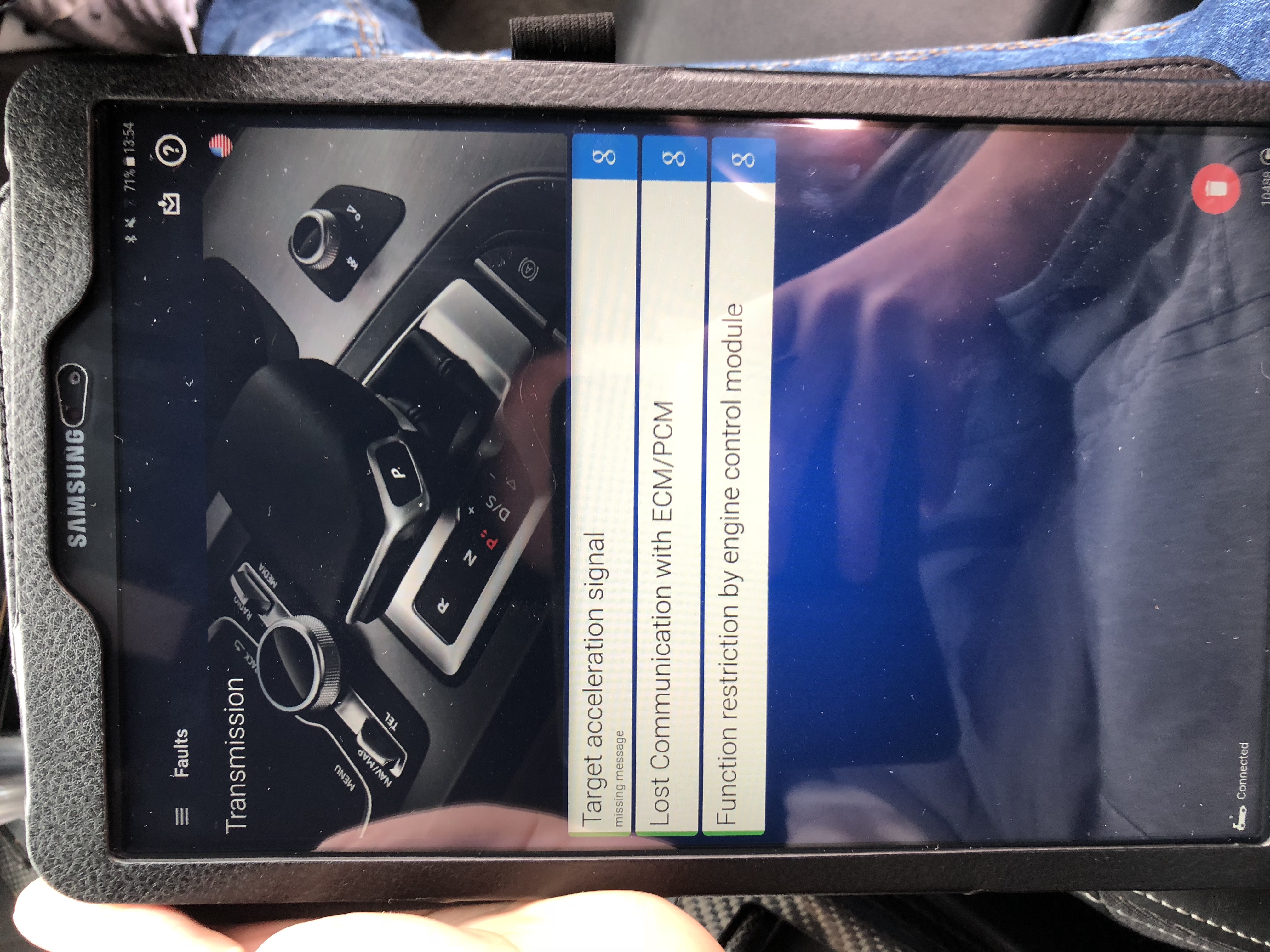

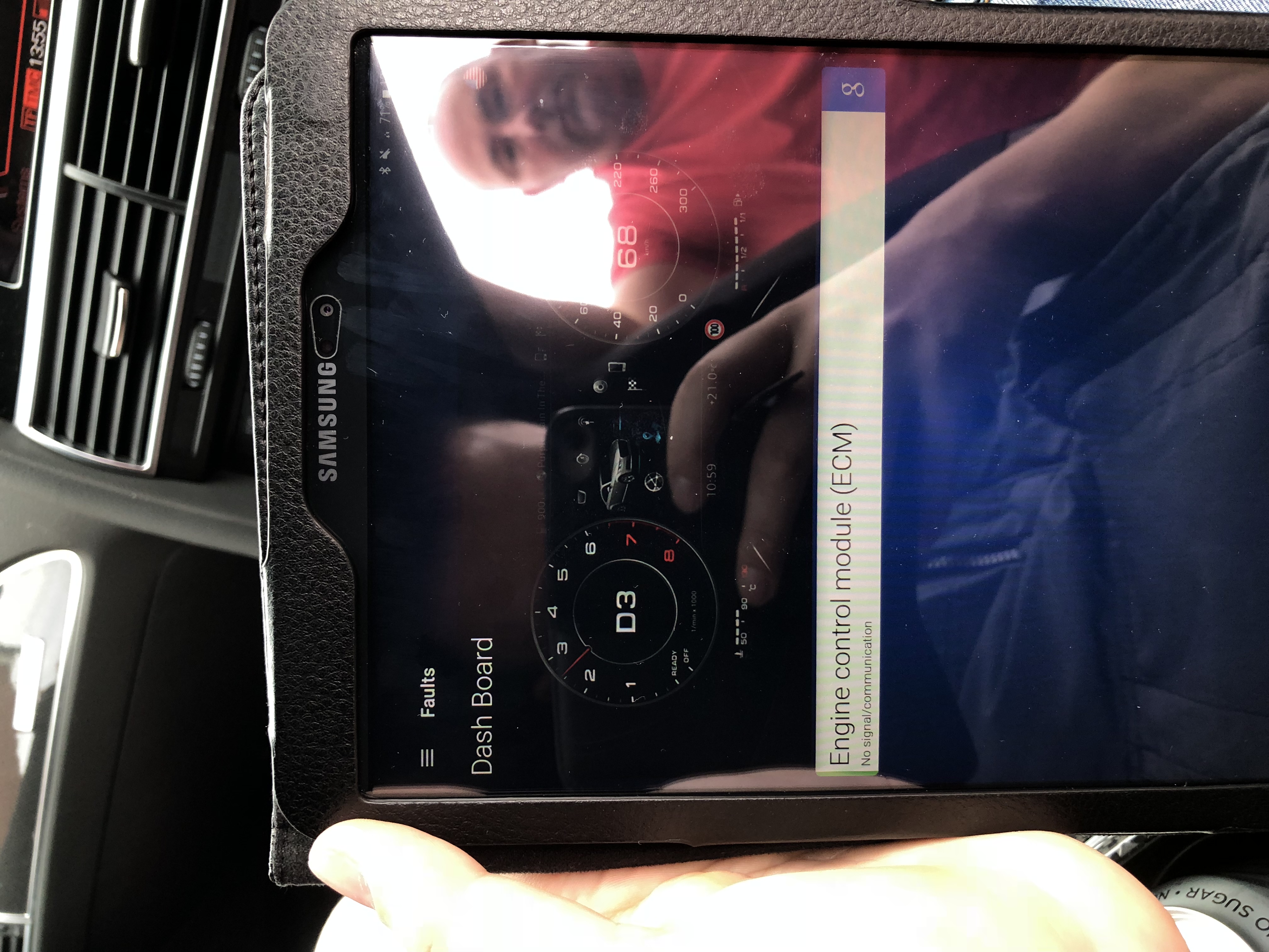

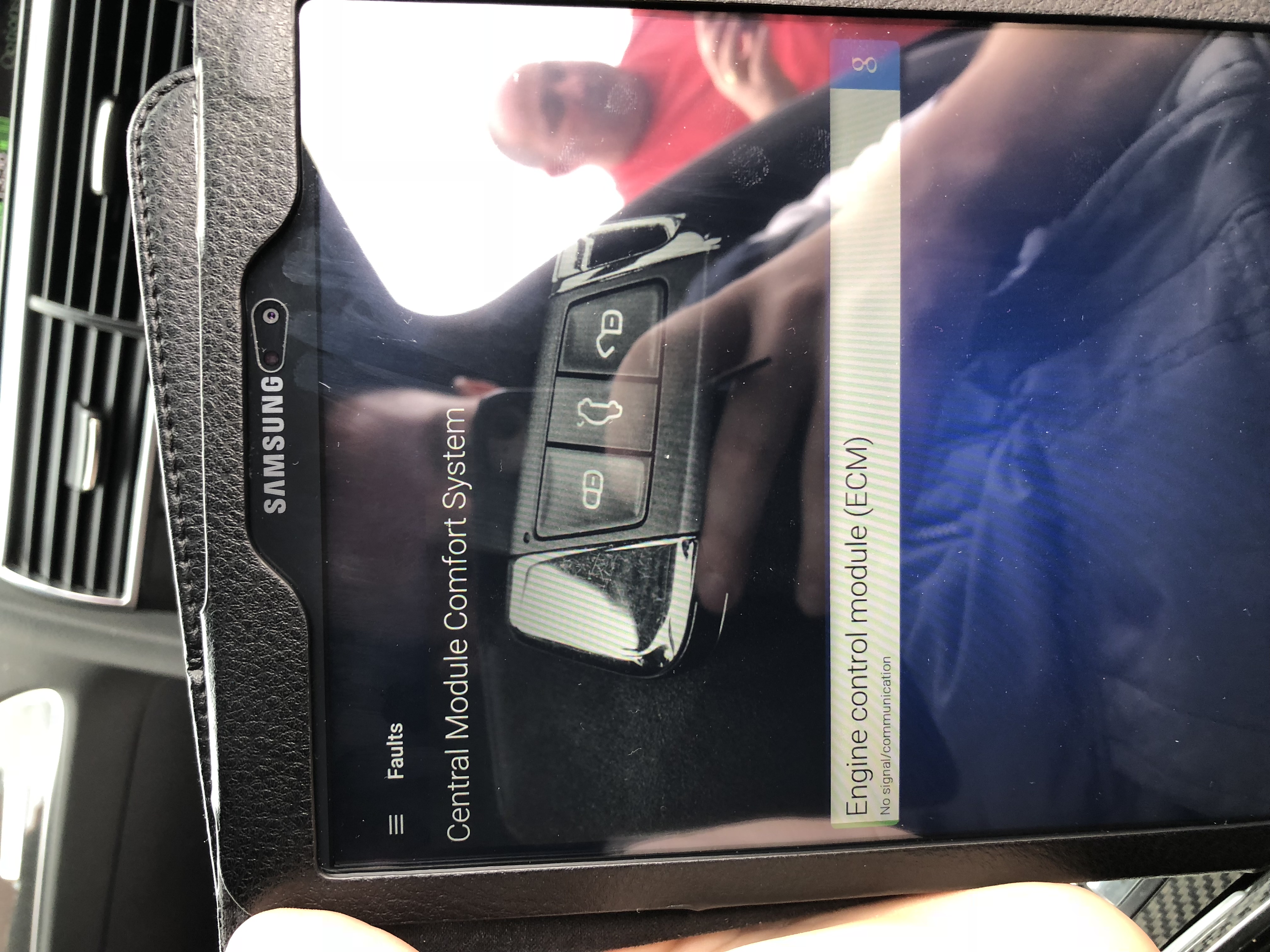

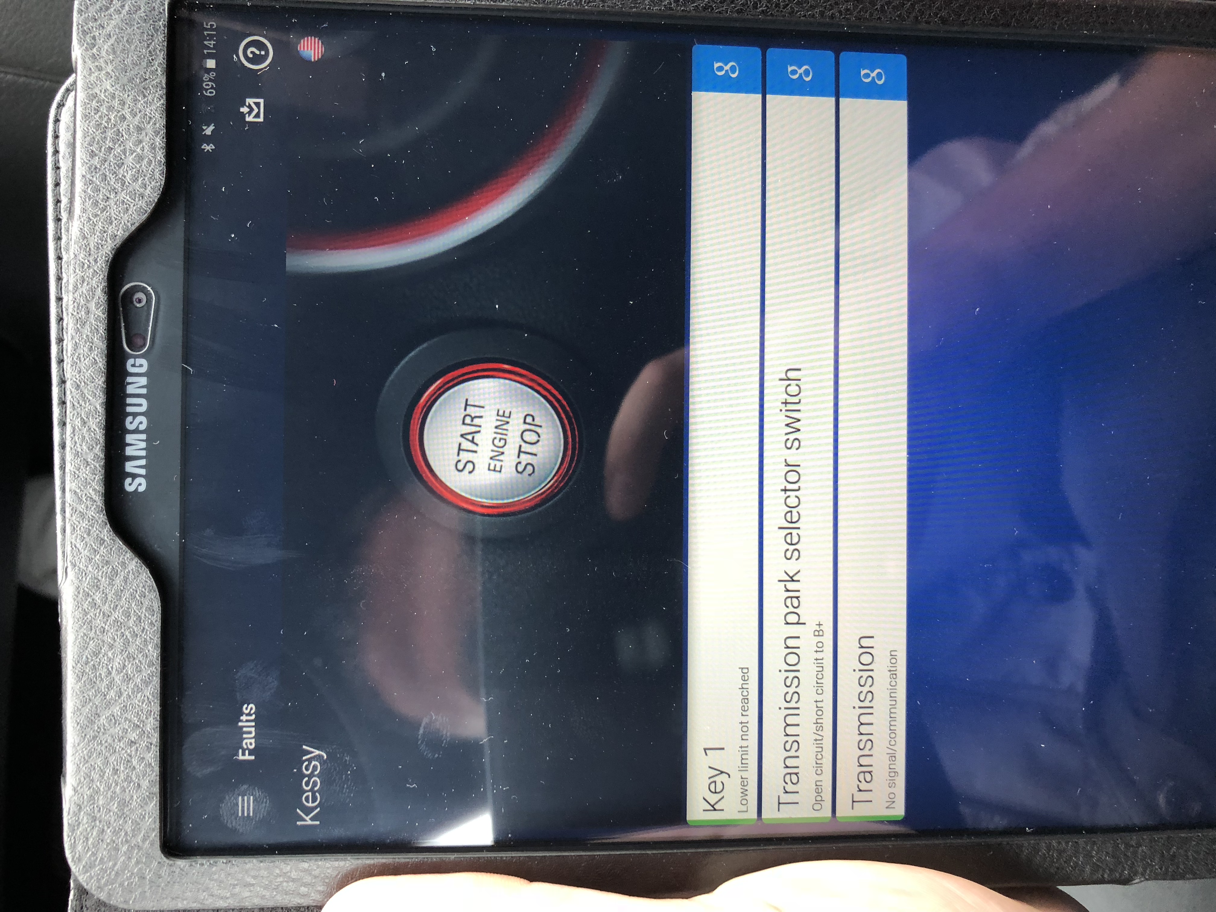

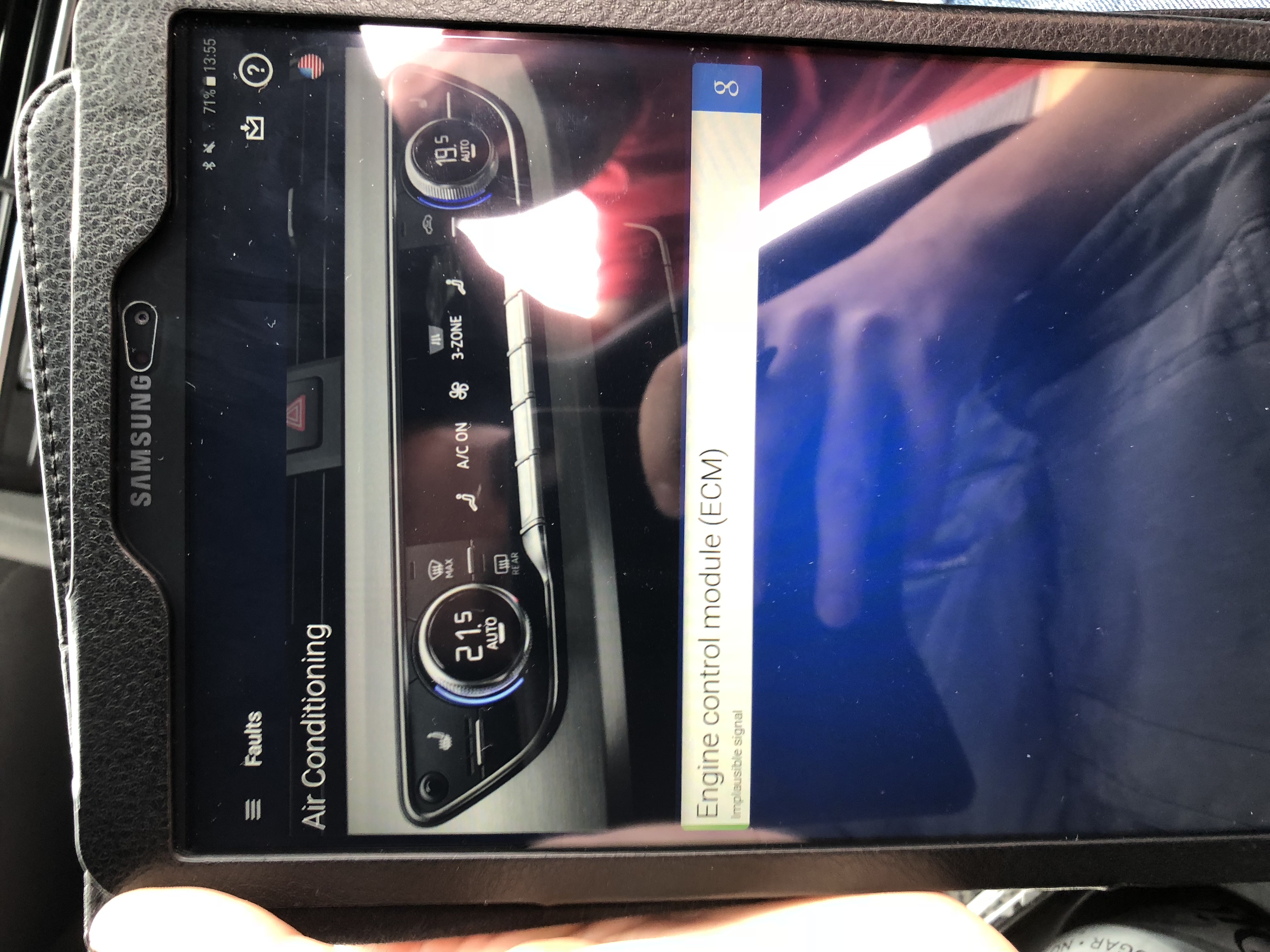

Well been on there scanner this is what came up clean it all up went for drive come back rescanned it all clear but I bet it’s back in the morning if anyone can help in anyway please let me no thanks steve ( o and there is no dtc store )🙈
