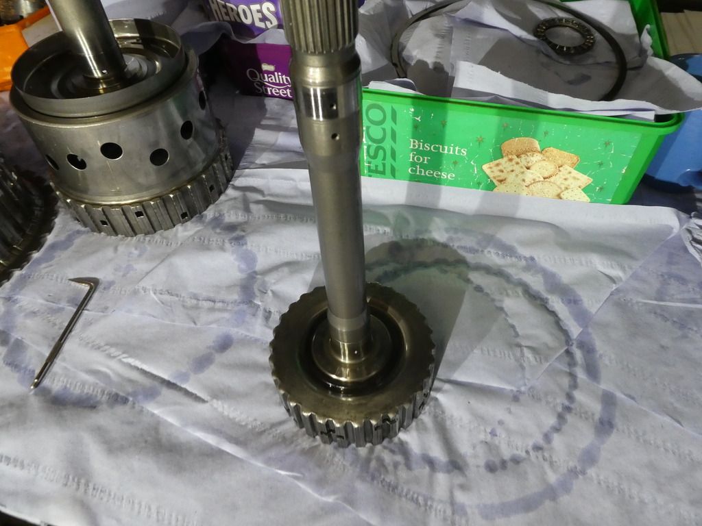

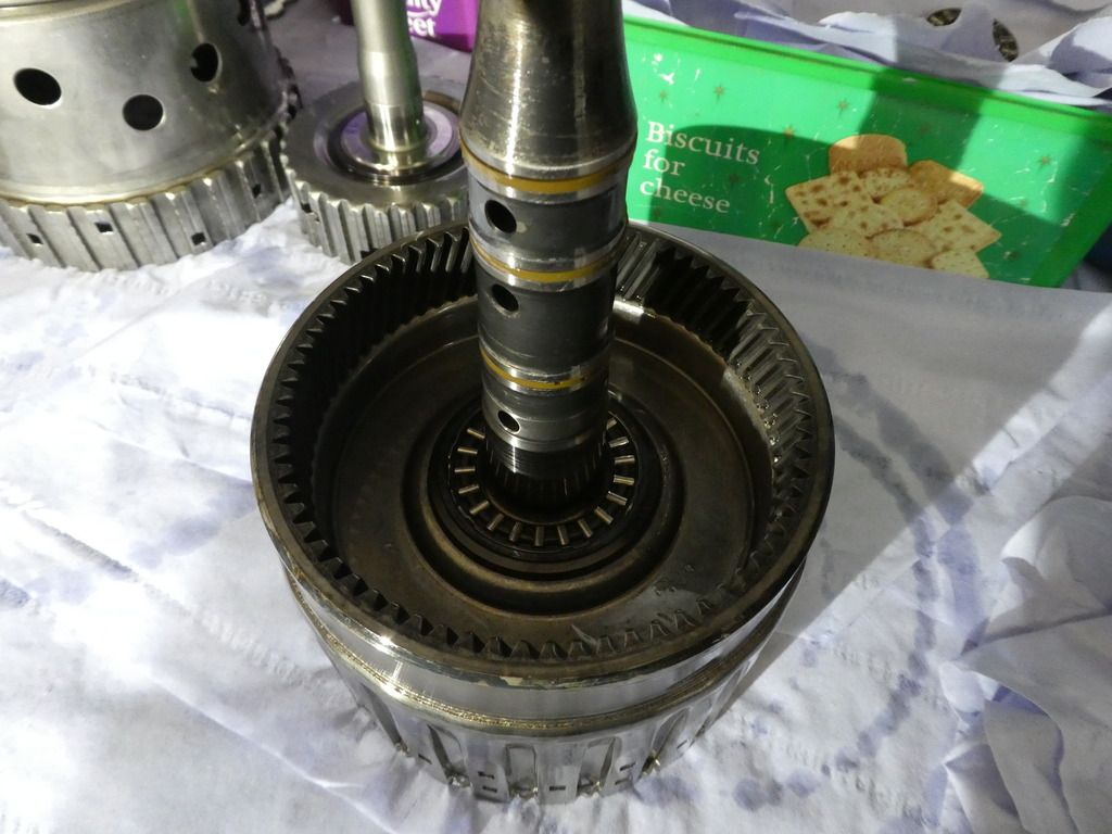

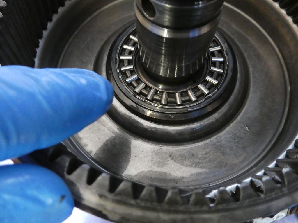

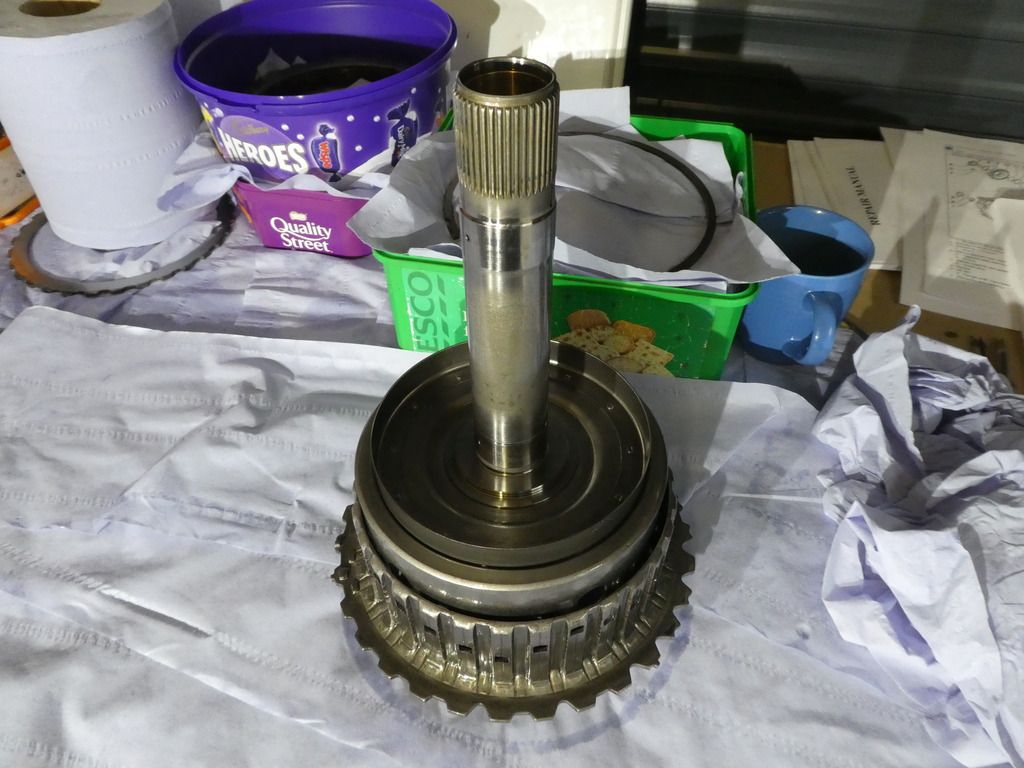

Invert the planetary gear and remove the lower needle bearing and inspect, again all good

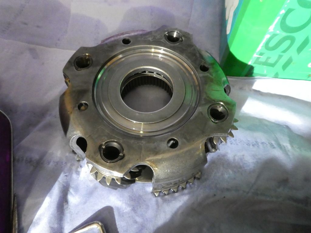

It looks like we are making progress but really we have only scratched the surface so far...

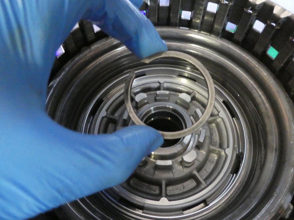

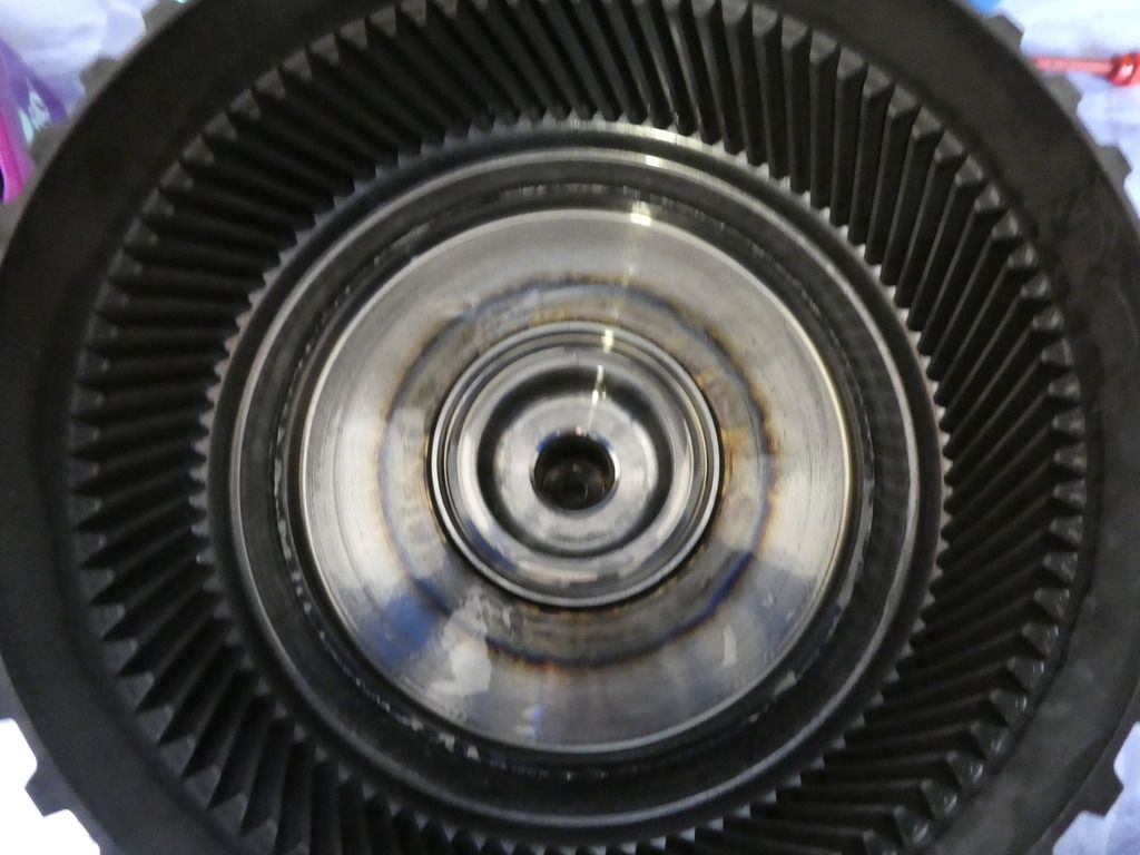

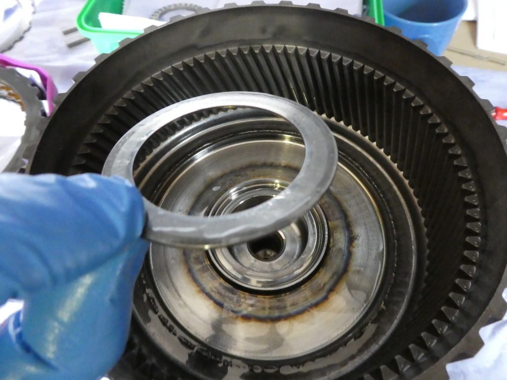

Remove the flat bearing washer from within the planetary annulus
Invert the annulus and remove the large circlip holding the output shaft to the annulus gear, you need only do this if you are a little OCD on cleanliness like me; they can be left together

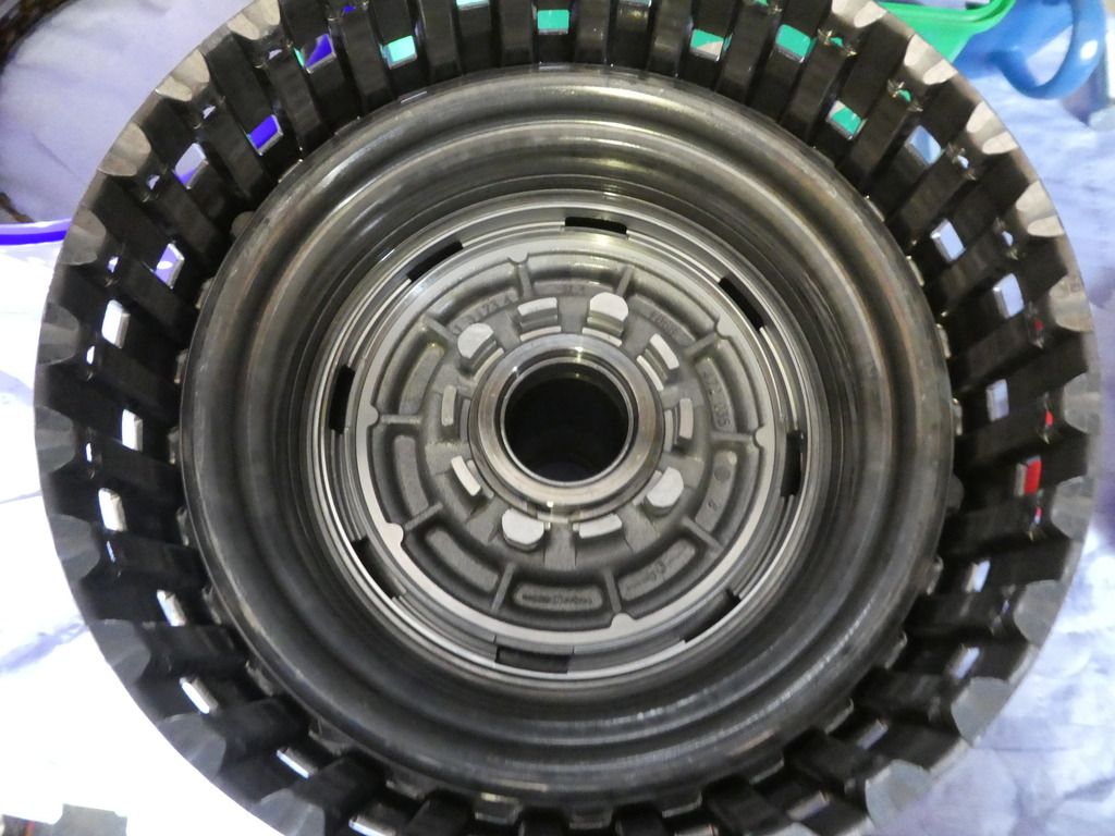

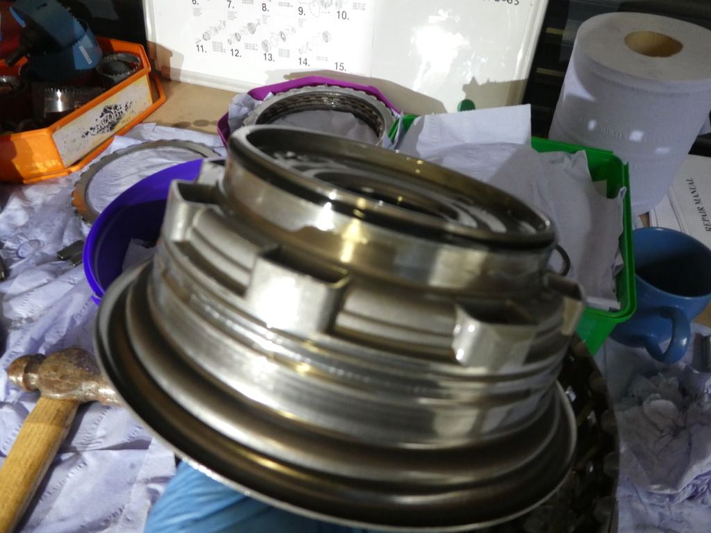

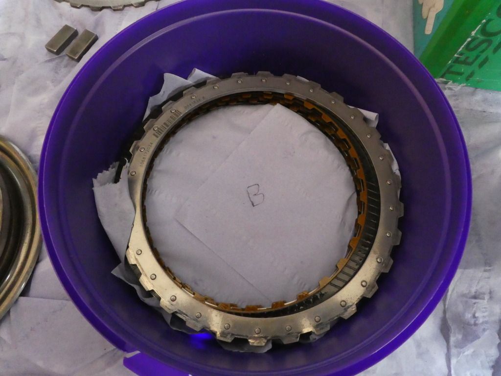

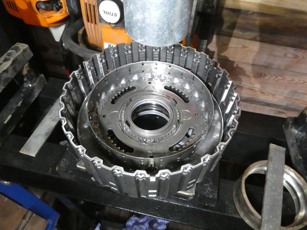

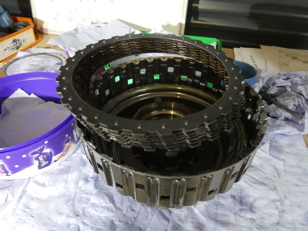

Now lets go back to clutch B and strip down the clutch pack itself

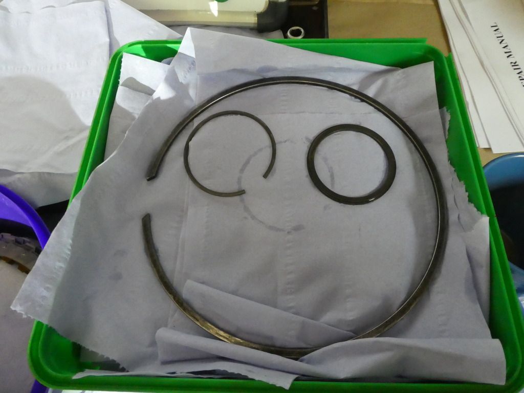

Starting with the circlip holding the clutch pack in place
Keep it together for later inspection

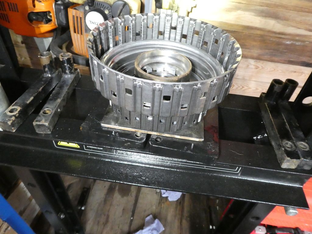

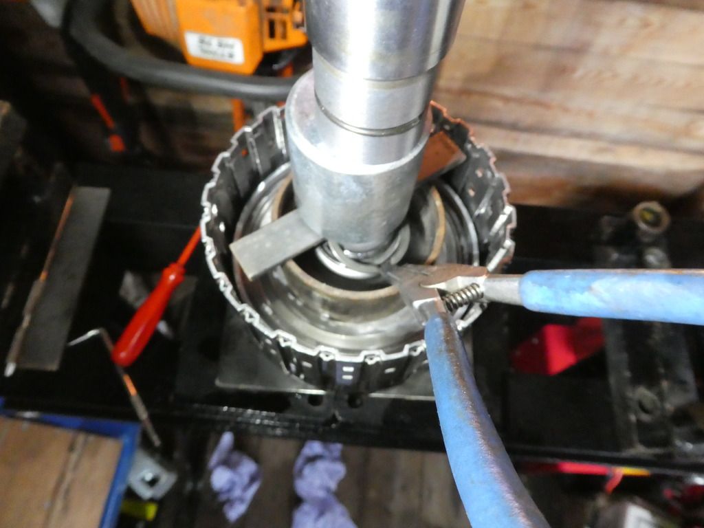

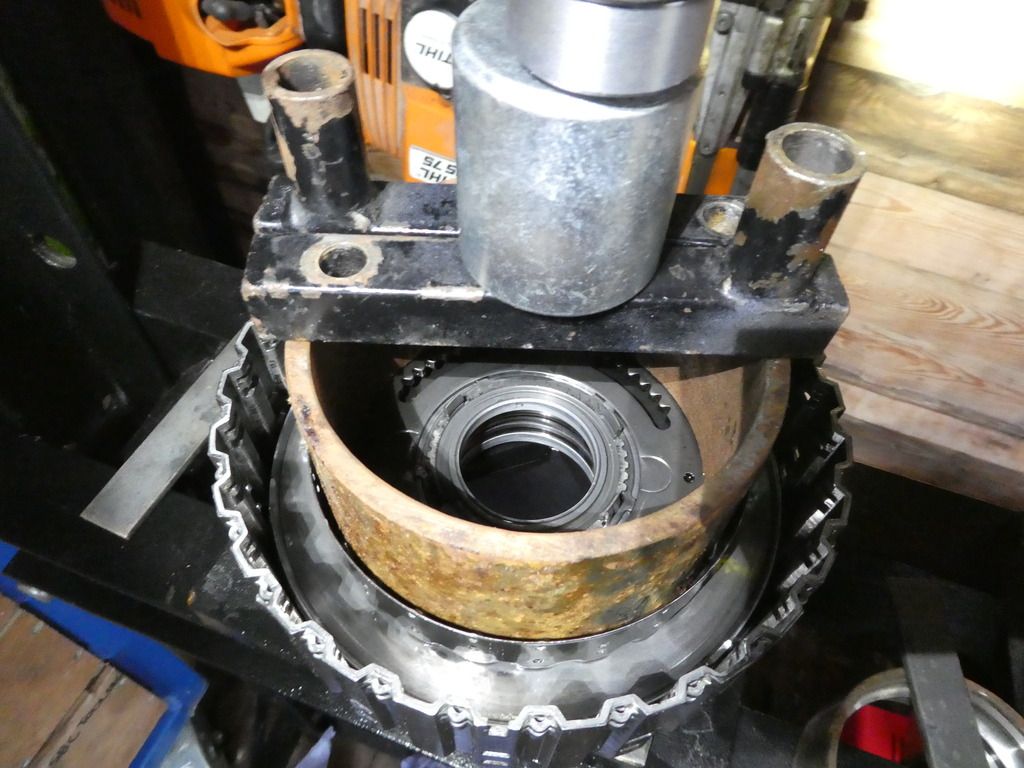

Now we need the use of the press for removal of the clutch piston retained by a stiff spring and circlip. ZF have some good tooling for use with the press, but as usual I dont believe in buying something we can be inventive with. Had I not run out of shield gas I would have made the 3 press tools (you will find lots of google images on these and they are easy to make with some flat bar and a welder) Given I dont expect to have do this job twice I didnt think it was worth it anyway. So I rooted through my scrap steel and came up with some odds and ends to do the same job - to press against the piston and spring so the circlip can be removed without any tension on it. In this case an old double bearing race from a 406 Peugeot fits nicely...
Oh and ZF recommend an arbour not a hydraulic press (presumably so you can control the force and not stress the components), but the hydraulic press works fine if you are careful
Just compress the spring sufficient to remove the clip, no more than necessary

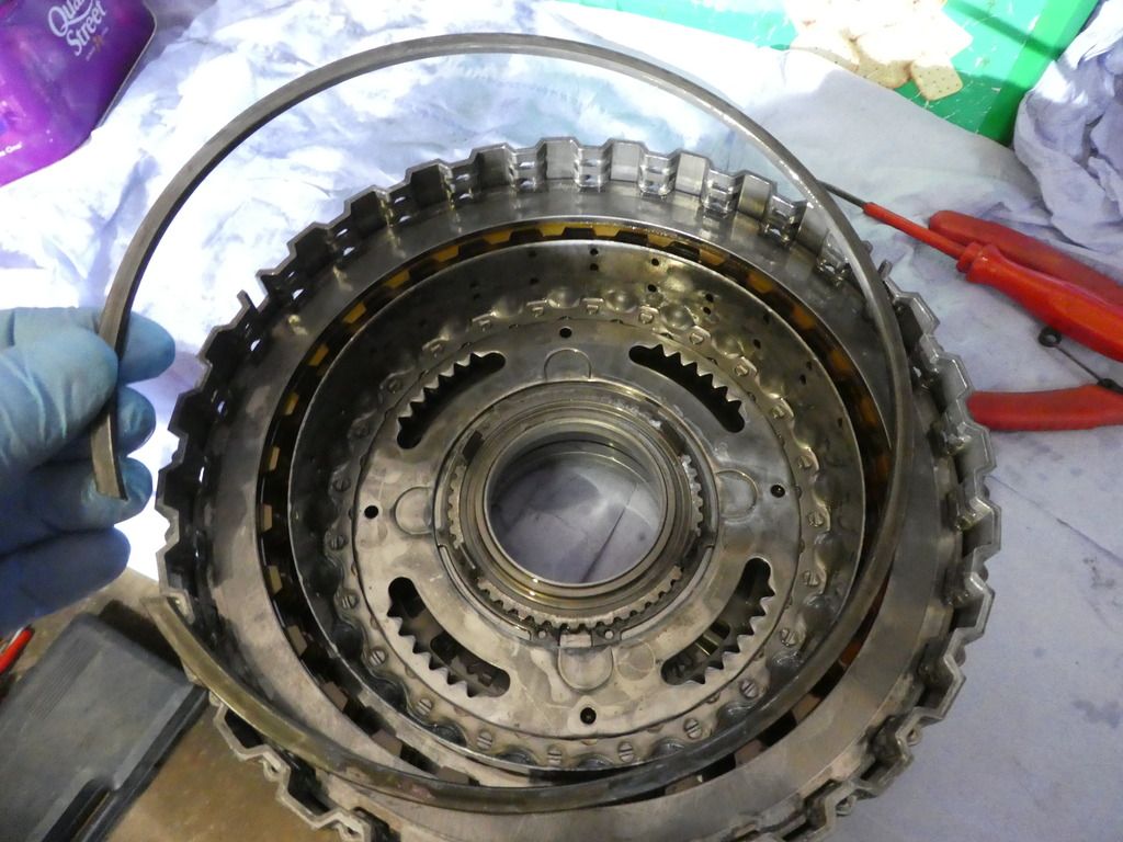

ATinOf
Posts: 444
Joined: Fri Jul 06, 2018 7:32 pm
Location: Cheshire
Re: Gearbox Teardown & Refurbish - 6HP28A61
Post by ATinOf » Mon Sep 03, 2018 1:23 pm

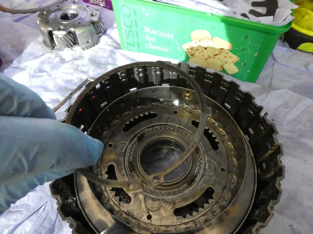

Now remove the circlip
And the retaining washer
And the spring of course

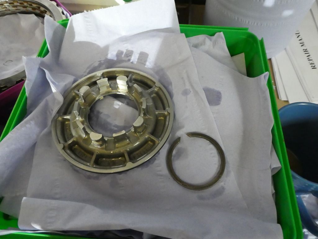

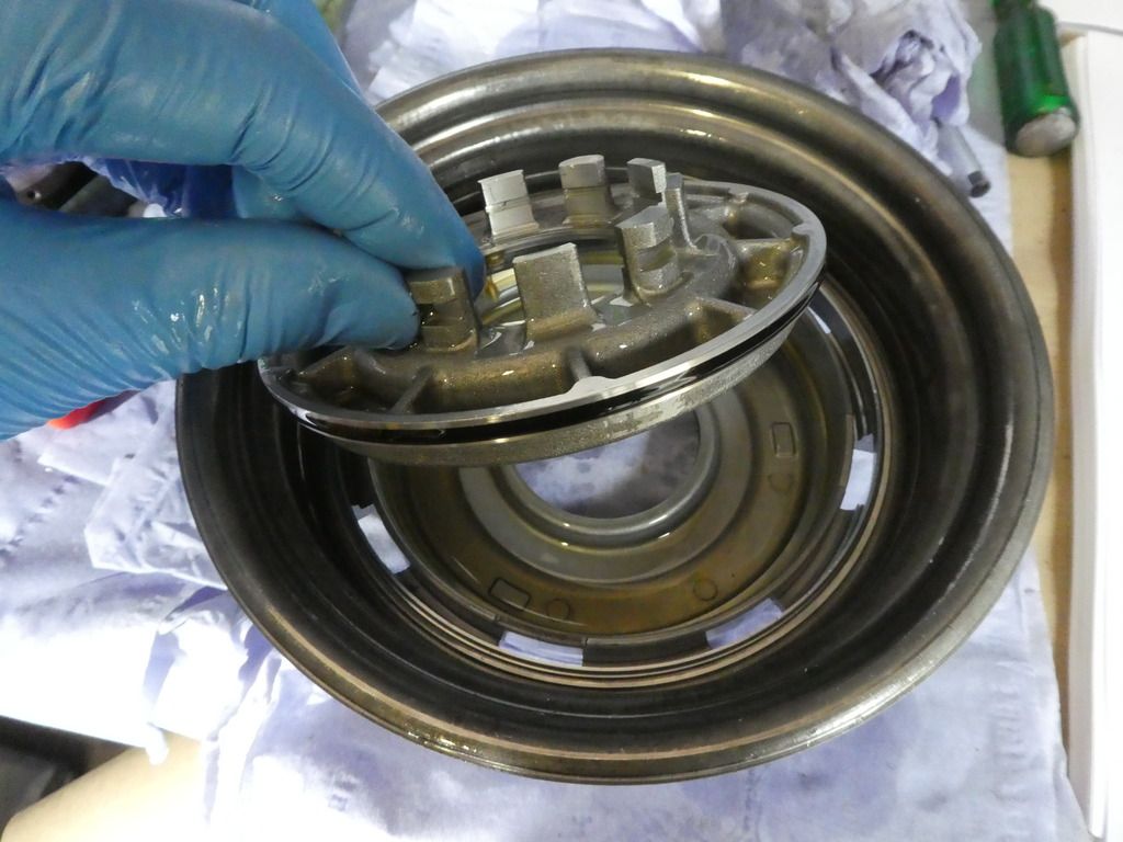

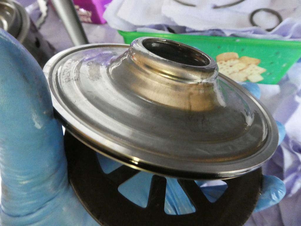

That leaves us with the piston itself and the retaining plate
Remove the circlip against the retaining plate
And pull, in my case the piston came first, with the retaining plate; depending what you pull on you may get a different result, but the bottom line is you need to pull out the piston and release the retaining plate from the piston to get to all 3 of the O-ring seals
2 of the seals sit in the piston

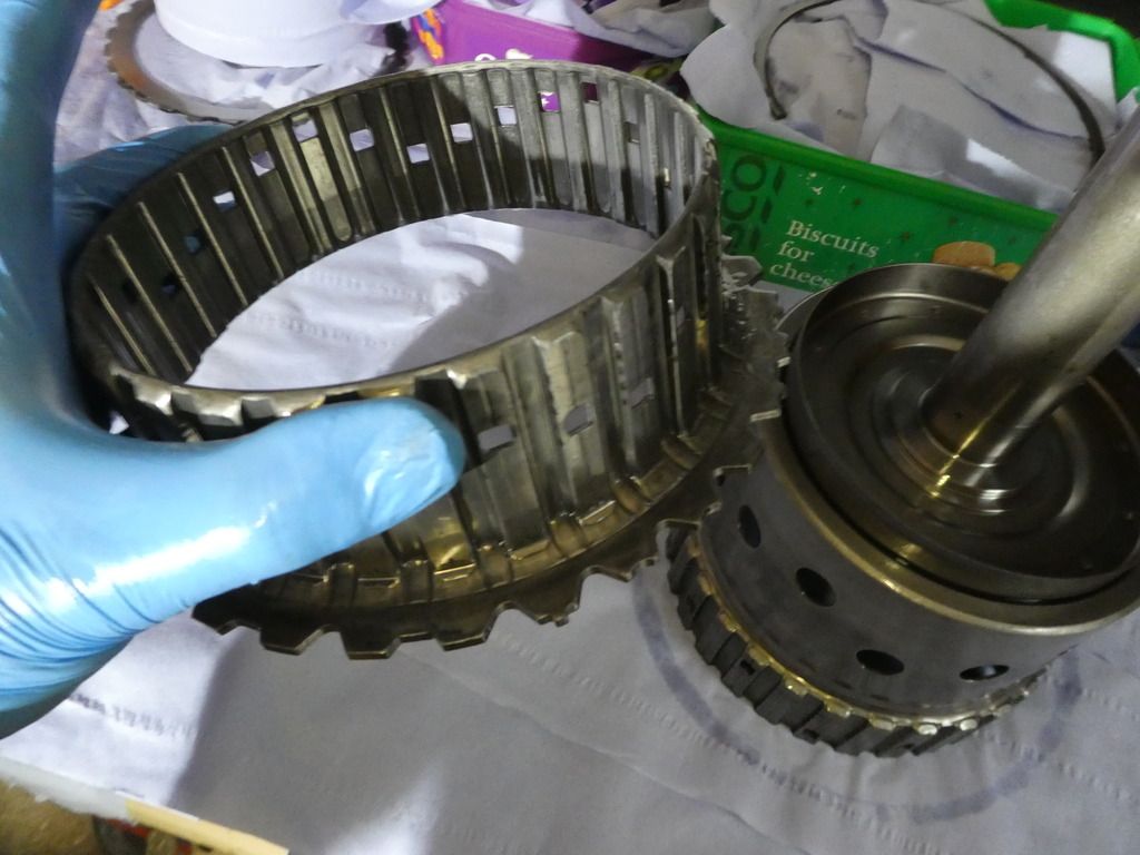

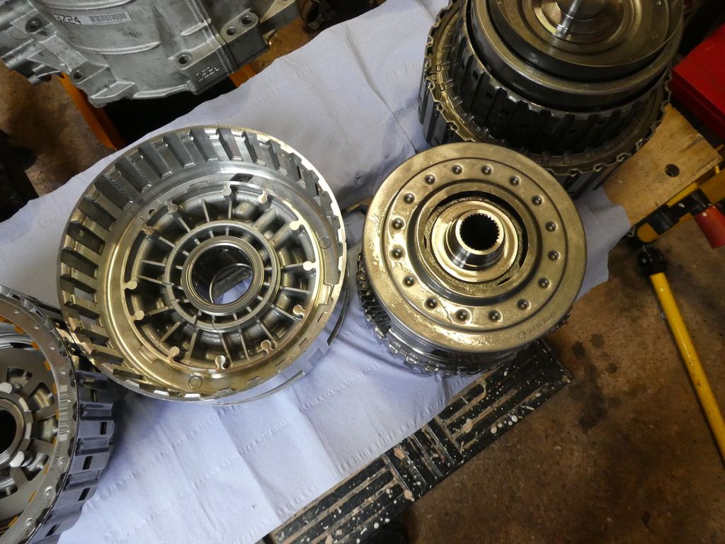

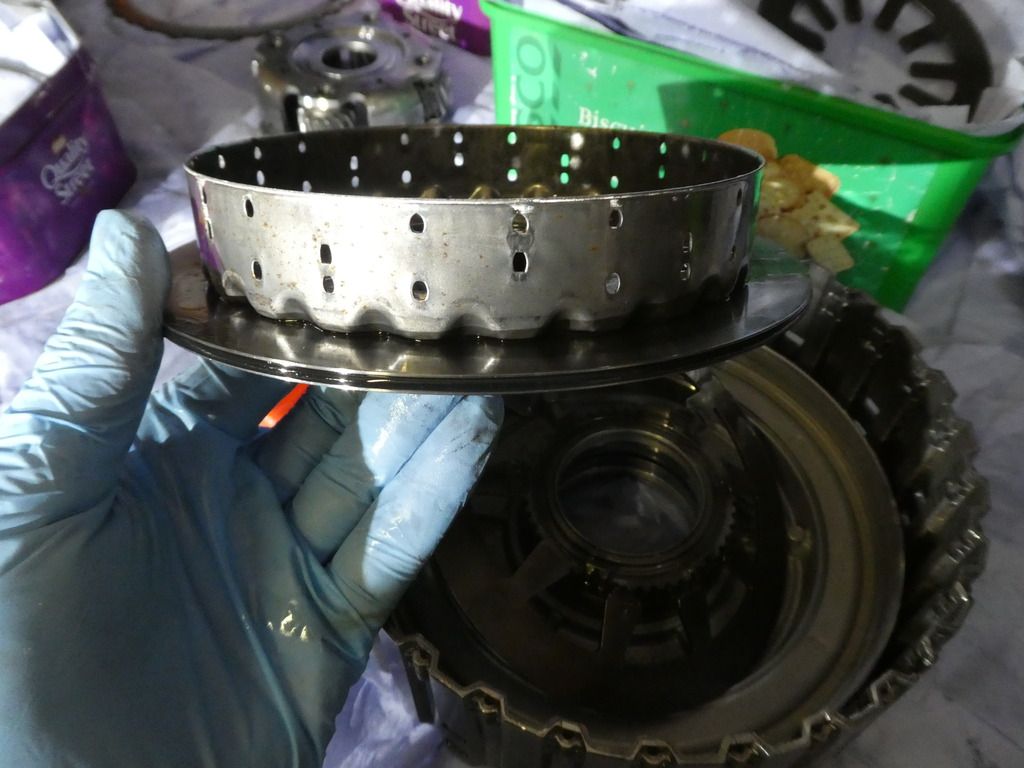

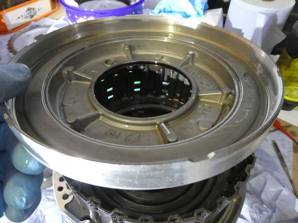

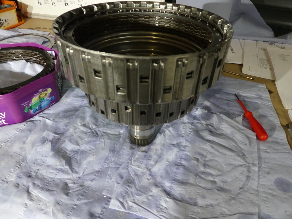

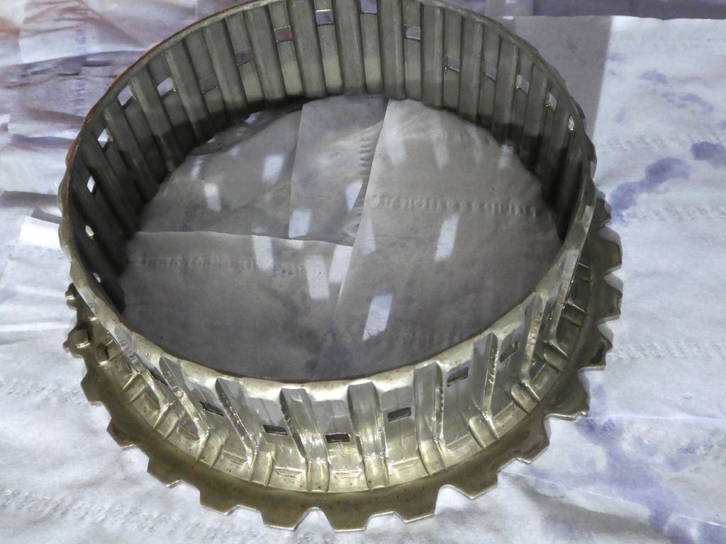

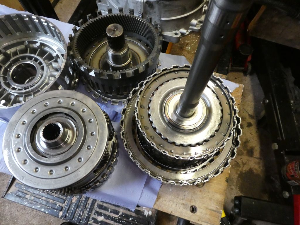

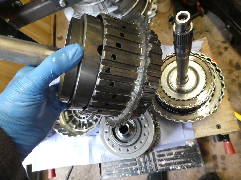

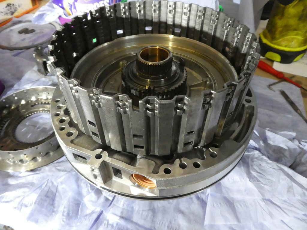

Back to 'body II' (Clutches A and E) which is still sitting upside down in the workbench with the input shaft pointing downwards, remove the circlip retaining the rear inner plate carrier
And remove the rear inner plate carrier
On the bench withdraw the inner plate carrier B

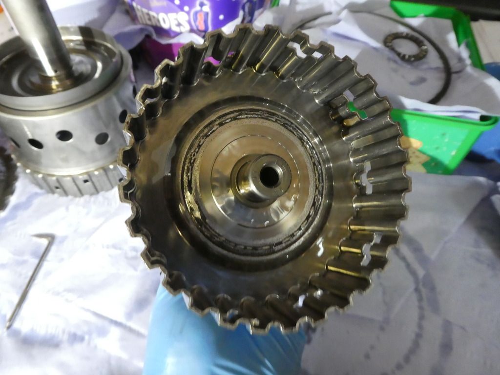

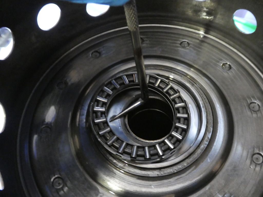

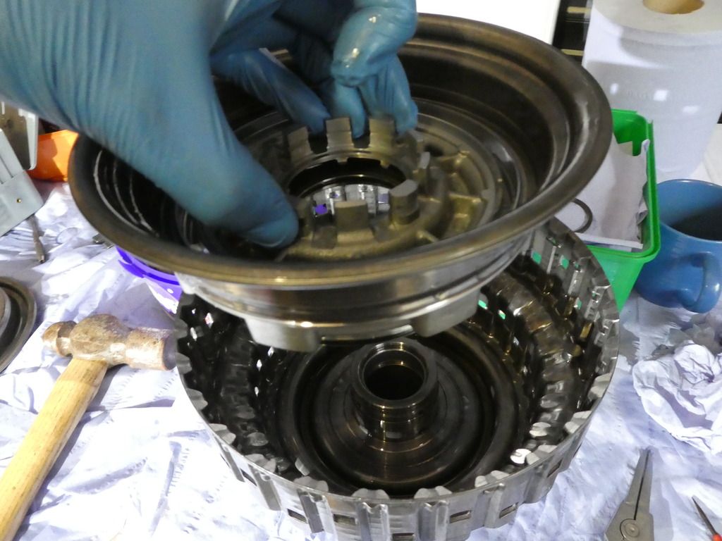

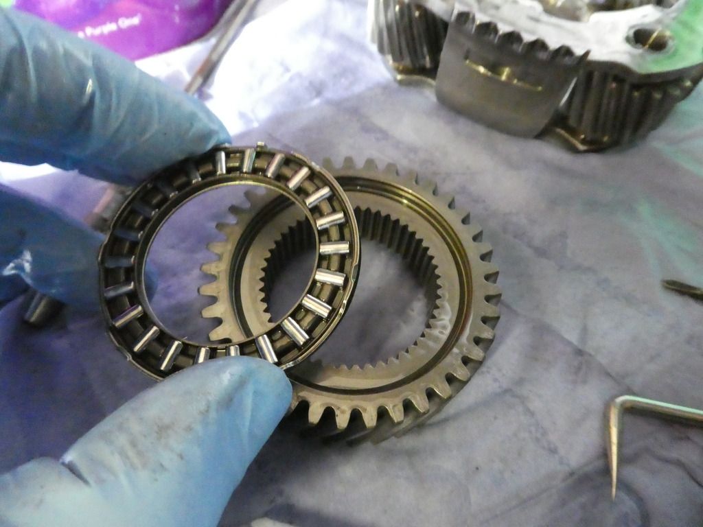

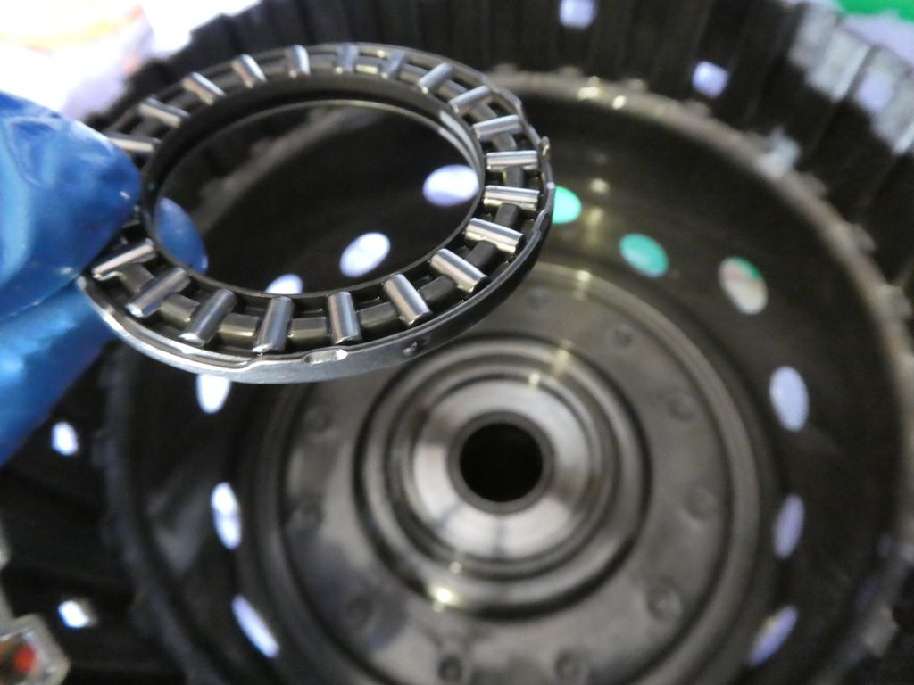

Leaving us with the inner plate carrier A
Turn this over and remove the needle bearing and inspect it, all good

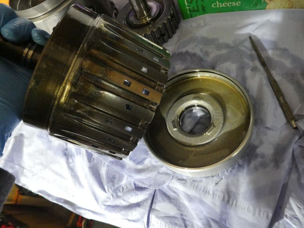

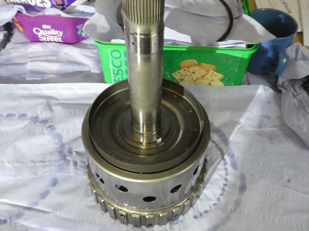

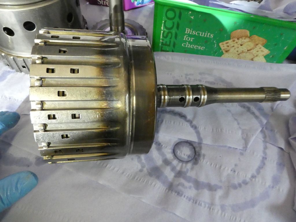

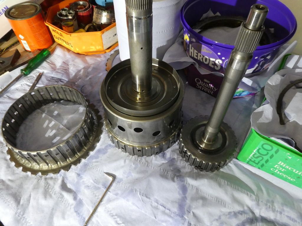

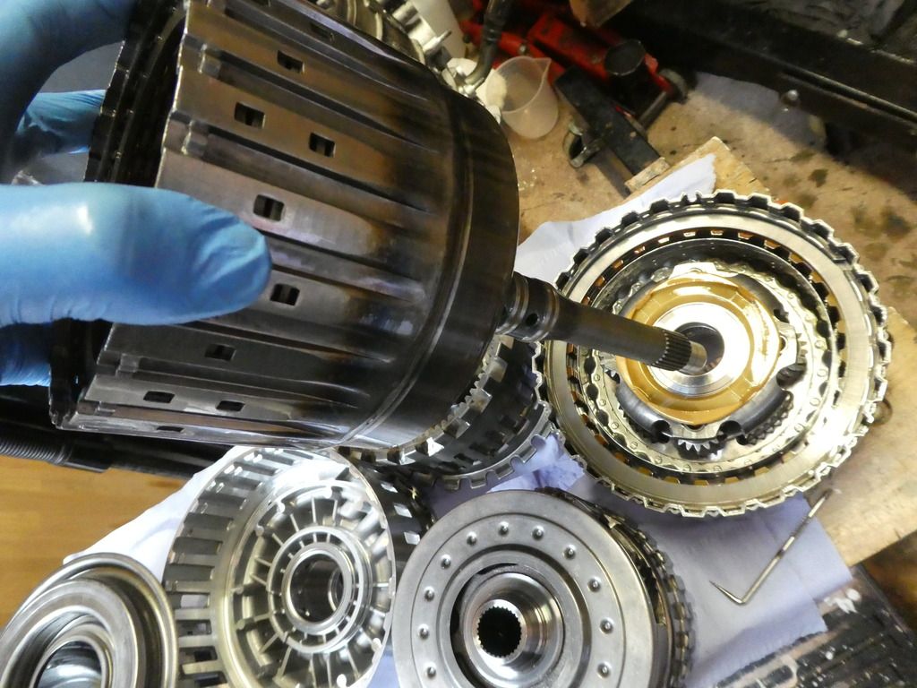

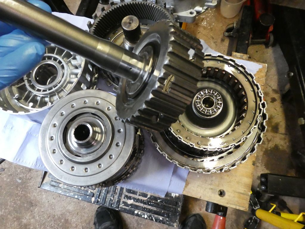

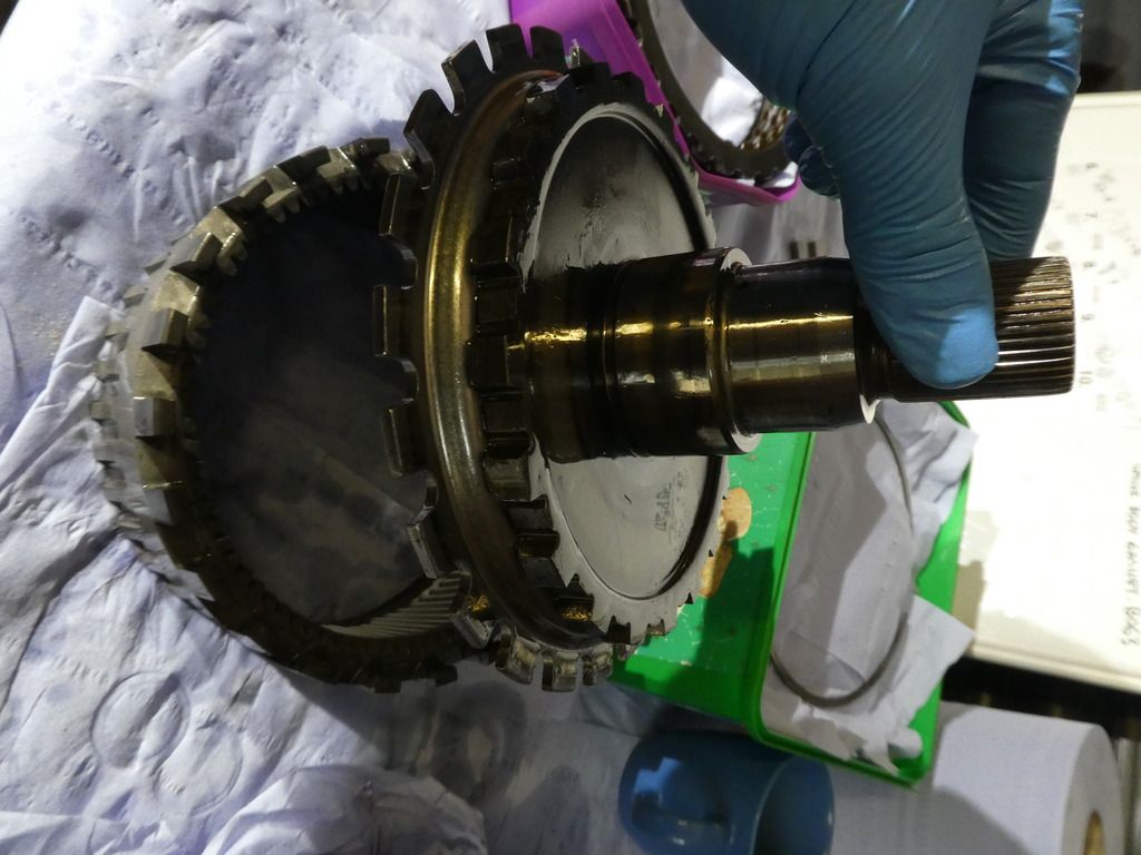

Back to the 'body II' assembly and withdraw the inner plate carrier E with its intermediate shaft
Inspect the bearing and seal faces visually and with your nail, no problems here

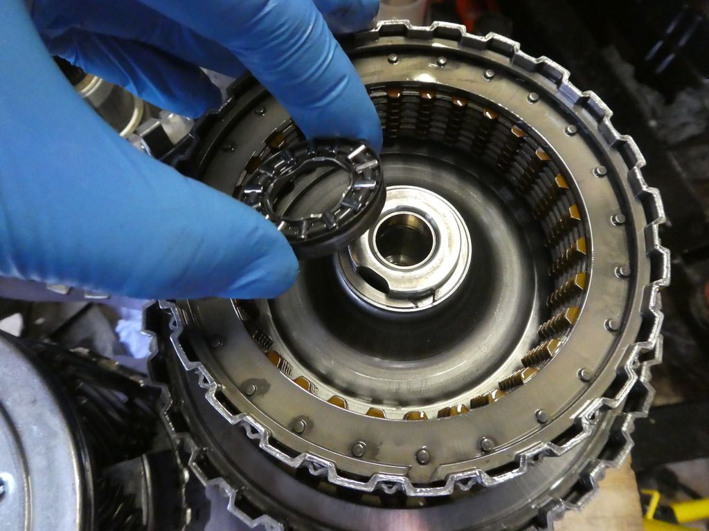

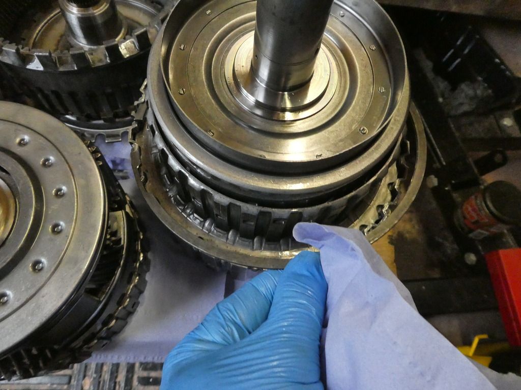

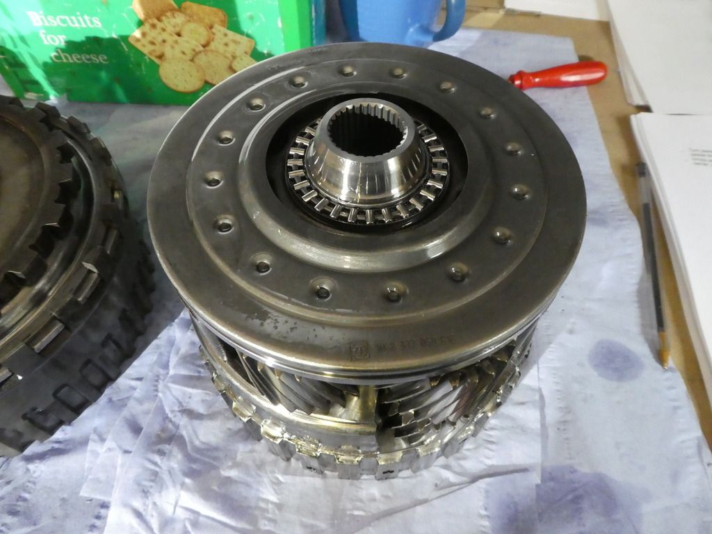

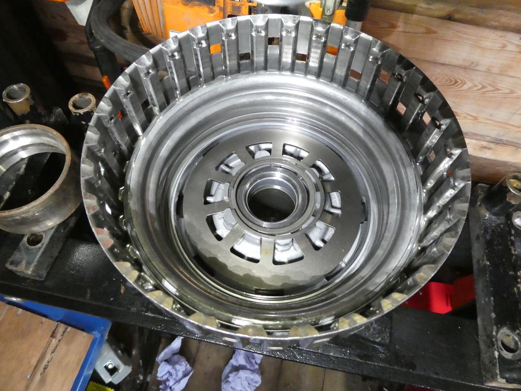

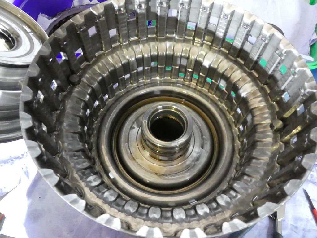

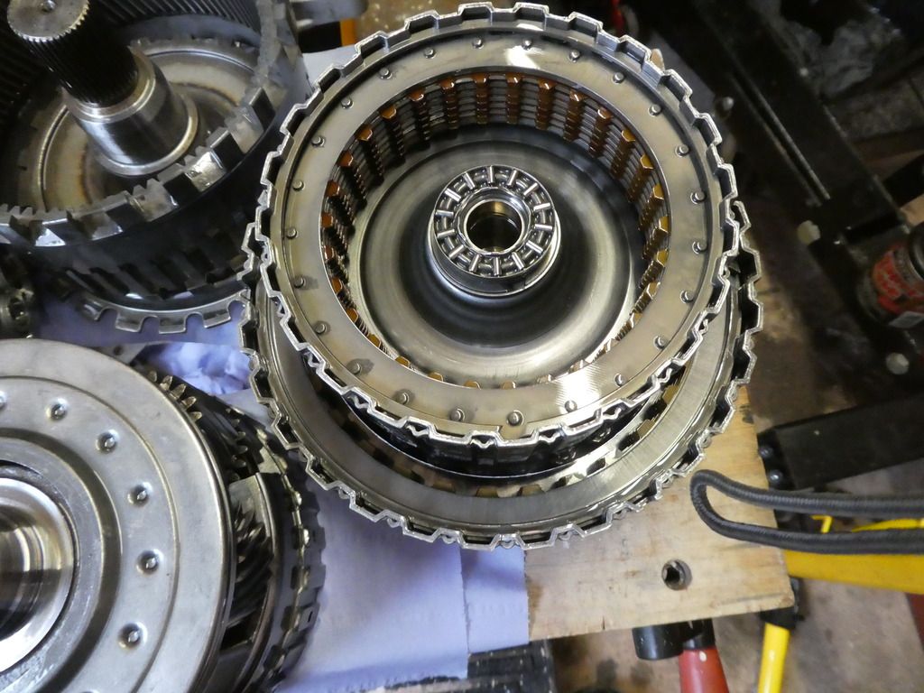

Now we can actually get to the clutch E pack

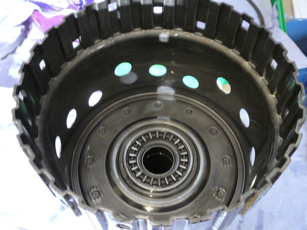

Unclip the needle bearing and inspect, no surprises here either
Withdraw clutch E from clutch A
And invert it on the bench
Remove and Inspect the needle bearing, in my case this was particularly stubborn and would not unclip; given it passed the inspection I decided not to mawl it off (and damage it in the process) and to leave it in situ

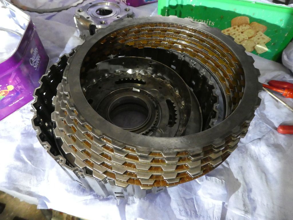

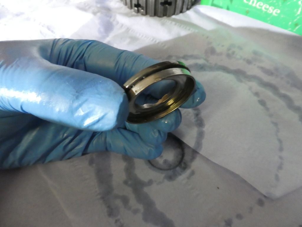

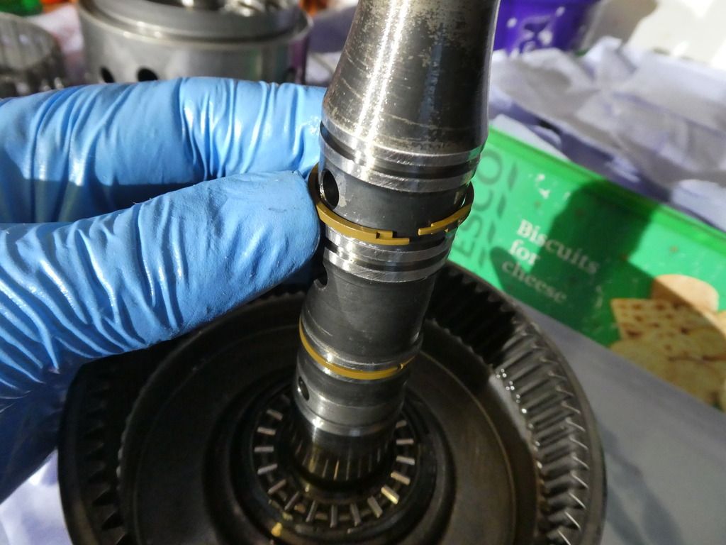

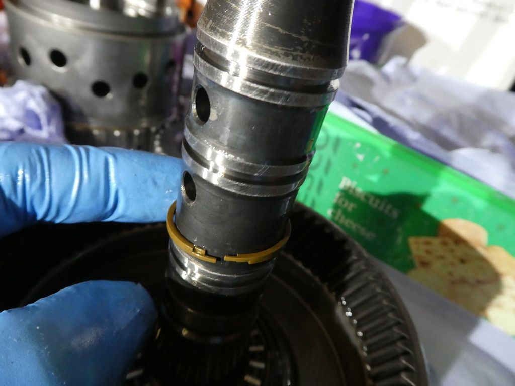

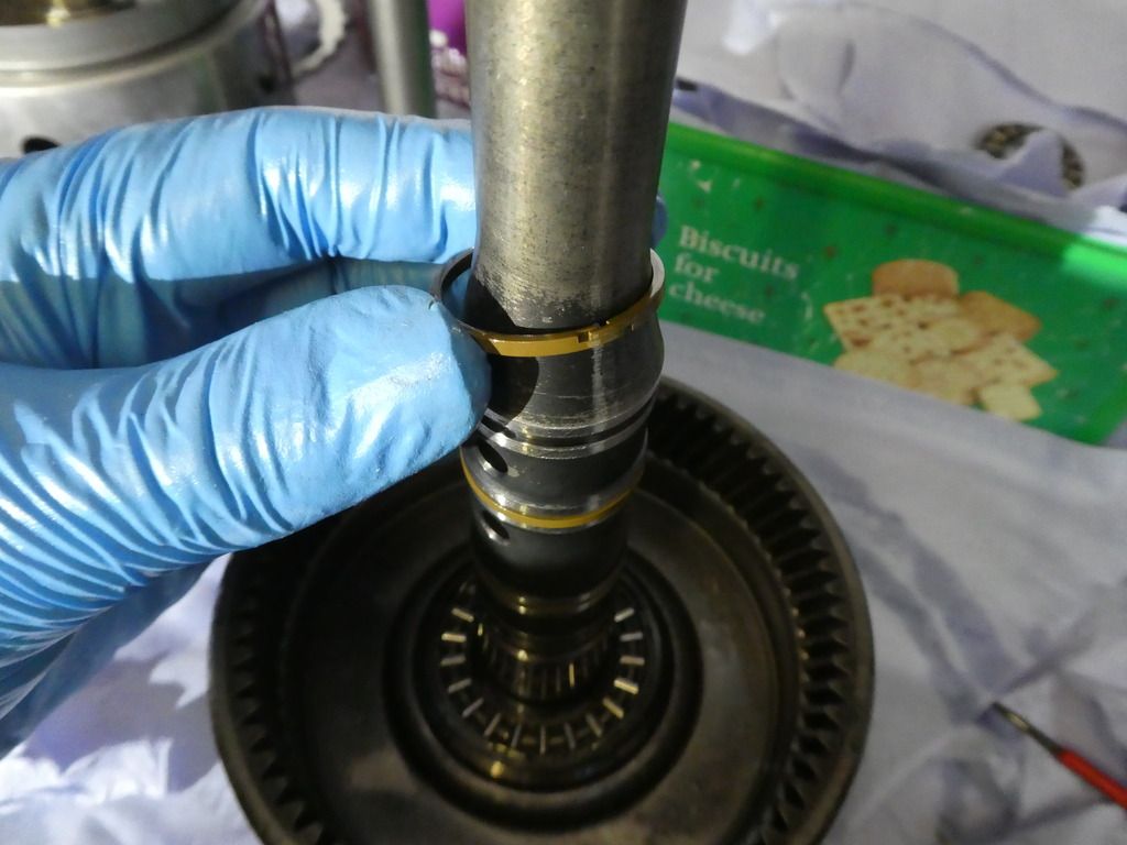

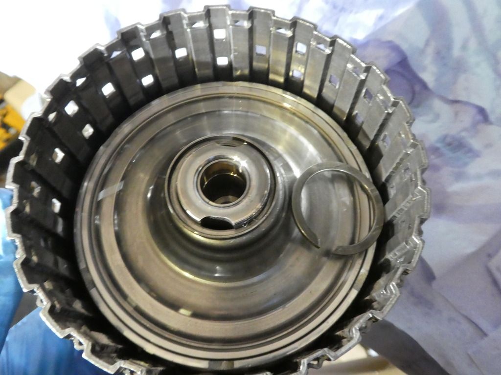

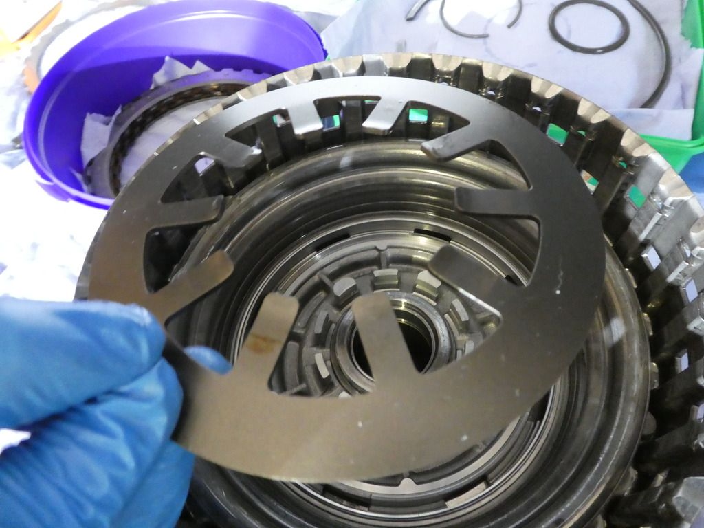

Remove the 3 Rectangular section seals

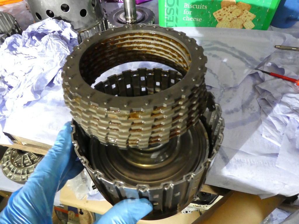

Flip over clutch E and remove the circlip

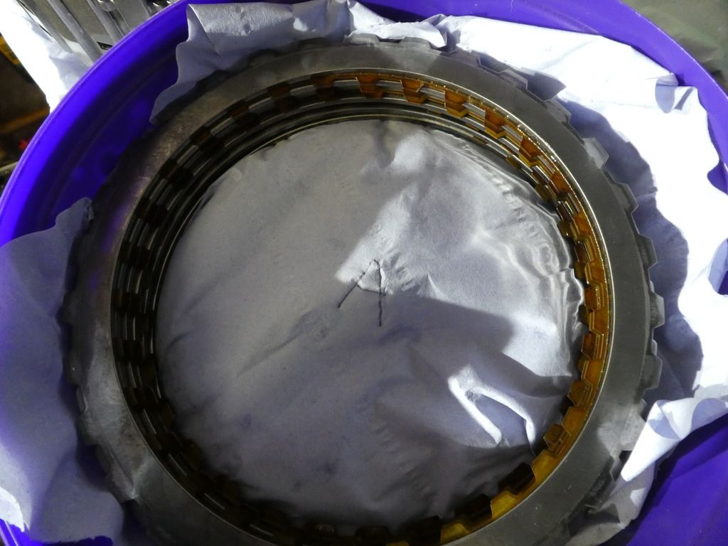

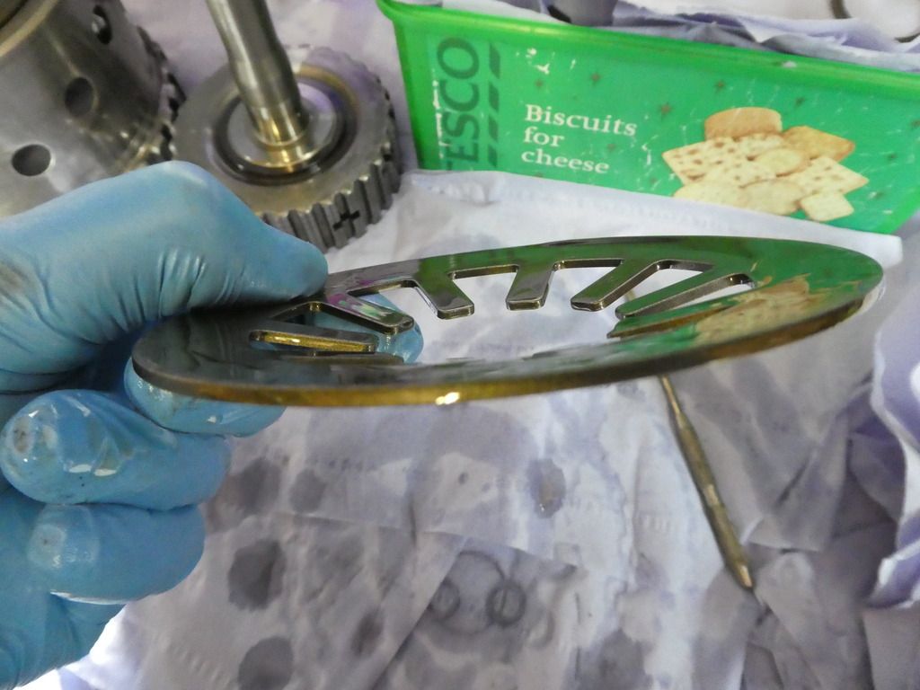

Remove the frictions and steels

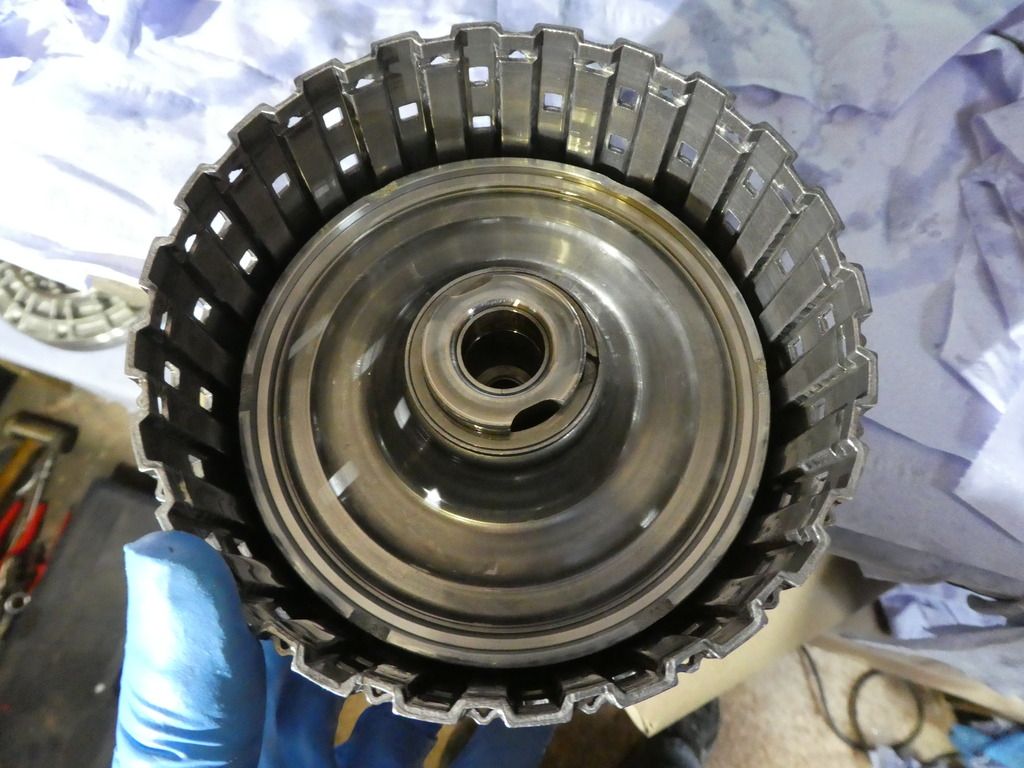

A gentle tap upside down on the bench and the piston will fall out, or you may have to persuade it a little
If it simply wont play ball you can apply air pressure to one of the oil bores on the shaft whilst covering the others to blow it out

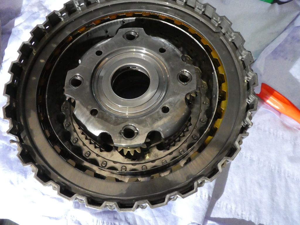

Now onto the last part of 'body II', Clutch A

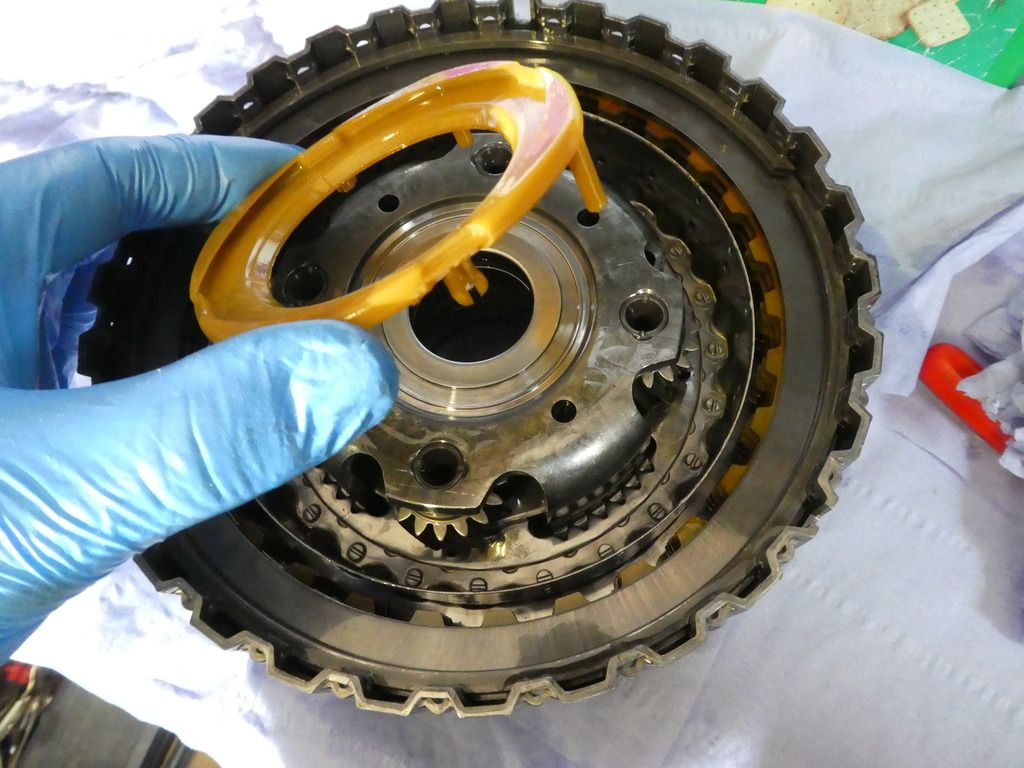

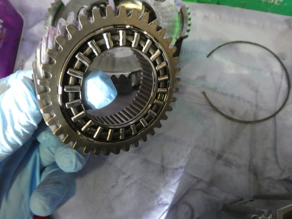

Unclip the oil collector

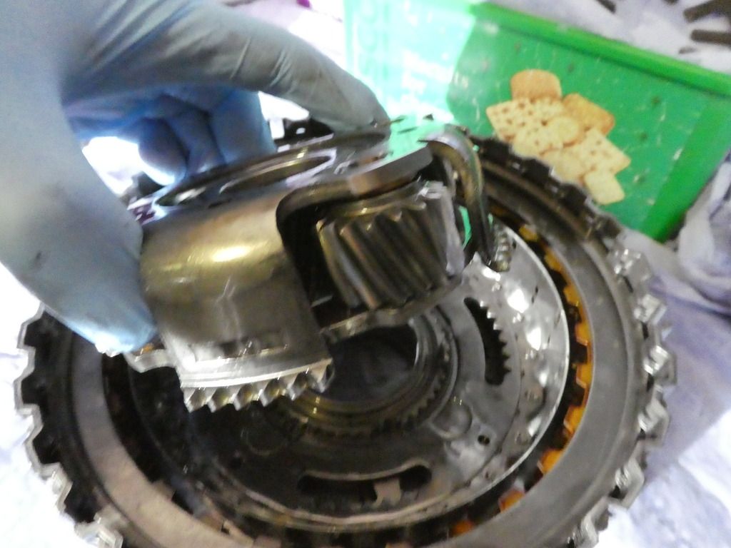

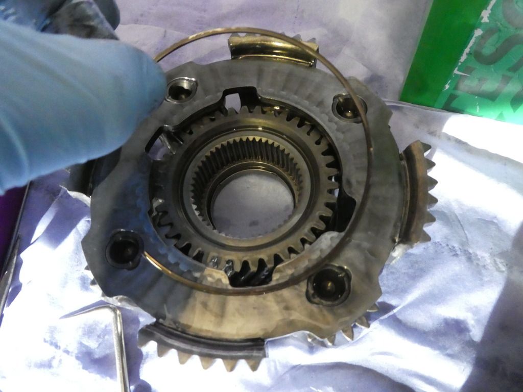

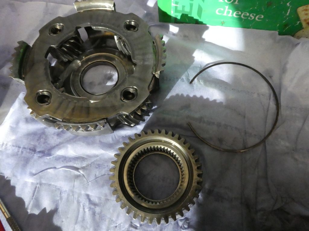

Next up is real tricky sod, you need to place a small screwdriver up in between those outer notches and the planetary gears - there is a circlip on the inner edge holding the planetary gear assembly in place, you need to lever this clip out of its seat in the four points around the gears. You will need a torch to see it and a lot of patience
If we now flipthis upside down
That's the sod there, if you want to replace this one its ZF code 0730.513.825, the book recommends you do so
You can also clearly see the four inner recessed notches you need to get the driver onto to pry this clip off (easy to see now, not so easy with this in situ!)
Now lift out the sun gear
Unclip and inspect the needle bearing

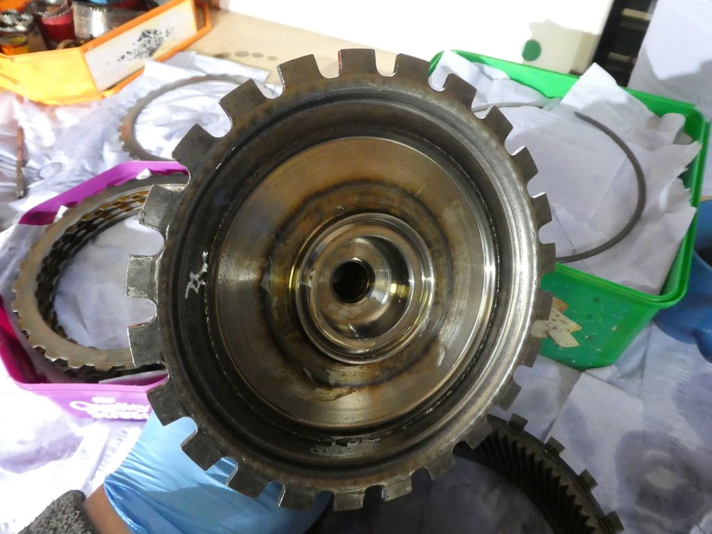

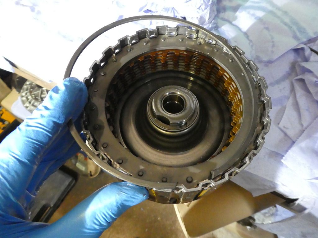

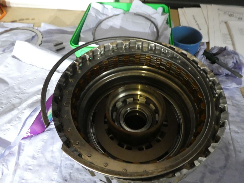

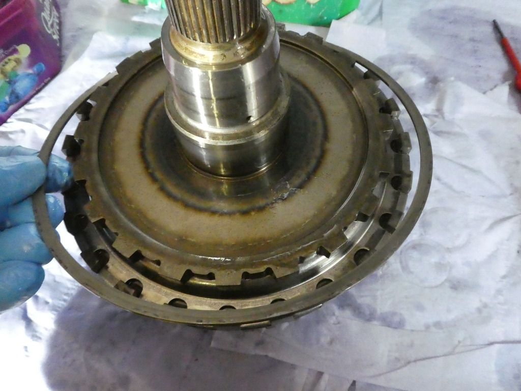

Now to remove clutch pack A, unclip the circlip
And withdraw the frictions and steels
And back to the press to release the piston, here I used an off cut of an old pipe (5" I think)
And remove the circlip; this one is recommended to be replaced, not by the book though (it was a personal recommendation), ZF code 0730.513.792 - So I did replace it

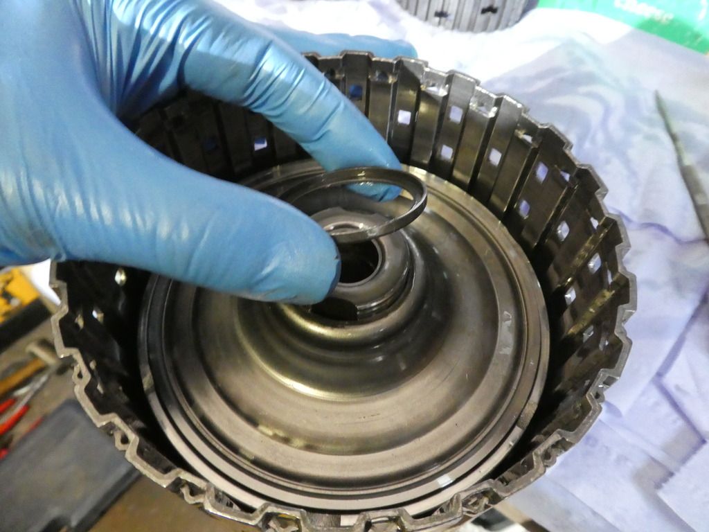

Remove clutch A retaining plate
And spring
Its doubtful you will be able to pry this piston out very easily, so dont struggle - drop it back onto the pump housing and apply air pressure to the relevant port on the pump housing to force the piston out; you dont need masses of pressure, a bar should do it. The bore you are after is the third bore to the right of the ATF strainer inlet (assuming you have the strainer inlet directly in front of you as shown)
