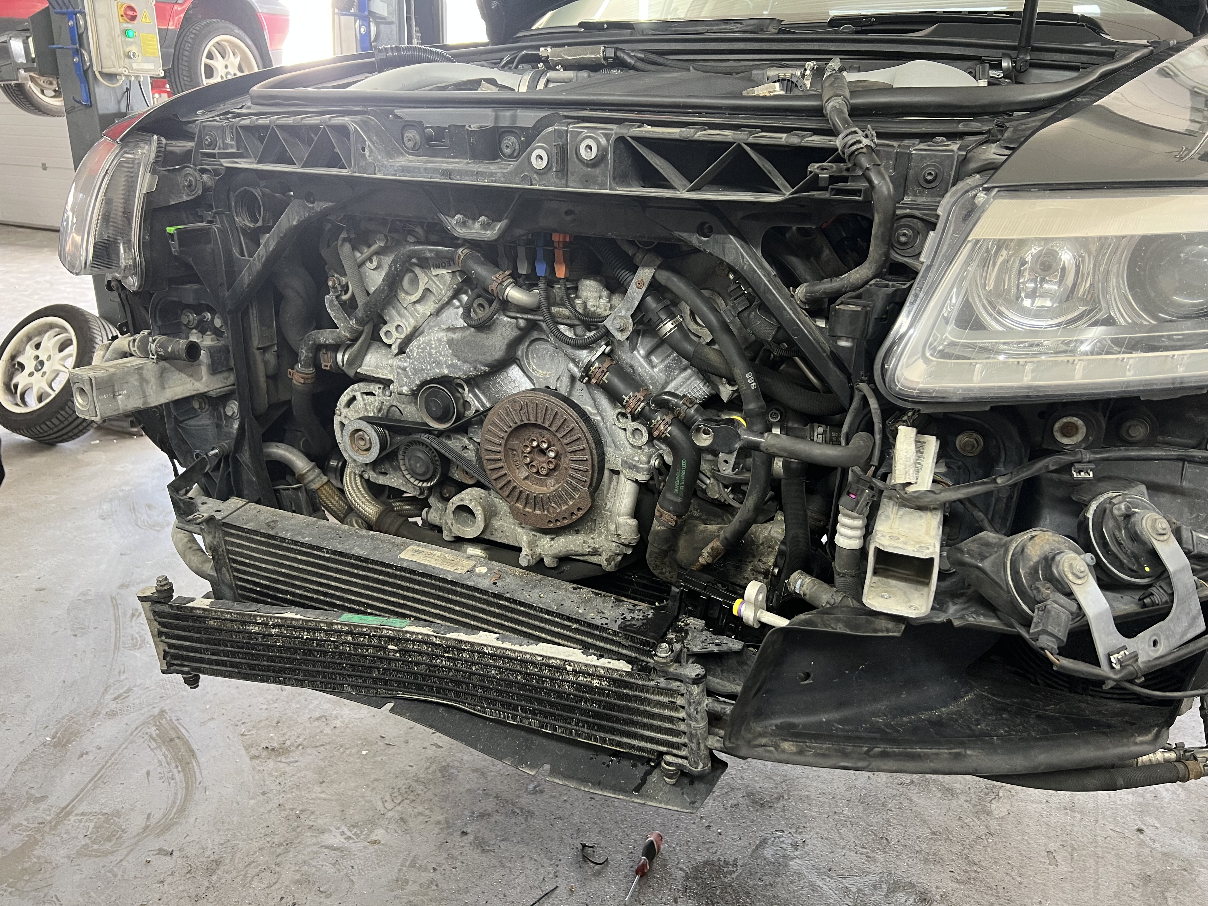

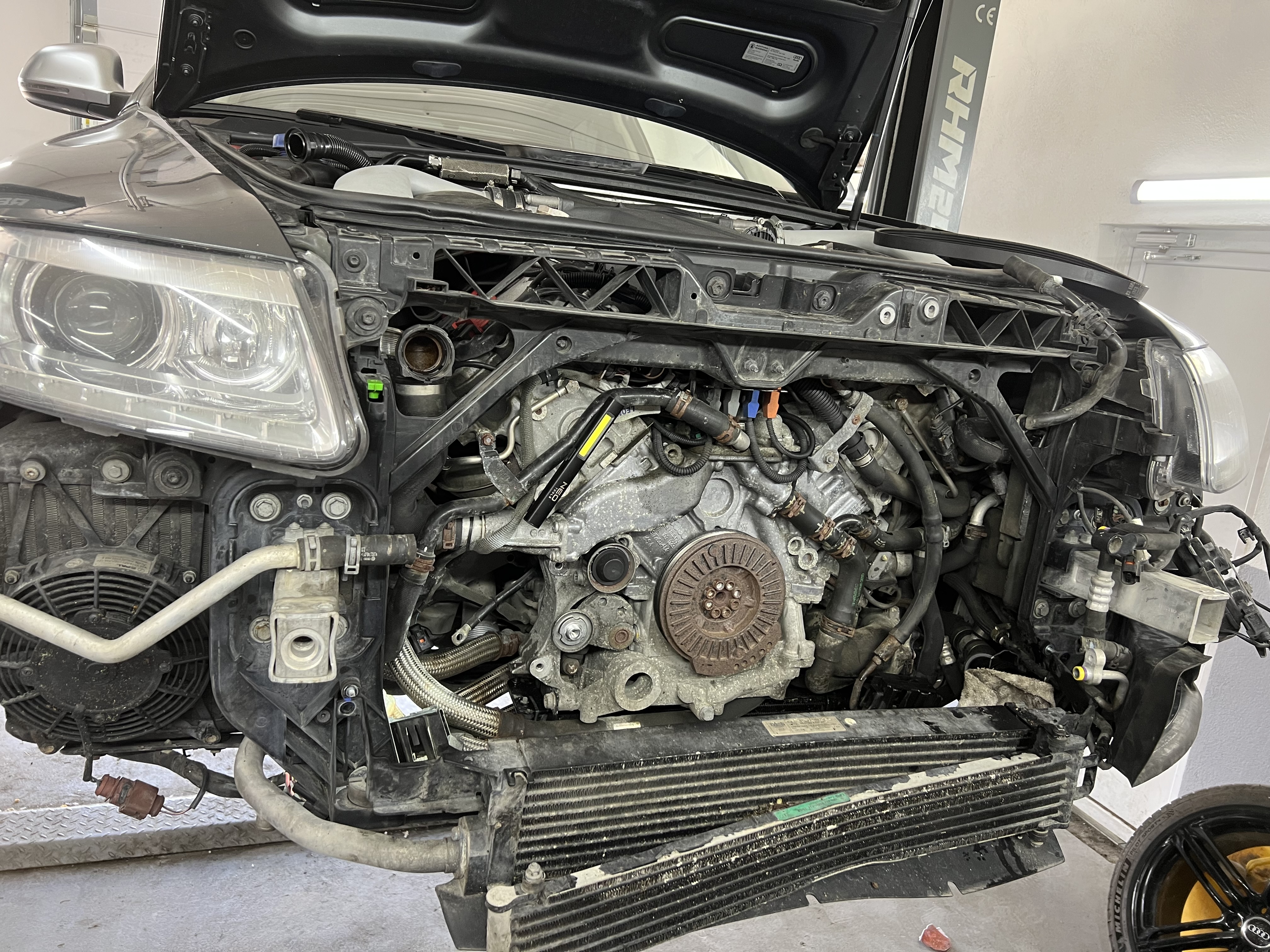

Followup for whomever needs the info in the future.
07L903015C/CX seem to be the only one fitting to the sedan version and some sort facelift of the avant.
07L903015D/DX works on the rest of them.
About the procedure, we removed the bumper, the main and small coolant + the AC radiator (empty the AC first), which gives you all the space need to replace the alternator.
Toughest part that took 30min was to put back the hose that sits on the top of the alternator.
Tips: If you ever have to do this one, change the belt and tension roller(s) (order in advance) + whatever is reachable at that point.
I've got the issue abroad during the vacation and for sure it wasn't fun.
I missed to take more pictures, however here are 2 of them before removing the alternator and after it's out.
Cheers,
Alex R.
