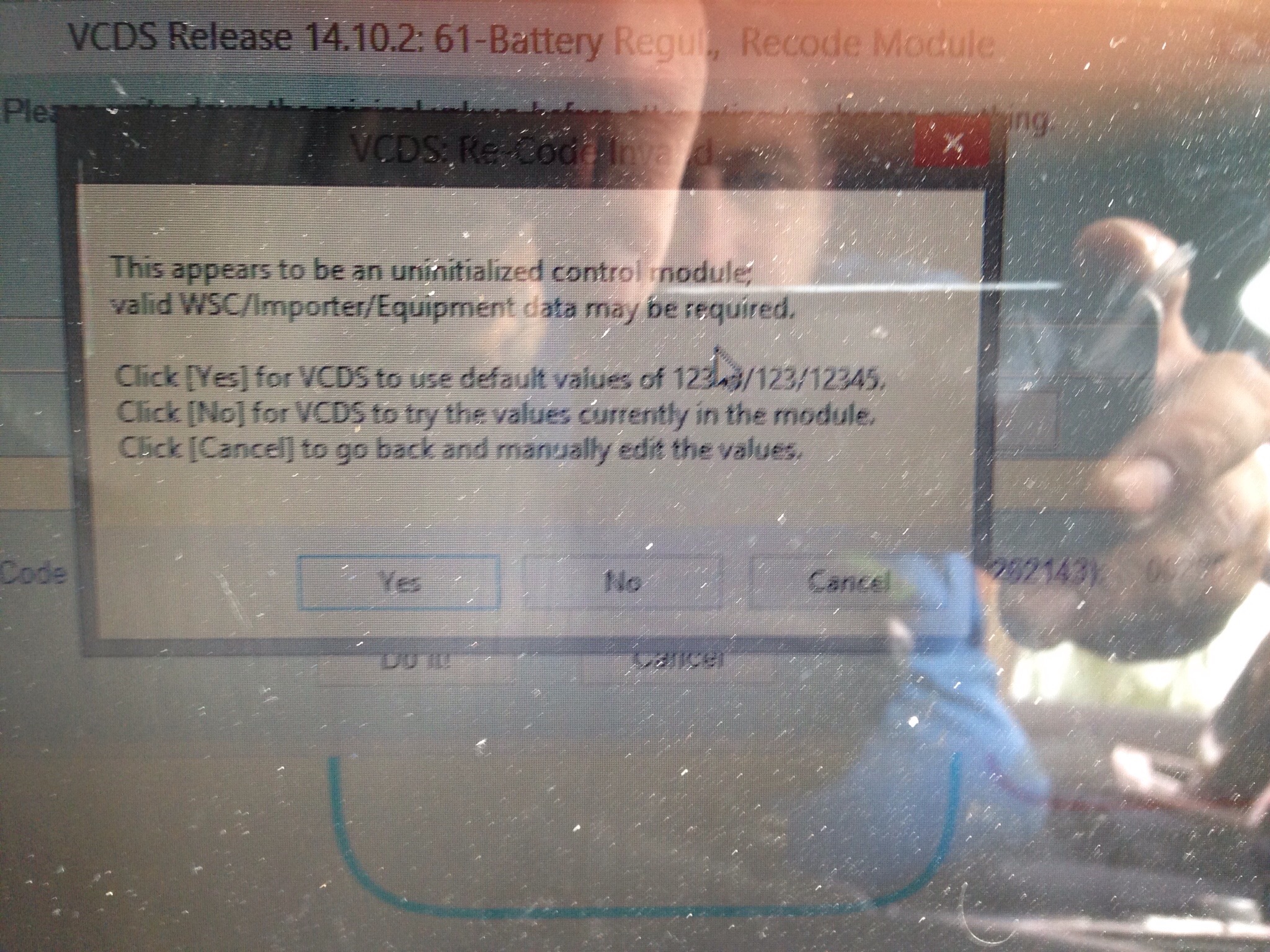

Post by leet » Fri May 15, 2015 5:50 pm
Need a bit of advice here. I've just changed my battery as it was becoming lazy at starting and battery display was more often than not below 50%. I bought a new one from TPS, a Yuasa YBX5020. Fitted it to my car and changed the serial number by 1 digit as mentioned by Golfather. The screen shot below shows what came up. I selected NO and then clicked "do it" Coding accepted. MMI was showing 100% so thought job done. Went for a drive and lost all power and would not restart. MMI still showing 100%. Got a lift home and refitted old battery, put original code back in and all is fine again. Should I have selected Yes in the screen shot to go back to default? There is no Yuasa on the brand drop down menu

Post by Golfather » Tue May 19, 2015 9:07 pm
What are the current values of the module?

Post by leet » Tue May 19, 2015 9:40 pm
Golfather wrote:What are the current values of the module?
Thanks for the reply. I've sorted it now after breaking down again. The coding was Ok. Doug reckoned on it being a fuse blown. I found the 30A fused strip link within the positive battery terminal to be blown. It was still intermittently making contact which gave me all this grief. Bodged a 30a blade fuse across it for now and picking up a new link tomorrow from Audi. Do you happen to know what this 30A supply feeds? I'm thinking fuel pumps
