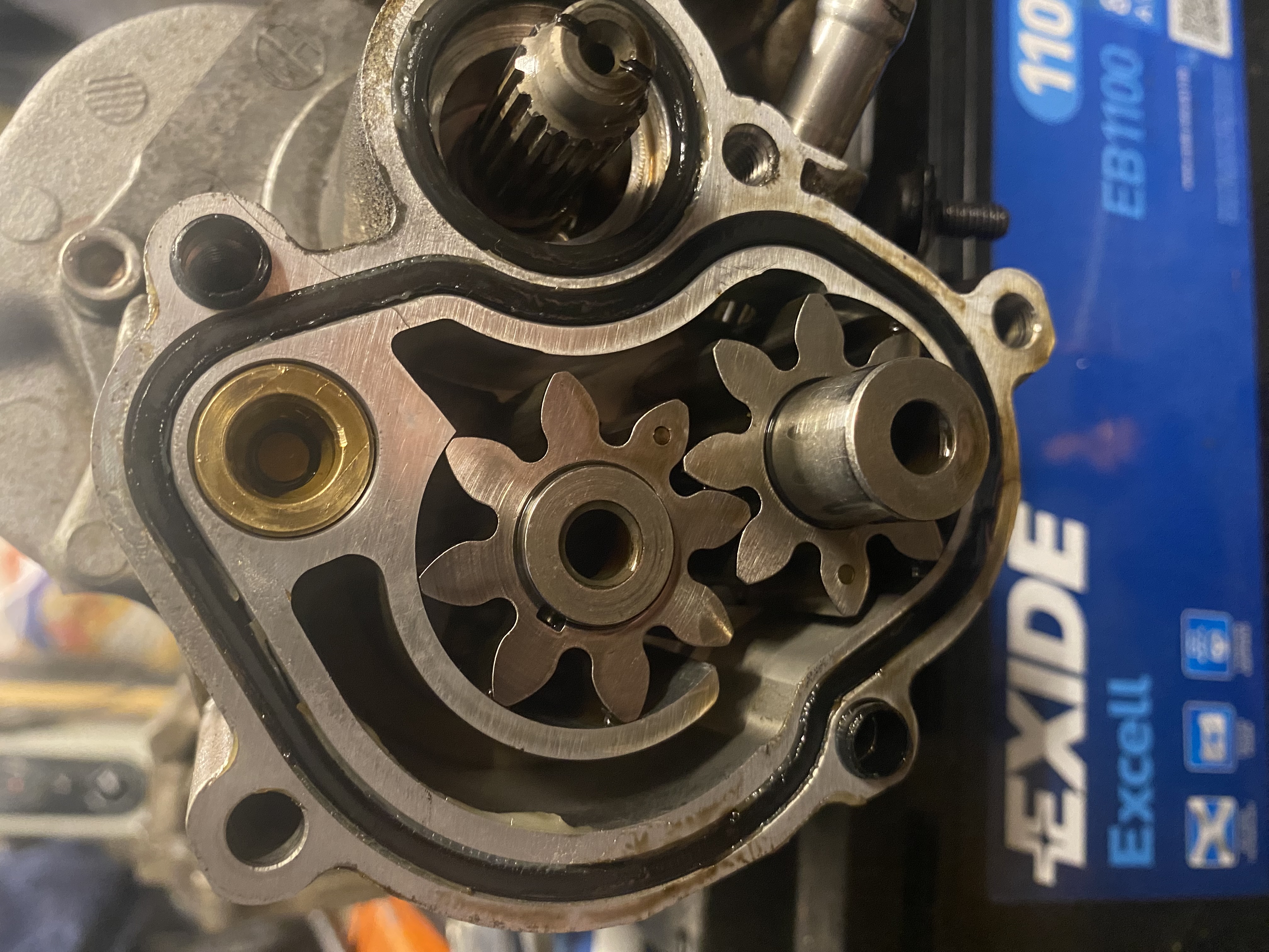

Decided to strip it this weekend but on removal of the turbo return pipe I noticed it was full of oil up to the cartridge, while removing the rest of the pipe I watched as it kept dripping out of the scavenge pump. In a change of direction I removed the oil pump, after watching a vid by Ricky at re performance, and stripped of the scavenge section of the pump to check the non return valve. Managed to then get the valve out, it was not sealing at all. So after not wanting to spend 3 k on a new pump I accidentally stumble across this part 06H103175B, just ordered it hopefully it’s the same. If anyone requires any pics let us know.

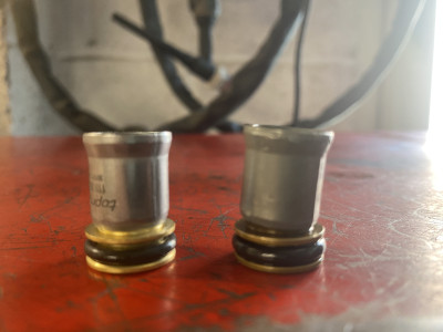

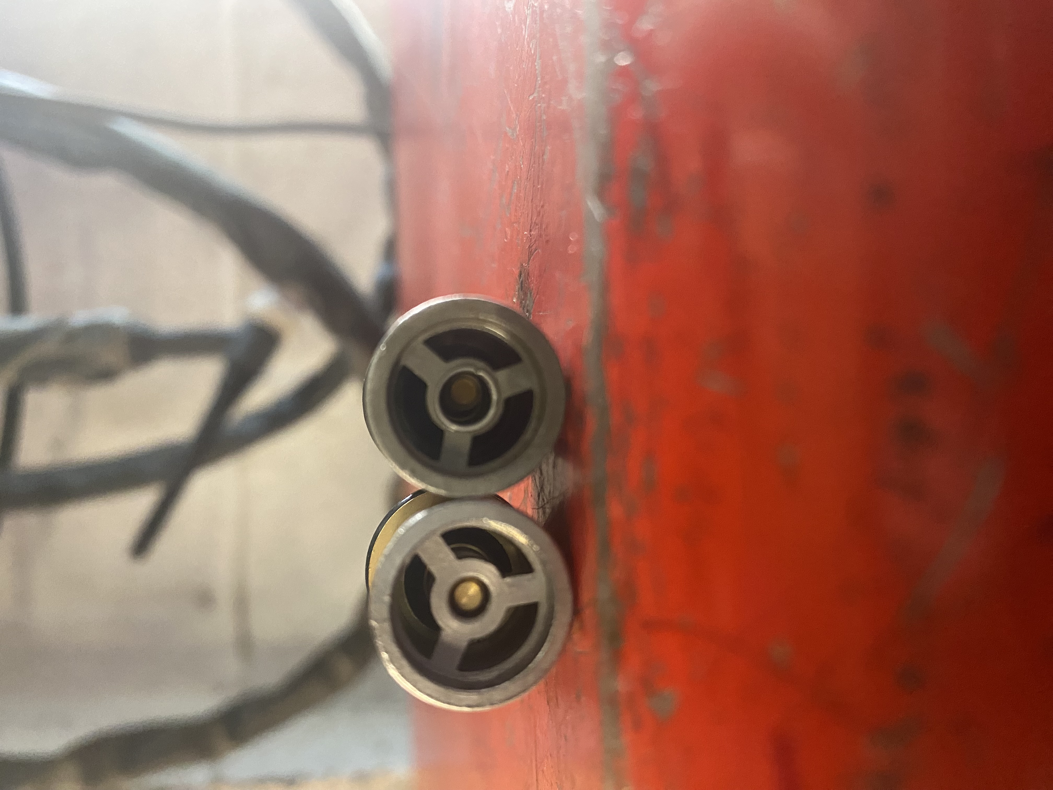

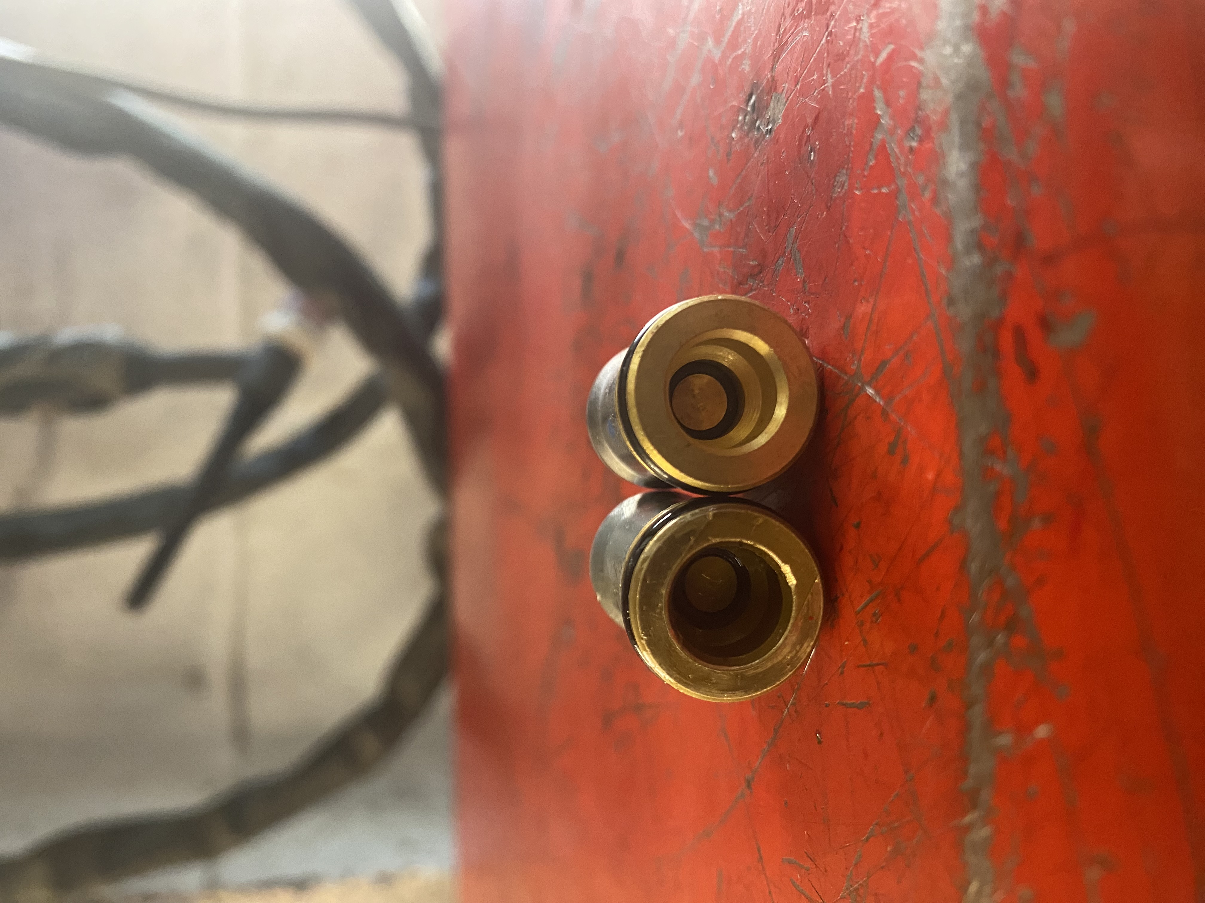

Got the new valve today hopefully the pictures have gone up to see. I couldn’t believe how worn the old one was.

Are you fitting new gaskets to the whole pump or just at the back of the turbo pump? It looks to me that it'd be possible to replace the valve with the pump in place - not easy, but possible at a push. OK, can't get the cover plate off completely but it could be pulled back to clear the gear shaft and allowed to rotate around the drive shaft cover to give access to the valve.

Still mulling over trying to do this with the pump in place - how long are the bolts that hold the face plate in place?
From this Russian site it appears they aren't very long.

Re: Oil pump one way valve
So these are the same. Cool!
I don’t think you would be able to get the scavenge section off still mounted, 3 of the bolts are longer going into the main casing.
Hm. So the whole turbo scavenge part has to come off then? Another question - which way does the valve come out? Towards the back plate or forwards towards the main part of the pump?
I ordered a valve today and would like to crack on with the job later next week.
Additional : with a bit of logical thinking (probably a mistake - since when has anything on a RS6 been logical) I concluded this afternoon that it must be forwards towards the pump so that the o-ring on the valve can seal against the body of the scavenge unit. So it looks like there's no short cut, it's pump off. Oh what fun.....
The brass section of the valve faces the rear of the scavenge pump end plate but I removed all of the scavenge pump section to poke it out.
