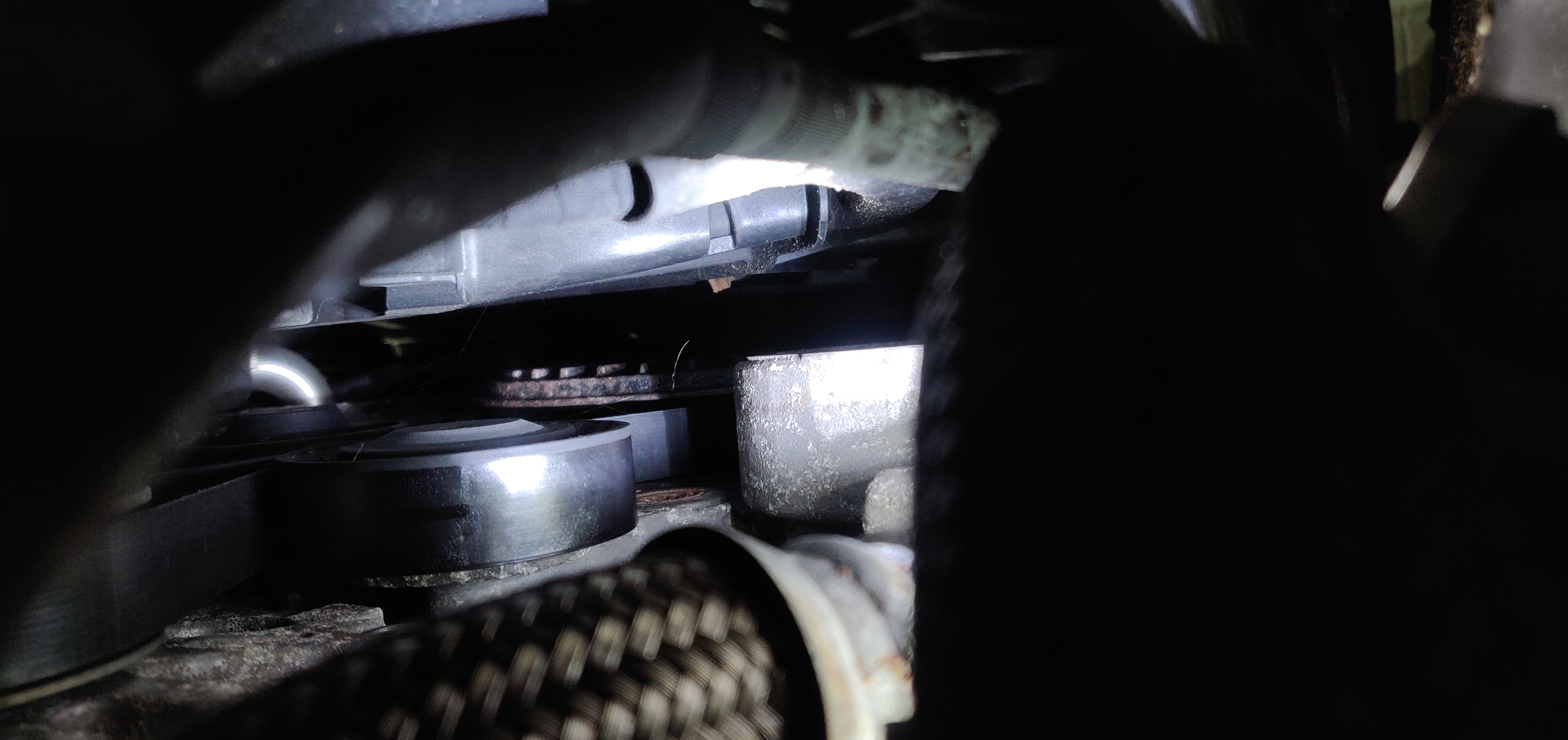

cammmy
Posts: 247
Joined: Tue Dec 10, 2019 3:32 pm
Re: Manually Turning Engine
Post by cammmy » Tue Dec 01, 2020 8:22 pm
So I have an idea, might not be a great one but I'll give it a go.
The crank pulley has little protrusions on it and there's a big boss underneath it. I can get a pry bar in there and slowly lever it around clockwise. I gave it a test and it doesn't take much to move as there's no compression with the injectors out, so I don't think I will damage anything.
