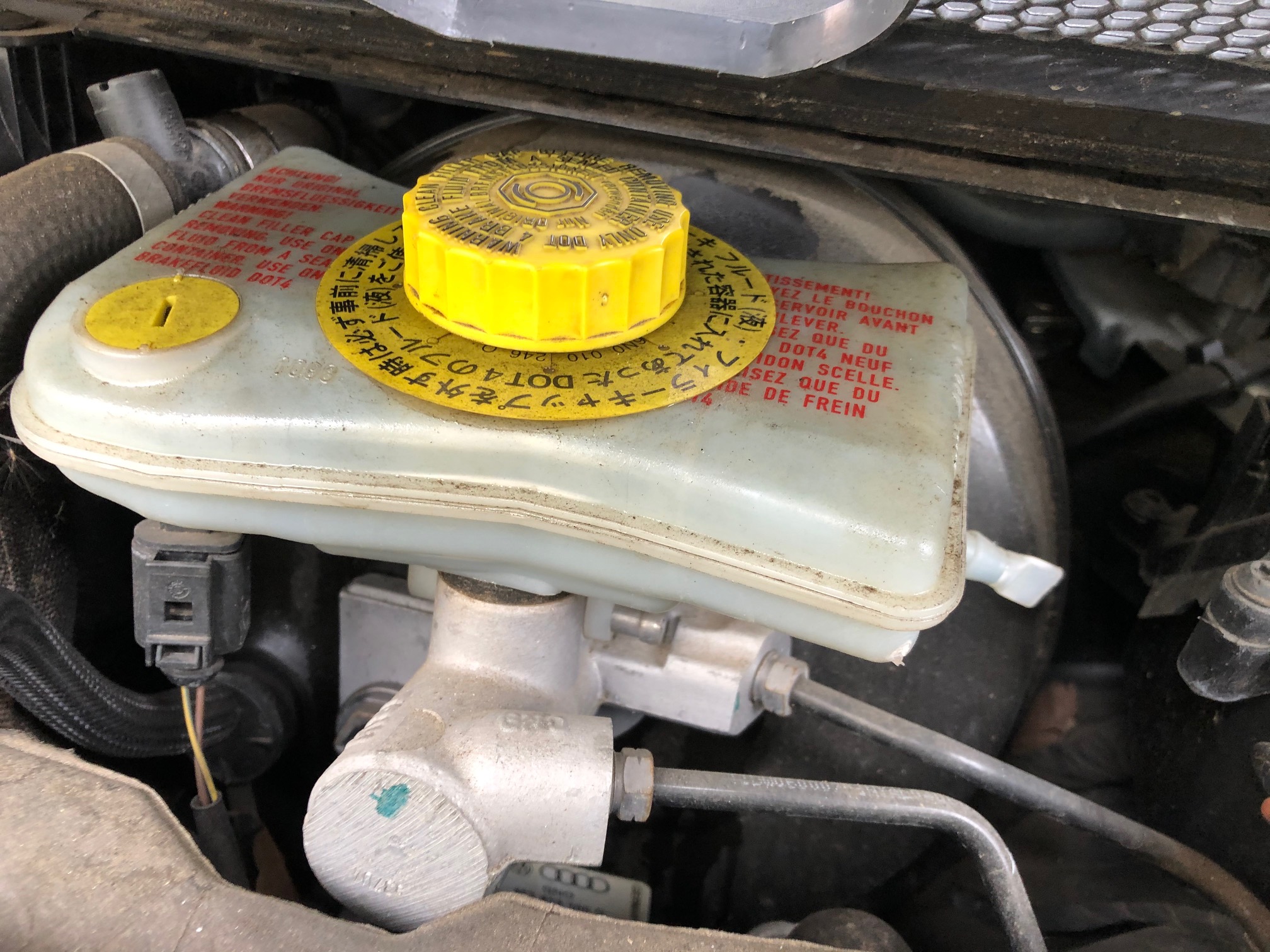

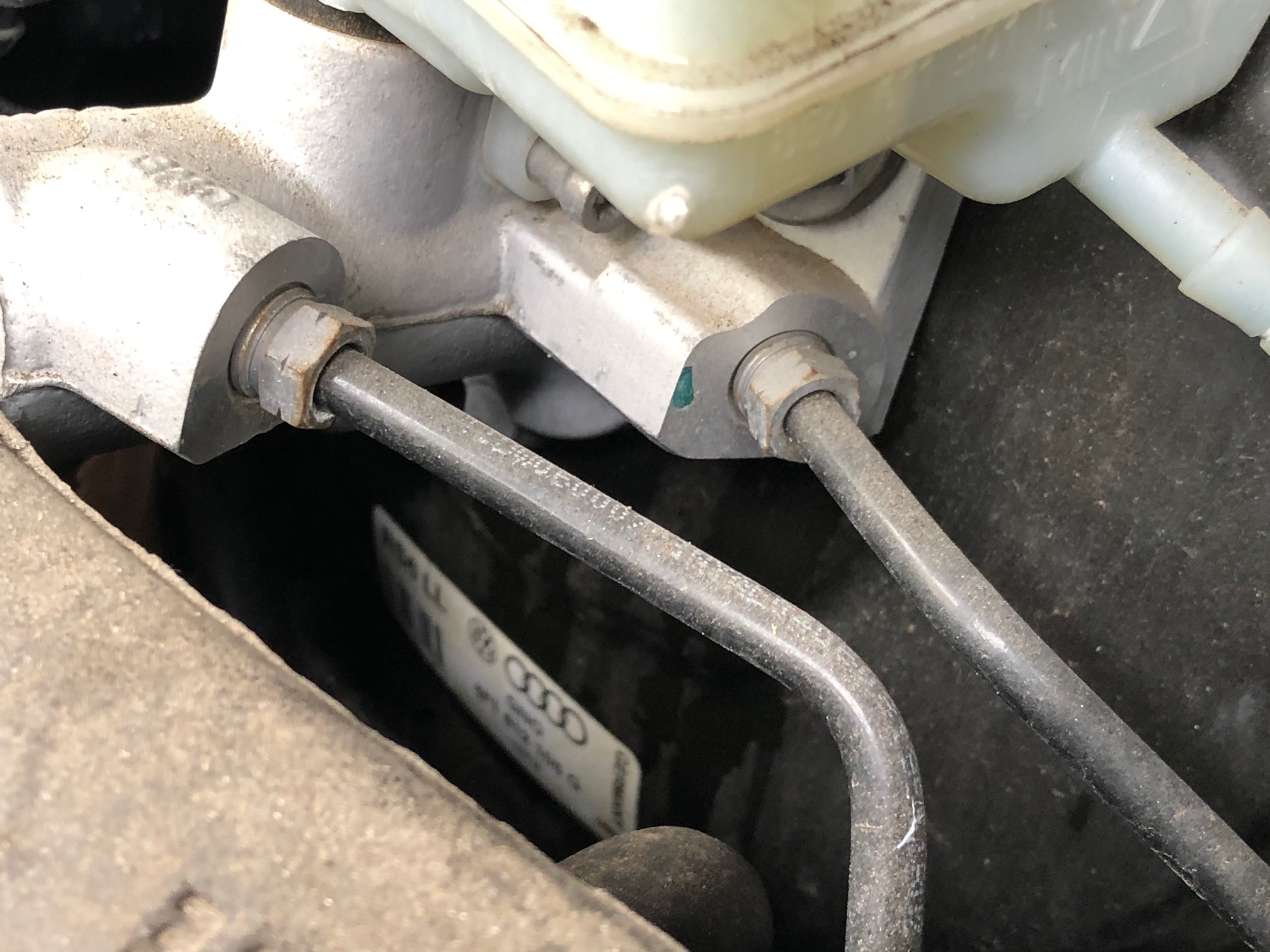

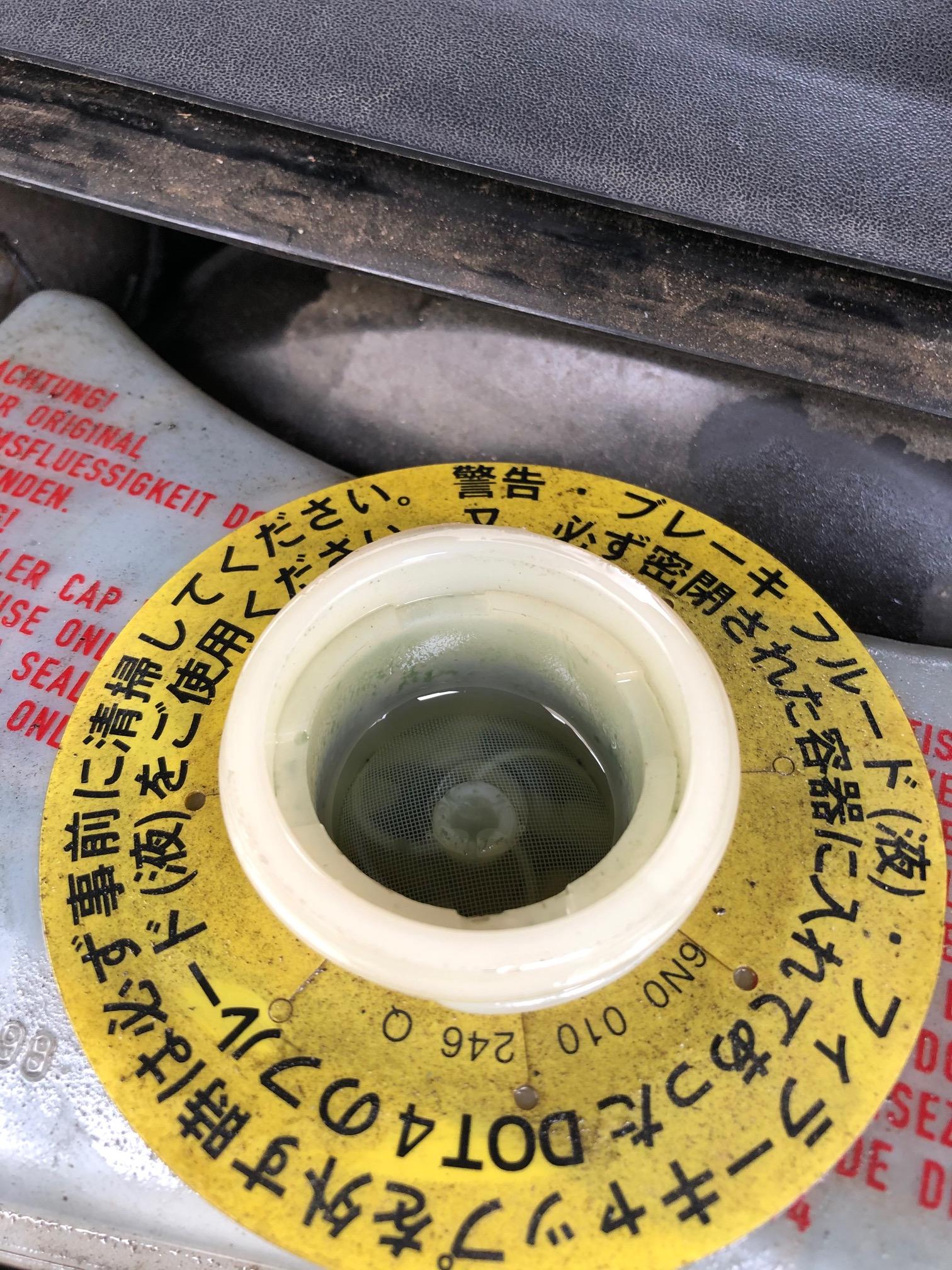

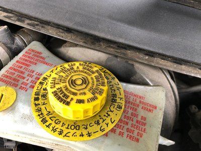

Ian, Jim, first off, thanks to you guys for your help. I don't know what this forum would do without you.
That said, I'd like to declare myself a huge turd. I feel about ten years older, and about $10K richer. I entirely forgot about the brake fluid; and check out these pics:
Although I never looked behind the brake cylinder before doing the job, I'm pretty sure it did NOT look like this: Level looks pretty full as well. The floor in the overnight garage was also dry, so whatever leaked, must have stopped.
I dumped about 5L of water on and around the brake cylinder, hoping it'll wash off some of the brake fluid residue and follow the same leakage path.

You've confirmed a thought I had late last night.
Then later on I thought 'Hang on, the plenem drains are there, why didn't my fluid leak there? Ah, because back then the drains were blocked with leaves and sh*t you idiot".Last night I wrote: ↑Sat Apr 04, 2020 6:14 pmI suppose that it could be brake fluid from an overflowed reservoir but from experience (yes, I changed some pads without checking the fluid level) it doesn't drain out there.
