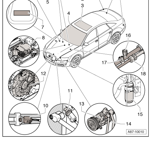

Common problem on a C5 , so i guess its probably the same on a C6.
C6 ambient temp sensor G17 is same place as on the C5 , sensor is behind the front bumper.
Its a bumper off job to change it.
Item No 10 in the picture
