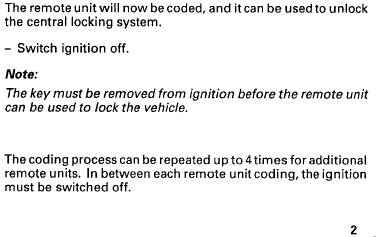

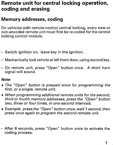

Post by MCB » Wed Apr 02, 2008 8:58 pm
Stevie try this...
S4B5 Avant
