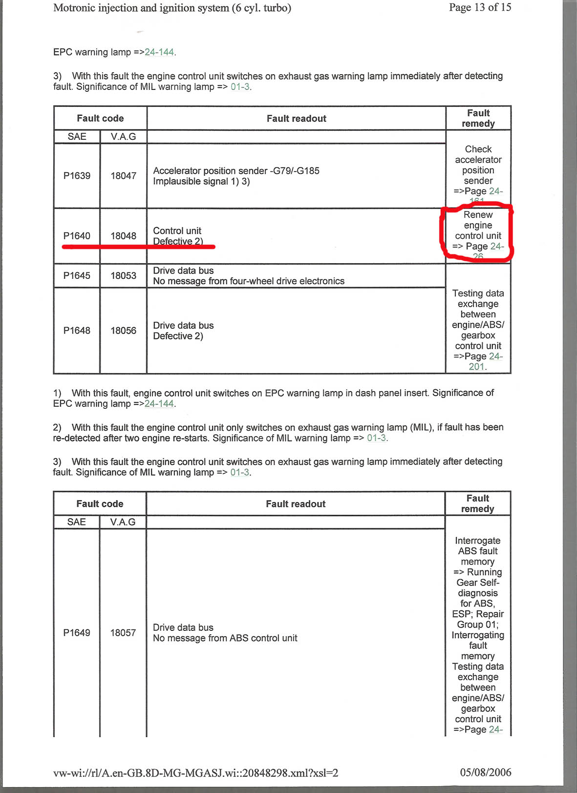

Morpheous
Posts: 245
Joined: Tue Oct 07, 2003 8:12 am
Post by Morpheous » Sat Aug 05, 2006 12:45 am
Heres a quid, knock yourself out!
Call it what you want still the same result from the factory.
Fault code.jpg (232.73 KiB) Viewed 2454 times

Post by S2tuner » Sat Aug 05, 2006 12:51 am
And I am telling you from experience that this fault code can occur on cars that have never been chipped and it won't be a defective ECU. The code can occur after for instance disconnecting the battery whilst the ECU is still in its "afterrun" mode, where it writes different adaptation values to the EEPROM (not the same as the main memory which is the EPROM). If the car starts, the code clears and doesn't come back, don't bother, period.
End of story, you're the best, I won't reply anymore to posts where you know better than anyone else.
