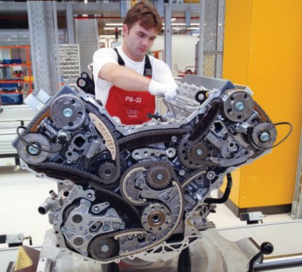

PetrolDave
Posts: 7599
Re: Timing chain
Post by PetrolDave » Sun Jun 17, 2012 5:05 pm
This shows an S4 engine, but the chains are almost (exactly?) identical on the RS4 engine.

4 chains or something? I've heard of them being replaced if the rattling gets too bad. Something like 2k in parts alone
