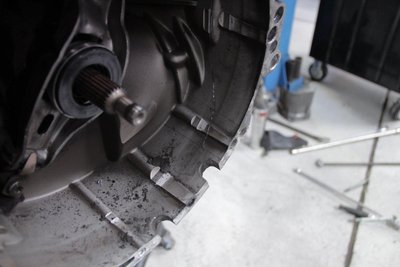

Had an issue with vibrations and resonance for past 3 days above 3k rpm.
took the RS4 to the Audi dealership and they've come back with a cracked bell housing and will have to wait until they get the gearbox out to see what else is up!!!
I've had a look and a google search about this and it seems it might be the flywheel that has caused the crack and vibrations.
My main question is.... will the extra year warranty i took out with audi for 2k+ cover this???
Any insight will be greatly appreciated as i need to know whether to get my kidneys listed on ebay now so i got enough to cover a potentially LARGE bill.

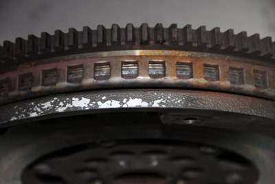

Post by sidzz » Thu Mar 08, 2012 1:58 pm
Hi,
Have spoken with a technician and looked at the now removed gearbox. The bearings in the flywheel disintigrated causing the flywheel to smash into the beall housing and break it!
Has anyone ever had a similar problem and was it covered by warranty? The clutch was worn down but i hadnt notice any slippage, and the cluch plate had changed colour to a reddish colour, the technician said this is due to lots of full power launches... whilst i drive the rs4 heartedly i dont really do fast launches from standing. from the tone of the conversation, i get the feeling the warranty company might use this as an excuse for not paying...
Any advice etc appreciated
Sidzz

This is not that uncommon.
The dual mass start to stretch the strap inside and then the outer section of FW cahtters on the bell housing - and will break it. It feels like a misfire but doesn't sound like a misfire.
The gap is too tight from FW to Bellhousing.

Post by Doug_S2 » Fri Mar 09, 2012 3:43 pm
You wont get a new gearbox, clutch and flywheel for under 2k. You cant even exchange the box with Audi as the casing is damaged.
Solid FW, new clutch and weld the casing or source second hand replacement is the cheapest option.

Post by sidzz » Wed Mar 14, 2012 1:58 pm
Went to take a look at the damage. the flywheel bearings disintigrated, causing the fly wheel to crack right round the bell housing and even remove a chunk of it.
Audi warrany will cover the damage, though i need to pay for excess and new clutch as it was worn right down and now seems a good time to change it. So 9 monthis in to buying a new warranty for 2k and wondering if it was worth it, i am now convinced it was a good choice.
Will wait to see what the cars like when it gets put back together
