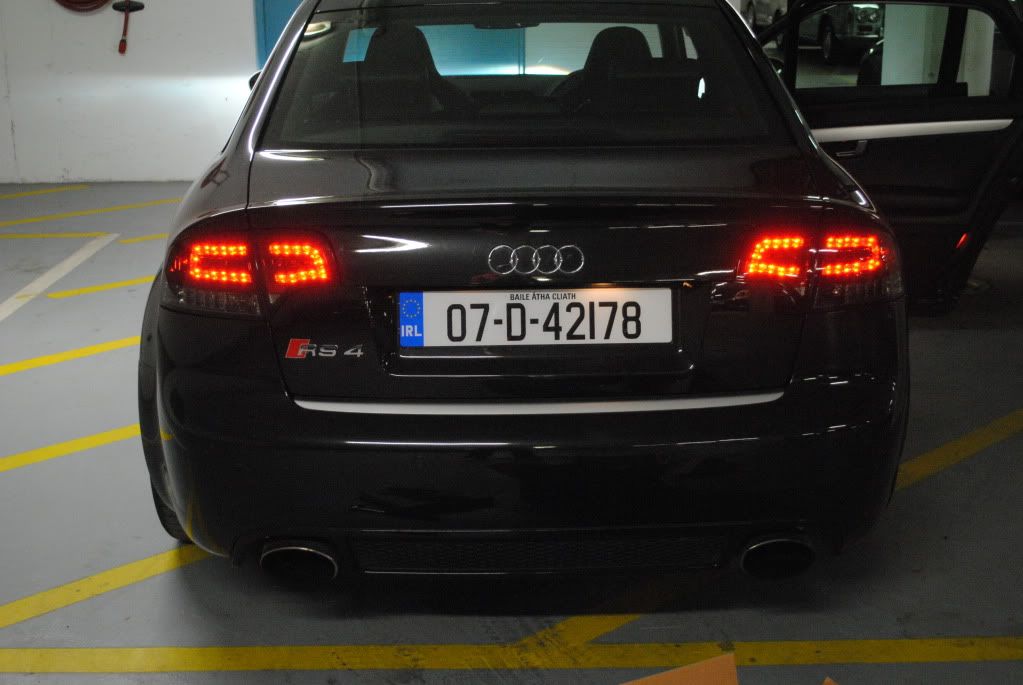

Heres them on a less ghetto booty model!

Post by Shadow6ix » Fri Jan 27, 2012 12:16 pm
lol... thankyou! I can't make my mind up about these things. I think I'd probably want clear instead of smoke.

Post by edge » Fri Jan 27, 2012 12:24 pm
Shadow6ix wrote:lol... thankyou! I can't make my mind up about these things. I think I'd probably want clear instead of smoke.
I think the clear look very 'Lexus' and thats whats spawned every boy racer/modder buying them for there cars, but to each there own ;)
