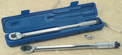

For those is Aust, this is what I found for a reasonable price around $90AUD:
Kincrome Micrometer Torque Wrench 1/2". #MTW150F

[quote="Ozrs4"]For those is Aust, this is what I found for a reasonable price around $90AUD:
