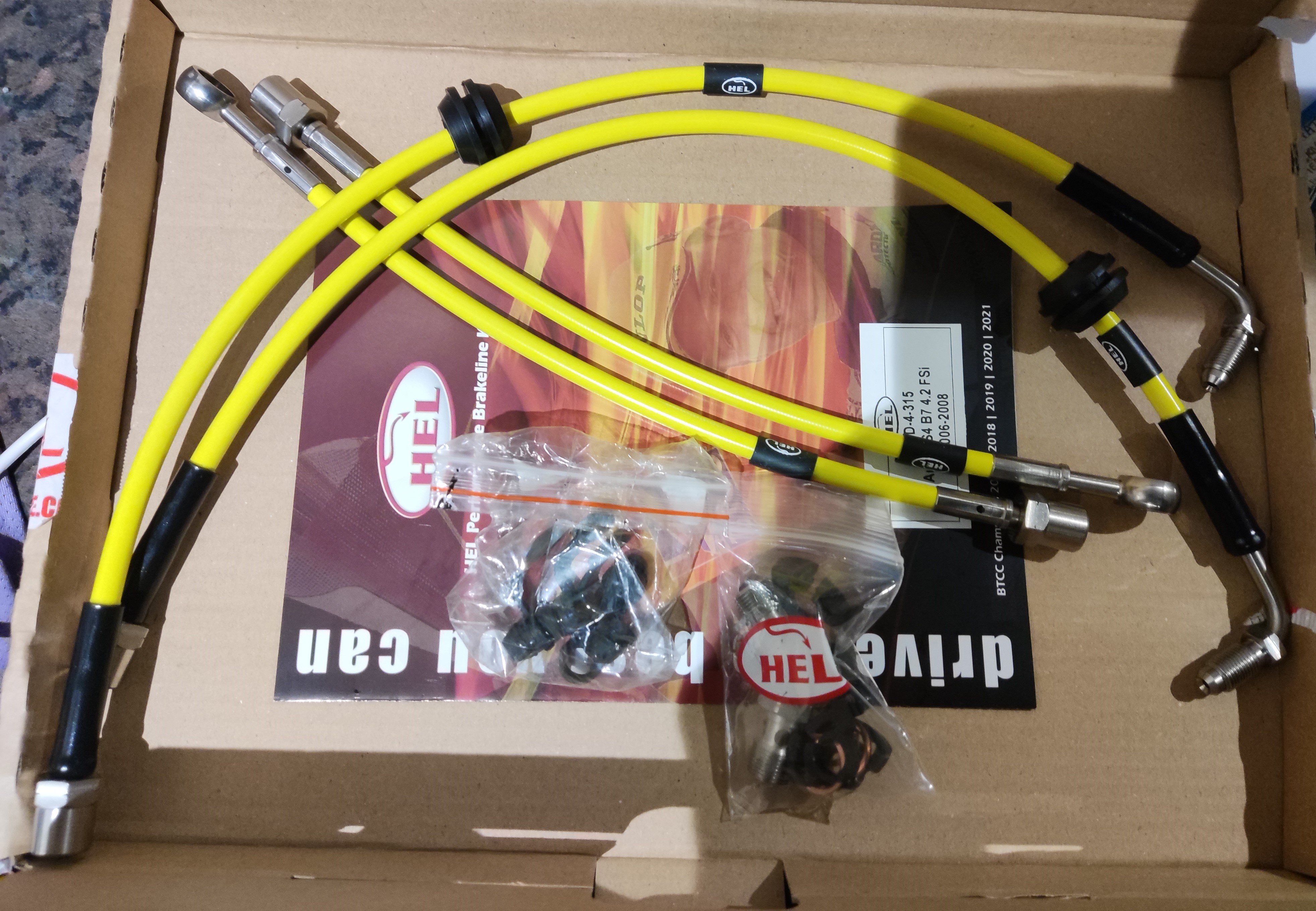

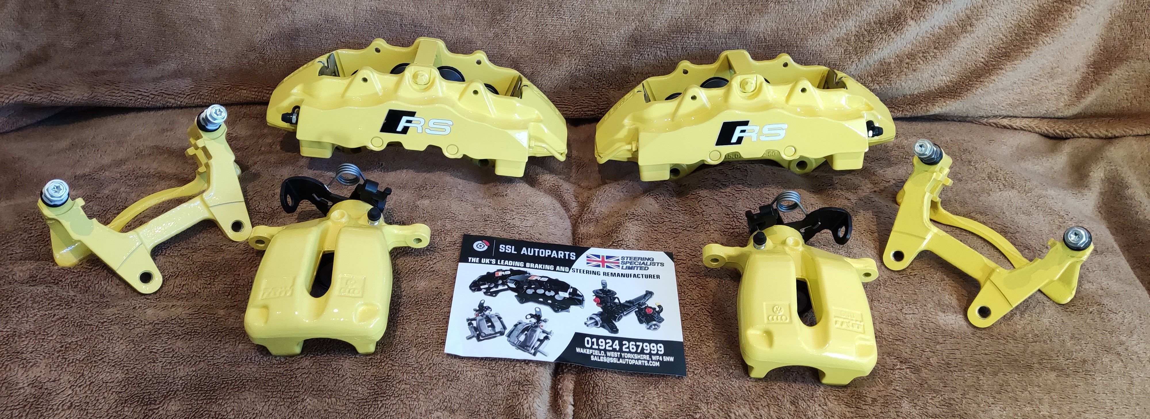

ok, so I'm finally onto getting around to doing the Complete Braking setup on the RS.
Got the Brake Calipers refurbed by SSL Autoparts who did a fantastic job, recommended - who blasted them, painted, with new seals, new bleeder nipples etc.
