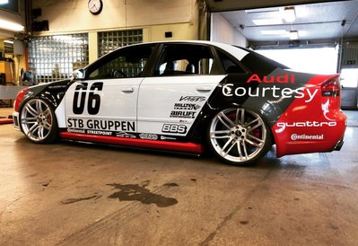

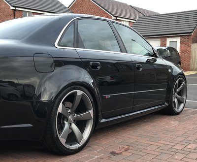

I've mounted 20" RS5 wheels with no spacers. Sure you've seen photos of this set up before but if not I'll post some later.
Others have fitted 20" C7 RS6 wheels but think they need spacers.
Others have fitted same design, width and offset as oem wheels but the 20" version with and without spacers.
Don't think I've seen any 21s though. Or maybe there was one car that had them and looked over wheeled.

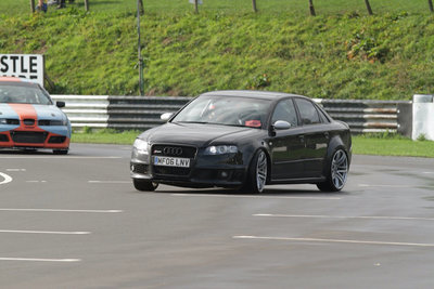

See my thread for details, 4mm spacers
My generic RS4 photo

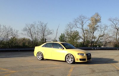

Post by MikeFish » Wed Mar 20, 2019 7:27 am
Courtesy of benhol and softishman.

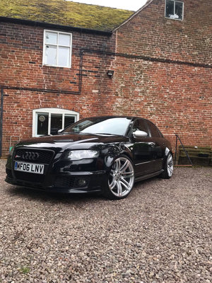

Yes.... so settled on these puppies
Bit of s snug fit, but they look dreamy

Post by MikeFish » Sun Mar 24, 2019 10:11 pm
It's snug because you have much wider tyres. Those are 275 wide rather than 255 wide.
