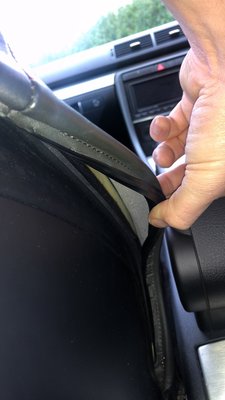

On Both front seats the trimming is coming off the back is there any way of pushing it back in to place?? Is that how it has to be done or is there clips??
Thanks for any help
Re: Hi all little problem with my wingbacks
Post by MikeFish » Sat Dec 29, 2018 10:34 pm
No clips, it is just tucked in. I've never had any issues just tucking it in by hand on the easy to reach areas. Might need to pull it a bit to make sure there is enough edging to tuck if it doesn't go in willingly.

Slacken the bolsters off so they’re on their widest setting and you’ll find it easier to tuck them back in.
