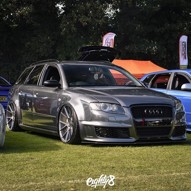

Hi Guys
Has anyone tried to fit 420mm discs on the front of a b7 rs4 ?
I currently run 20" wheels ..
Here is a pic of my car for the hell of it

OT. Have you got laminex on your headlights ??
