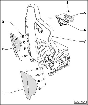

I had the same problem with my passenger seat. You can buy each part individually. From your diagram above the bits I had to replace were...
Part 4 - £6.68 (not really necessary as you can just re-use the existing fixings)
Part 5 - £18.75
Part 6 - £13.32
All prices + VAT. Unfortunately I don't have the actual part numbers to hand.
