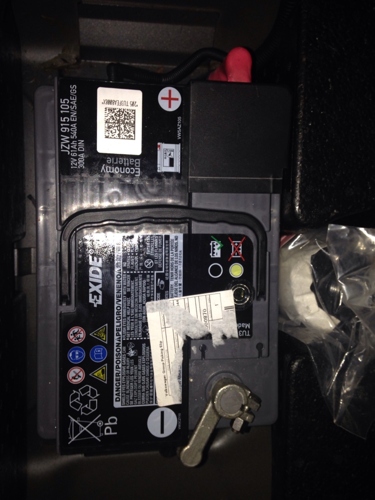

Re: Battery recommendations
Great service from Tayna batteries. The new Varta has done the trick.

Good job Divine
The old one looks tiny, so quite possibly under rated as well.
