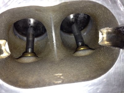

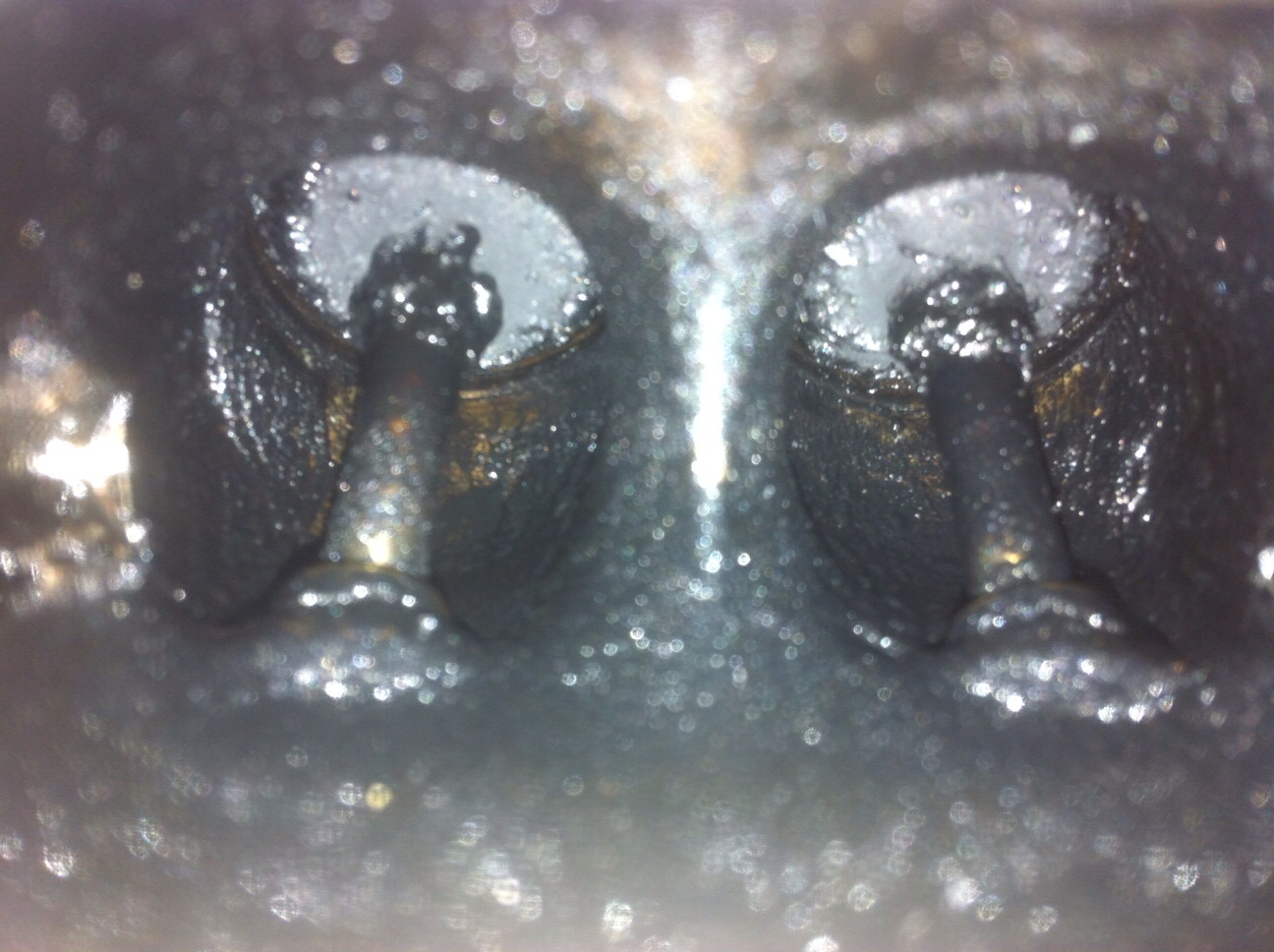

Here's mine before/after...!!

Wow, they looked much cleaner before!

Stupid iPhone...! It's keeps throwing up a error...!! Put them the wrong way up...!! My bad... You get the idea... ;)
