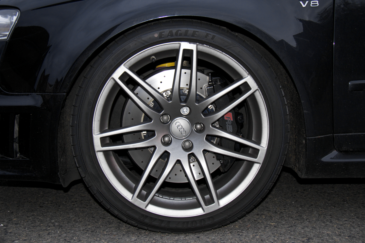

Rule 1.
For reference...
Current height
This one rubs [hides face on kerbed rim :oops: ]

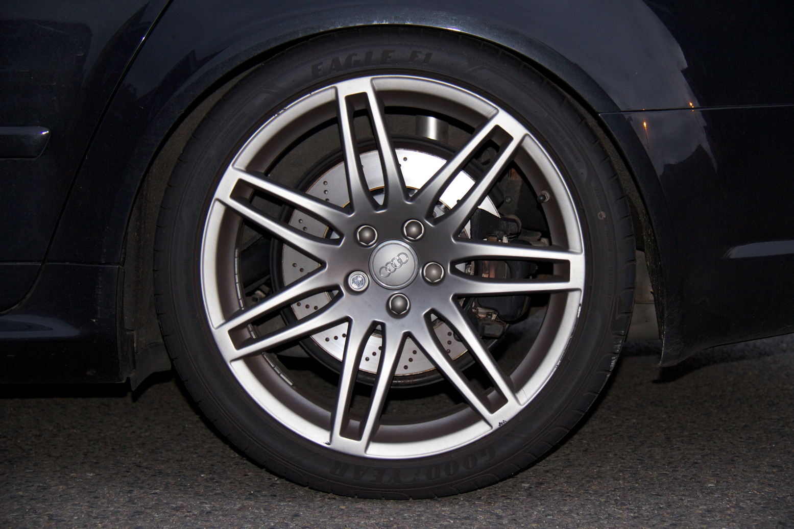

Rear height
