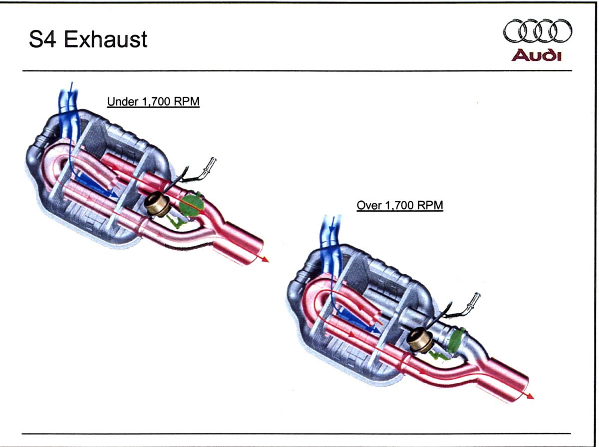

Found them....they are located on the top of the boxes huh!!
Found the below clearer diagram on the Milltek website.
Gonna disconnected them tomorrow afterwork.....can't wait!

Good find, should make a diference low down in torque and noise of course.

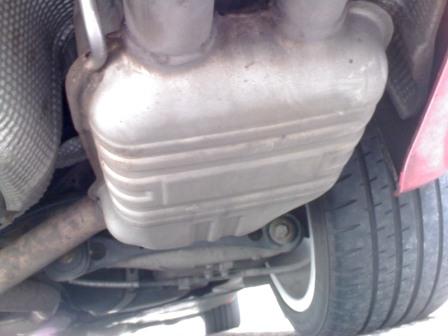

Hi guys,
I can confirm that my B6 S4 DOES NOT have the exhaust valves discussed.
I took the rear boxes off their rubber hangers and pulled them down, but there were no valves to be seen???!!
She only has 23k on the clock so I wouldnt have thought that the exhausts have been replaced with cheaper replacements??
Anyone got any thoughts?

Your car is tiptronic

Hi,
Its a manual. Replacement exhausts? Really?? It has 23k on the clock?!! Are the exhausts likely to go that quickly? Getting worried the car has been clocked now. Bought her from Stockport Audi.....noticed on the vehicle reg docs that she has had 5 previous owners. Is there any way to check if shes been clocked??

Post by kaisersolsay » Sat Sep 22, 2007 12:31 pm
Pictures of my rear boxes without the acutators!!
