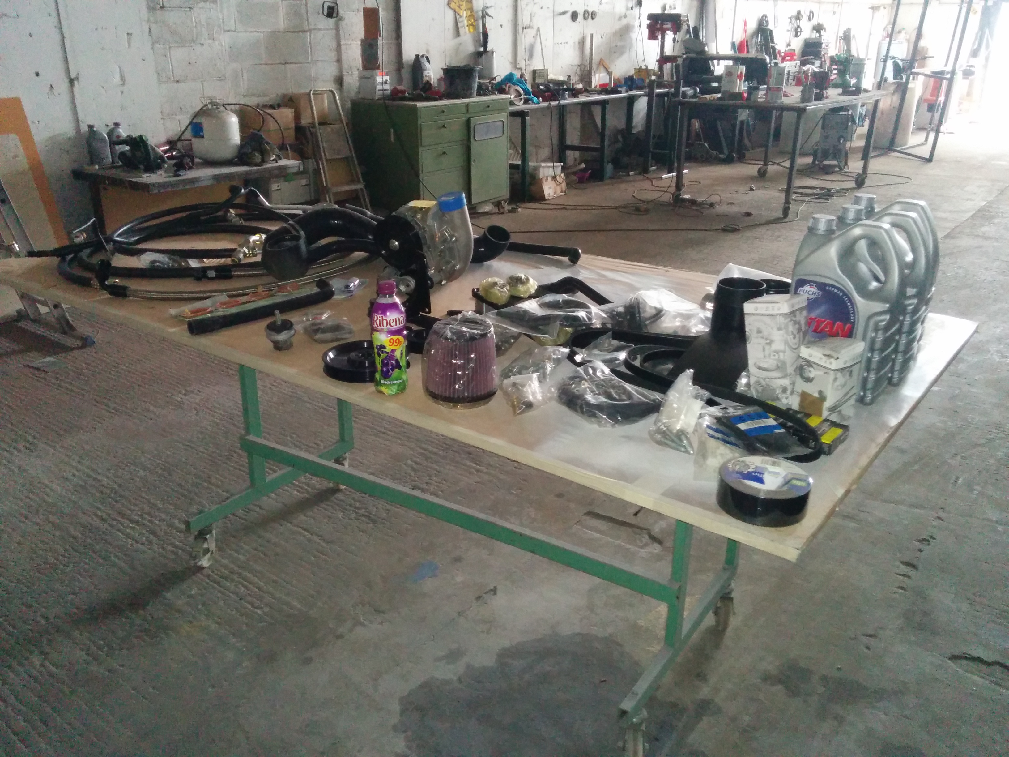

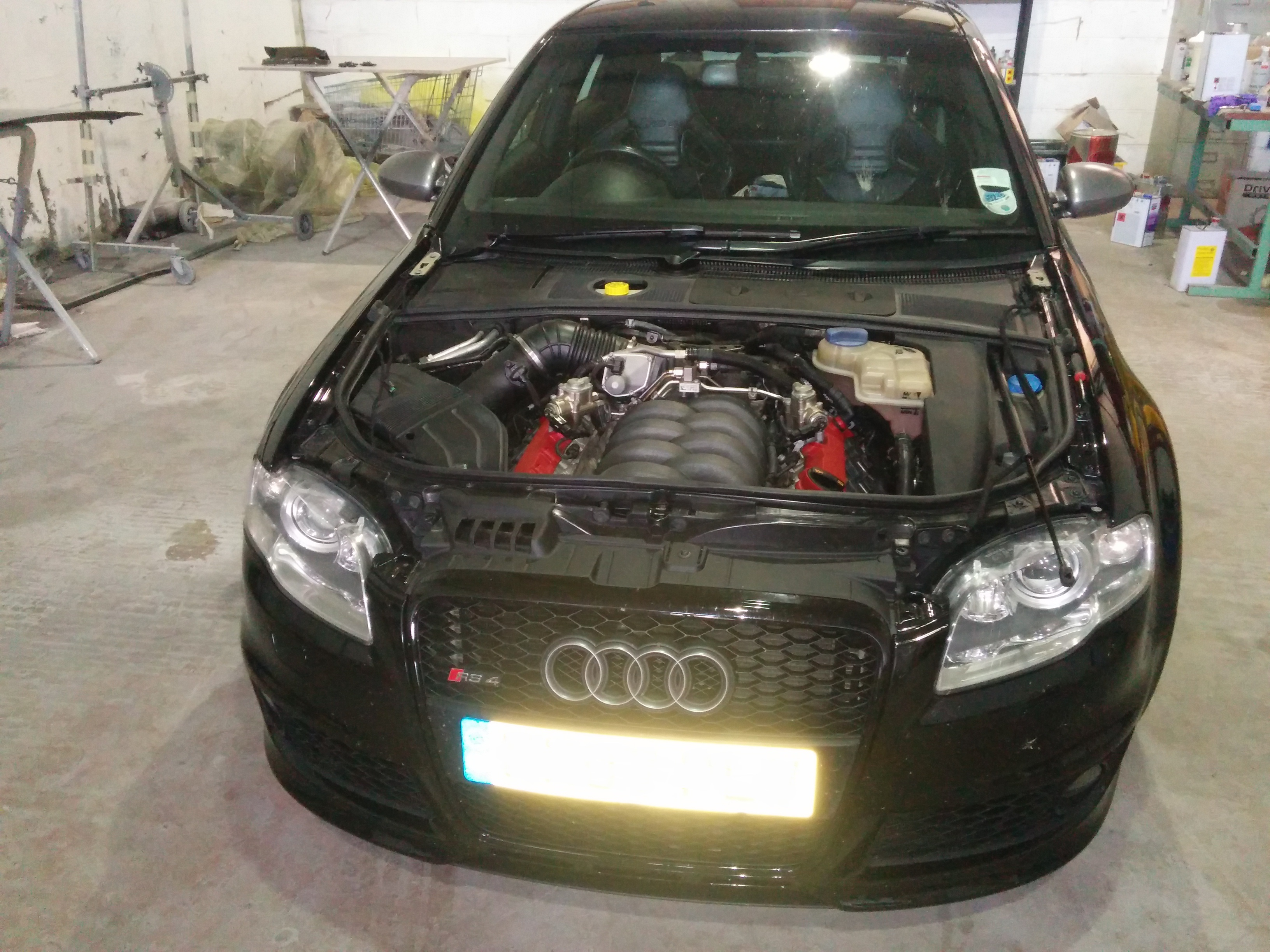

finally got round to starting this install, not sure how long it will take as me and a friend are doing all the work as and when we get time. having said that we have made decent progress so far!.
got to find room in here for a supercharger!.

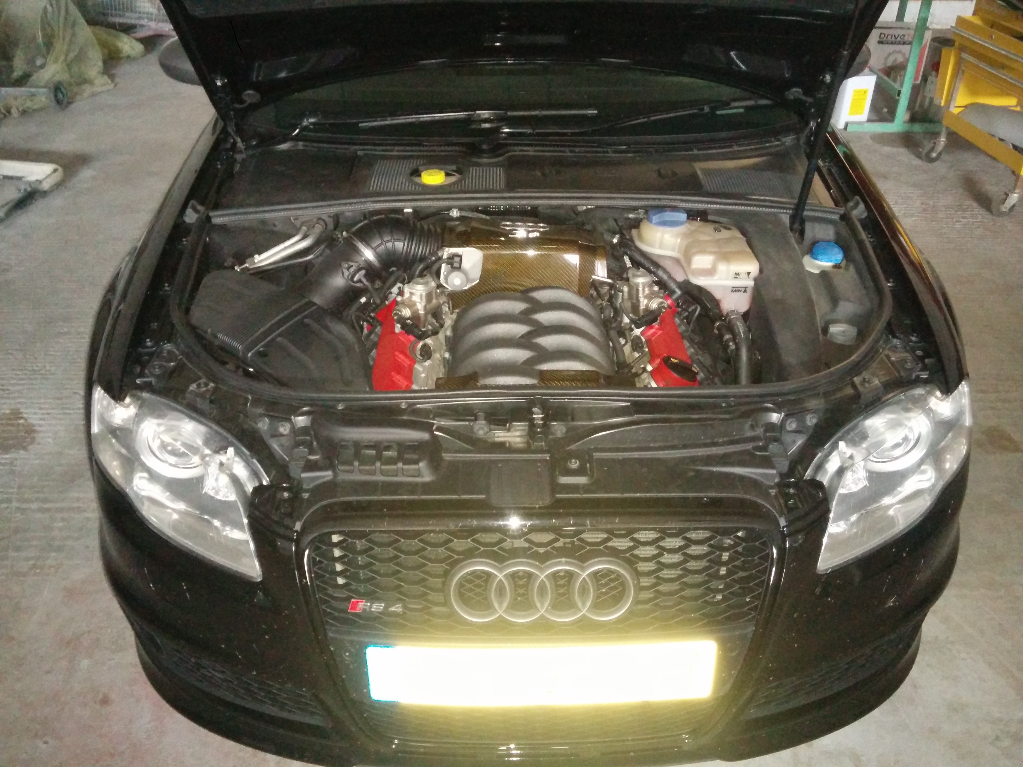

bonnet off to make a bit of room.
all this has fit somewhere!

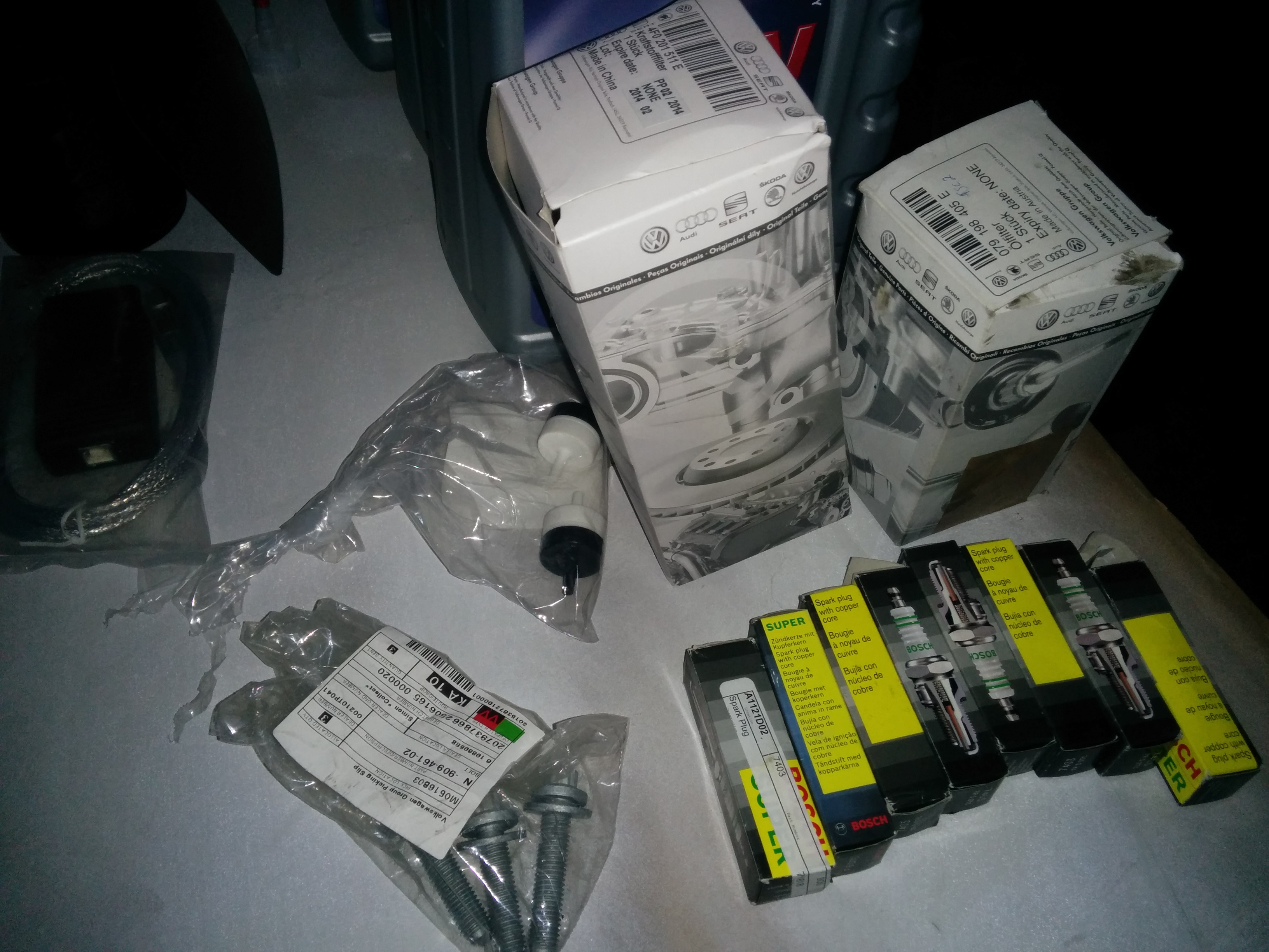

new oil and filter, fuel filter, new spark plugs, new one way valve for the vacuum system.
b7rs4 phantom black, titan pack.

sar
Posts: 768
Joined: Wed Mar 29, 2006 2:14 pm
Location: northeast uk
Re: JHM stage 1 supercharger kit

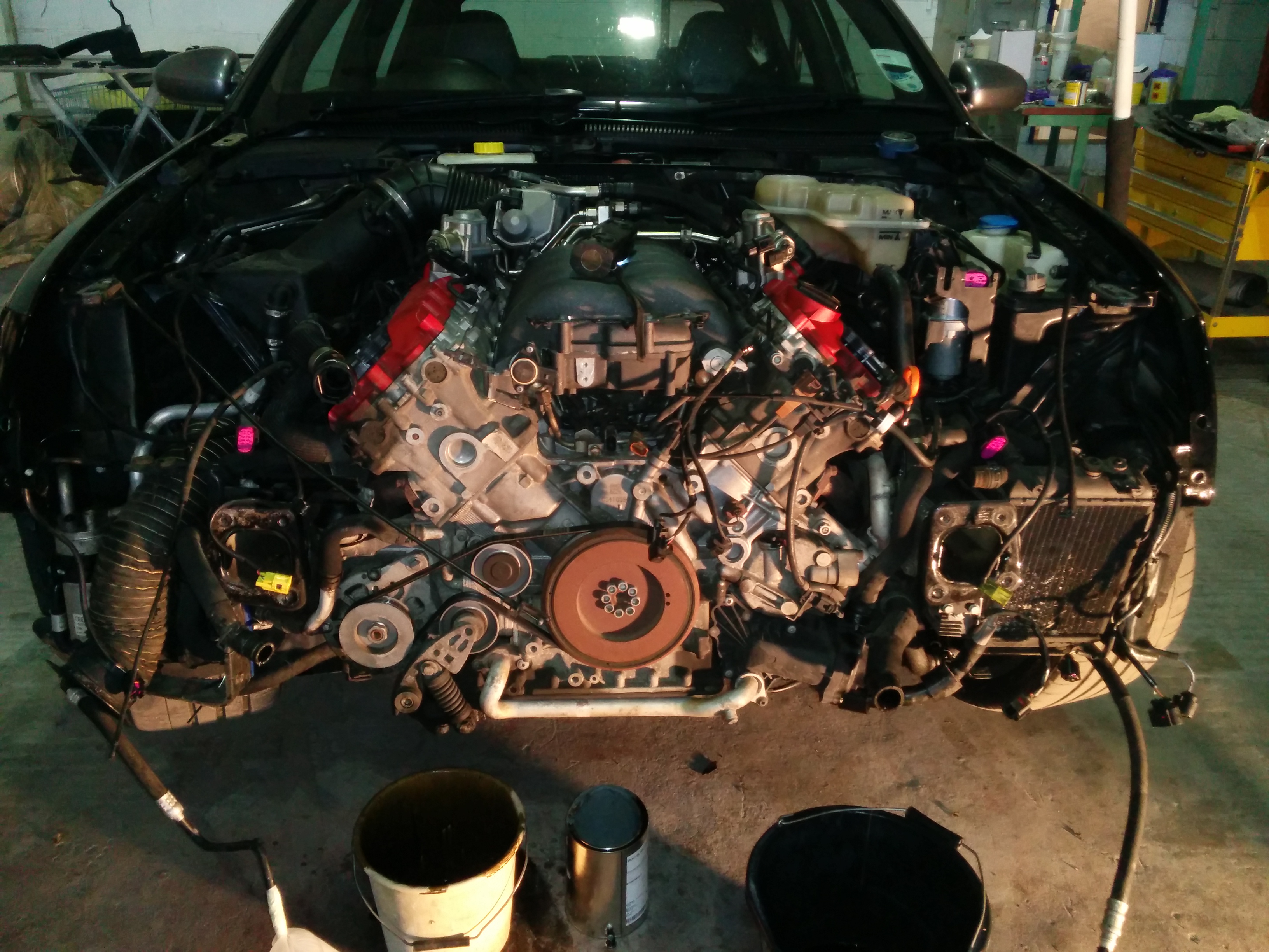

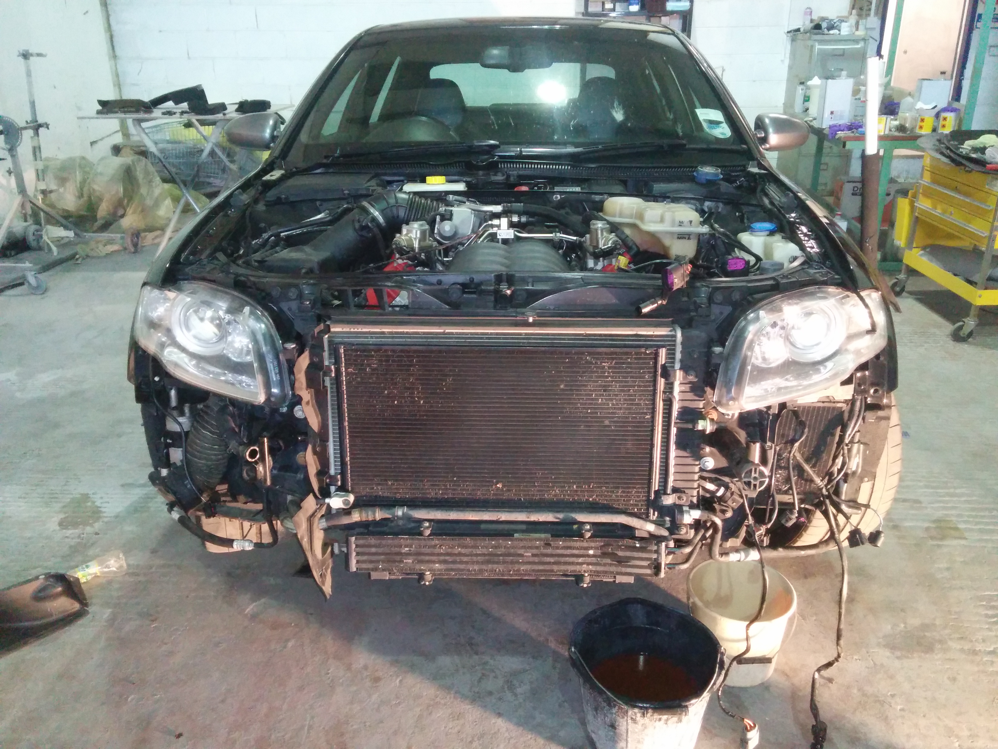

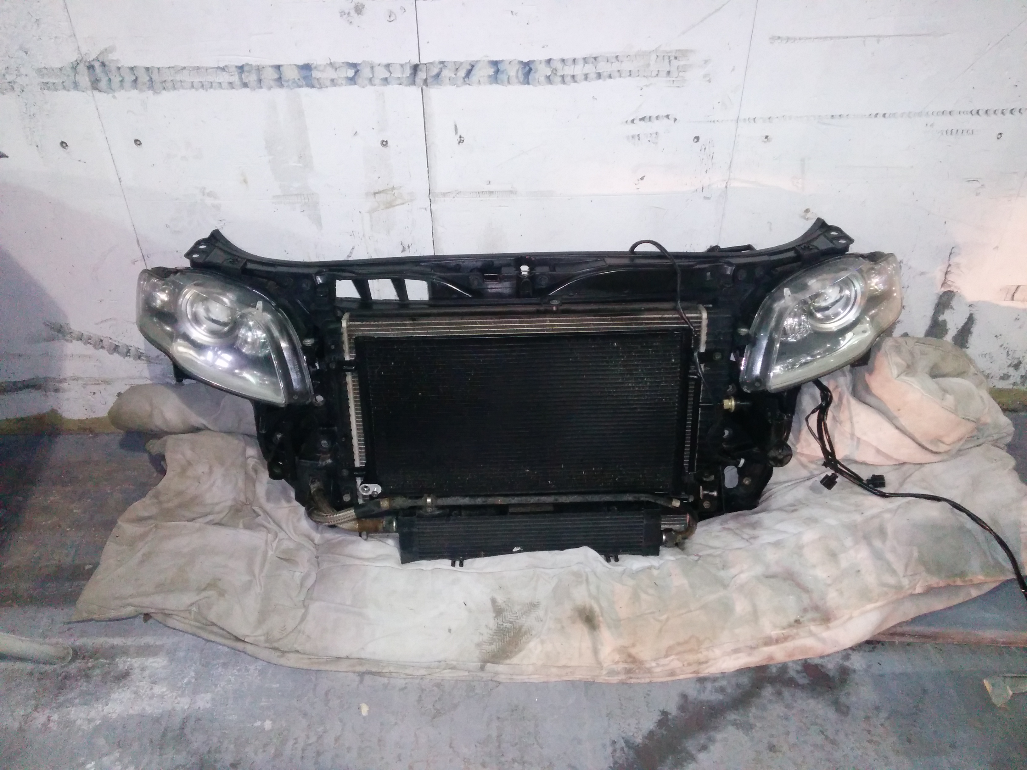

Post by sar » Mon Aug 04, 2014 12:00 am
bumper off and crash bar removed, time to drain fluids.
unplug headlights and crash sensors, detach radiator hoses and a/c lines and remove oil cooler lines from the block and the front panel lifts off as one.
leaves this
