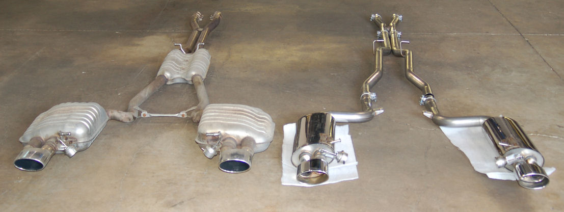

I'm looking for a bit more growl as well, but without any drone. From what I've seen it looks like cross pipes are the cheapest appropriate path or have I missed something? Secondly does anyone have a diagram showing the original exhaust system and what bits people change and names of the sections? I know its an ask, but get confused with all the different terminology and what people are actually talking about!
TonyHayers
Posts: 1175
Joined: Fri Jun 01, 2012 12:03 am
Location: Leeds
Re: Exhaust options: more "growl" but not too loud?
Post by TonyHayers » Mon Jan 28, 2013 5:20 pm
Rigsby1208 wrote:I'm looking for a bit more growl as well, but without any drone. From what I've seen it looks like cross pipes are the cheapest appropriate path or have I missed something? Secondly does anyone have a diagram showing the original exhaust system and what bits people change and names of the sections? I know its an ask, but get confused with all the different terminology and what people are actually talking about!
The crossover/x-pipe that I had fitted replaced the stock centre silencer (a.k.a "resonators"). The centre silencer (on stock cars) sits across both pipes between the backboxes (a.k.a "mufflers" or "rear silencers") and the main catalytic converters (a.k.a "main cats"). Non-resonated systems, such as the Milltek non-res systems, often just have straight pipes ("straight" as in it's just pipe, not that it's necessarily in a straight line) from the main cats through to the back boxes.
The photo below shows the stock cat-back (on the left) compared to a non-resonated Milltek (I think?) aftermarket system. These are the cat-back systems i.e everything after the cats...
HTH. Feel free to correct me anyone :)

Rigsby1208
Posts: 50
Joined: Tue Feb 28, 2012 1:28 pm
Post by Rigsby1208 » Mon Jan 28, 2013 5:32 pm
Ok a bit clearer. So working towards the engine from the pipes in the diagram there would be the main cats then the pre cats?
TonyHayers
Posts: 1175
Location: Leeds
Post by TonyHayers » Mon Jan 28, 2013 5:42 pm
Rigsby1208 wrote:Ok a bit clearer. So working towards the engine from the pipes in the diagram there would be the main cats then the pre cats?
Yep.
