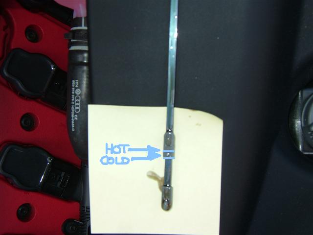

audijohn
Posts: 1076
Joined: Wed Mar 22, 2006 6:25 pm
Location: South
Post by audijohn » Wed Jun 20, 2007 10:45 am
Picture of it here:
Oil levels
Oil Level 001 (Small).jpg (32.3 KiB) Viewed 1089 times
SR71
Posts: 1376
Joined: Fri Jan 20, 2006 9:58 am
Post by SR71 » Wed Jun 20, 2007 11:38 am
Hmmmm....
Interesting. I'm suspecting my dealer hasn't put the correct amount of oil in it because having only driven it ~600 miles, I should not be having to add any more than 0.5 lts judging by the worst case scenario in the handbook (0.5 lts/1000km).
I concur with the oil being so clean you have to look very carefully to see where the level is.
When cold my oil level is only just showing on the lower bobble (which scared the **** out of me when I first checked!), but when warm, is in the A region as illustrated in the handbook....
So I see a huge variation in level with the oil temperature.
I've phoned Audi about it to see if this is normal.
Waiting for answer.

audijohn
Posts: 1076
Location: South
Post by audijohn » Wed Jun 20, 2007 12:43 pm
SR71 wrote:Hmmmm....
Waiting for answer.
I think you will find if you top it up to the Top plastic bit in my photo, then when cold it will not move much, I think that extra 1/2 ltr goes into a "smaller narrow area" and this is why i'm seeing little change and you on the otherhand are not.
