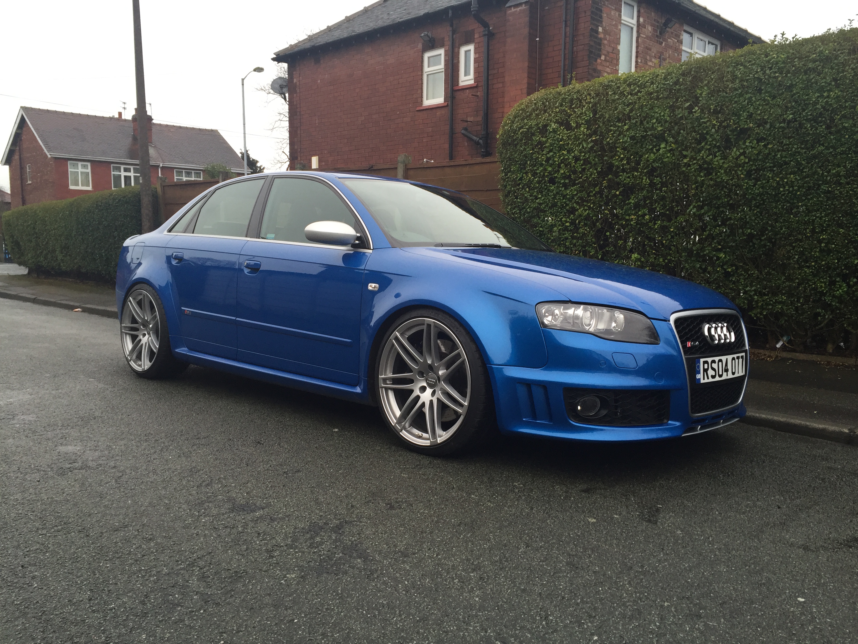

This is how she sits now. Back and front about level which is perfect. Got 10mm spacers front and 12mm rear and so far heard one scrape as I was going over a pretty big ramp!!!.
Thinkni might have needlessly undone the arm with the camber adjustment but I made sure to mark up where it was!!!

My rear with the H&R was about the same as yours but the front is higher by about 20mm.
Maybe the last owner changed the front perches?

RS4_Ollie wrote:My rear with the H&R was about the same as yours but the front is higher by about 20mm.
I have a felling they did mate as he gave me the old springs in a bag which had 2 perches in as well. Never told me why or that it had been done but I have seen people say the front sits higher without perches so I can only presume they are the B5 ones under there.
