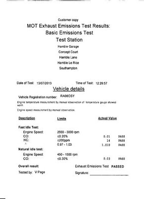

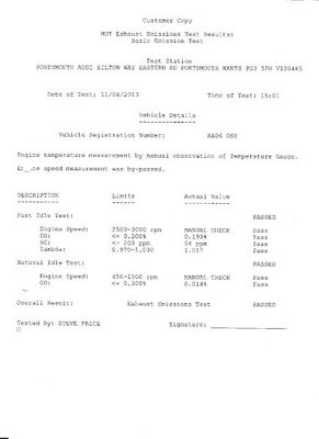

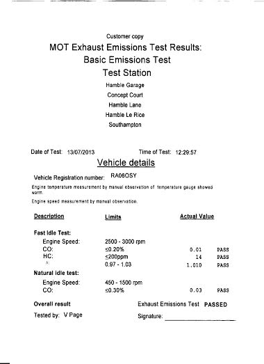

In reply to Petroldave, I am not so dismissive of Terracleaning as my RS4 B7's CO went from 0.199% pre to 0.010% thirty two days post cleaning and more relevantly to carbon cleaning, particularly in the short term, Hydrocarbons went from 54ppm pre to 14ppm post! If engine fuel combustion is more efficient, then won't there be less petrol/carbon from the re-breathing tubes to coke it up, but hey what do I know?
Emissions test results pre clean 11-06-13
Emissions test results post clean 13-07-13
