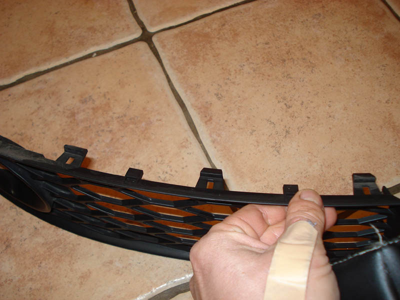

Post by neckarsulm » Wed Jan 12, 2011 11:02 pm
To supplement RS4414's excellent advice, here is a pic of the nearside grille, you can see the 3 tabs which you need to hook your finger around and release as RS4414 stated. I found it best to the inner first with my right hand index finger, then keep the pressure on pulling grille away from car and undo the next 2 tabs then pivot away from the foglight and pull towards the middle of the car to release.

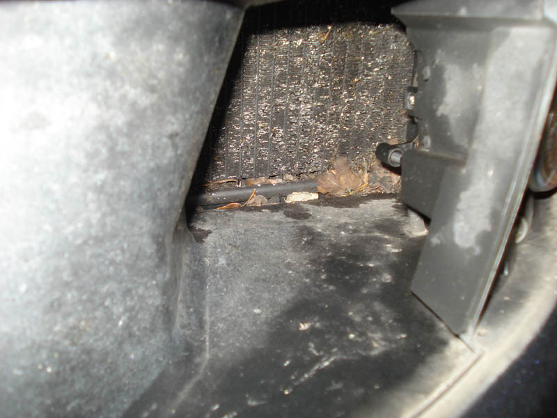

Post by neckarsulm » Wed Jan 12, 2011 11:06 pm
Here is a pic of the debris in my offside orifice, the nearside one wasn't as bad curiously

Post by neckarsulm » Wed Jan 12, 2011 11:10 pm
Thanks for your concern :) realised that was in pic too late. A B6 S4 was responsible for doing that, scraped a layer of skin off fitting a big battery in the scuttle at the middle of windscreen base, there's not much room and battery very heavy. Glad mines in the boot!
I feel stupid having done it doing that, a poxy plastic grille is no match!
