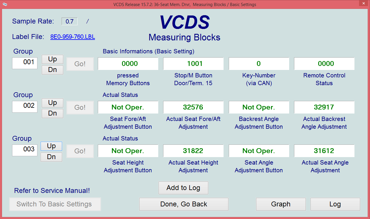

Here's what my US (driver's side on the left) seat measuring blocks say in VCDS

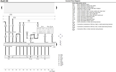

Next issue is dipping passenger mirror in reverse not working - anyone have any clues about his one. Not even sure if it's meant to do this, some forums aye some forums naw.

Perhaps stating the obvious, but you need to have the passenger mirror selected on the adjustment control switch.

Post by Surrey Sam » Wed Dec 23, 2015 2:16 pm
Sorry :oops:
I knew there was something that I had recently forgotten to do.
Here is the wiring diagram for the mirror if that's of any use, well done for getting the seats operational.
