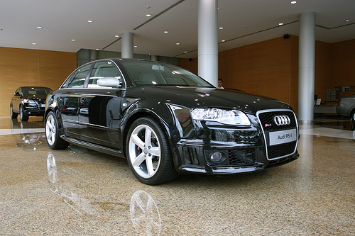

Post by Ian_C » Thu Aug 29, 2013 7:54 pm
jimbo1234567 wrote:never knew that 18,s were an option onthe b7, dont think ive ever seen any.
Rare! Super stealthy, came in both 8.5 and 7.5" fitment, the later being offered on the continent as the winter option. :thumbs:
Re: ceramic rear brakes
Post by MikeFish » Thu Aug 29, 2013 7:59 pm
Almost looks like a Lotus Carlton! If the spoke were angled slightly it'd be not far off!
