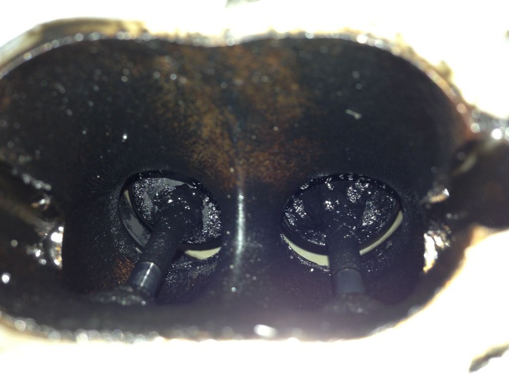

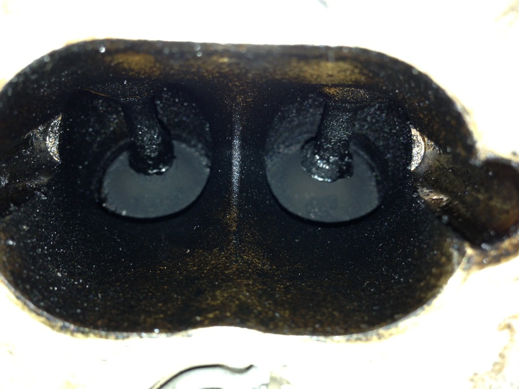

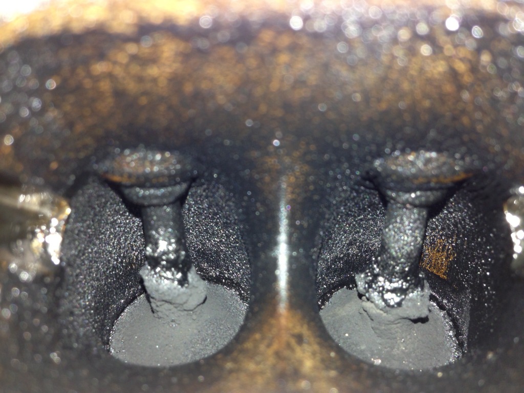

The car is taking a bit longer as the speed sensor failed when they went to fire up the new exhaust (talk about bad luck). So now the car is down getting the cc done and the tune will be completed tomorrow. Hope to have the car back in my possession late tomorrow night.
A few pics of the carbon, can't believe how bad it already is since its only been about 15k miles...

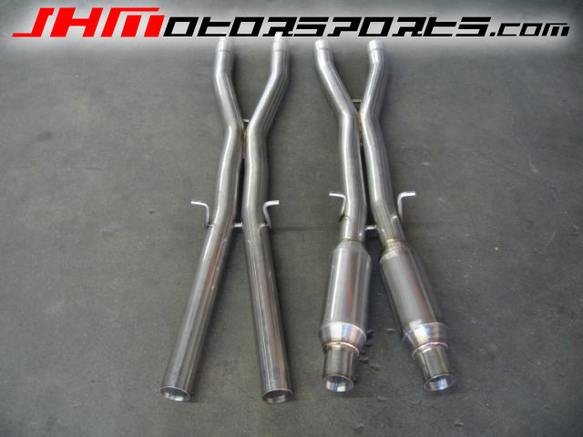

sar wrote:x pipe is essential.
Interesting, what magical powers does this x pipe bring Sar? - I've seen two pipes joined together in a 'x' config on the popular offerings from MTM, JHM, MillTek ETC [on 'cat back' systems] and they 'apparently' assist with top end BHP - Do you mean something similar to this fella?

yep thats an x pipe.

Can't see how that's essential - but then again I am far from understanding the gas dynamics of a NA V8 exhaust mate.

an x pipe scavenges gas from each side and vice versa to pull the gas through the exhaust and out, the ones above dont look like they have a join between the two if there is it doesnt seem to be very big.

scavenges between the banks.
someone will be able to explain it better than me but basically rather than having a separate pipe for each bank they are crossed over slightly with an x pipe.
after combustion a pulse of exhaust gas travel down your exhaust from each cylinder when a pulse from bank one gets to the x pipe the pulse from bank two is slightly behind it on the opposite side of the x pipe, the pulse from bank one causes a pressure difference or something like that and pulls the pulse from bank two and then pulse two pulls pulse three and so on.
you get a scavenging affect that increases efficiency.
that description is probs wrong lol but some vodoo happens and its good :thumbs:
