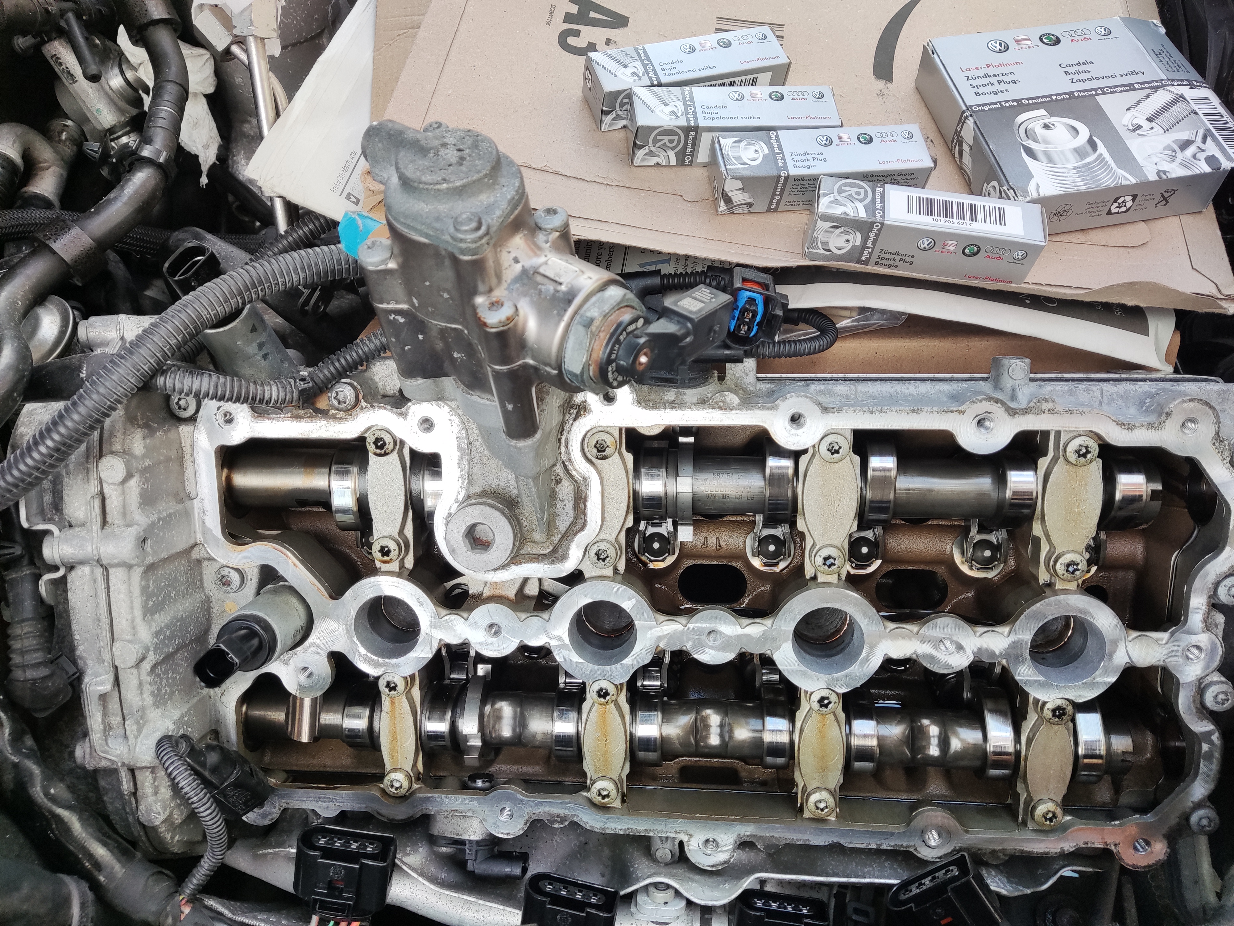

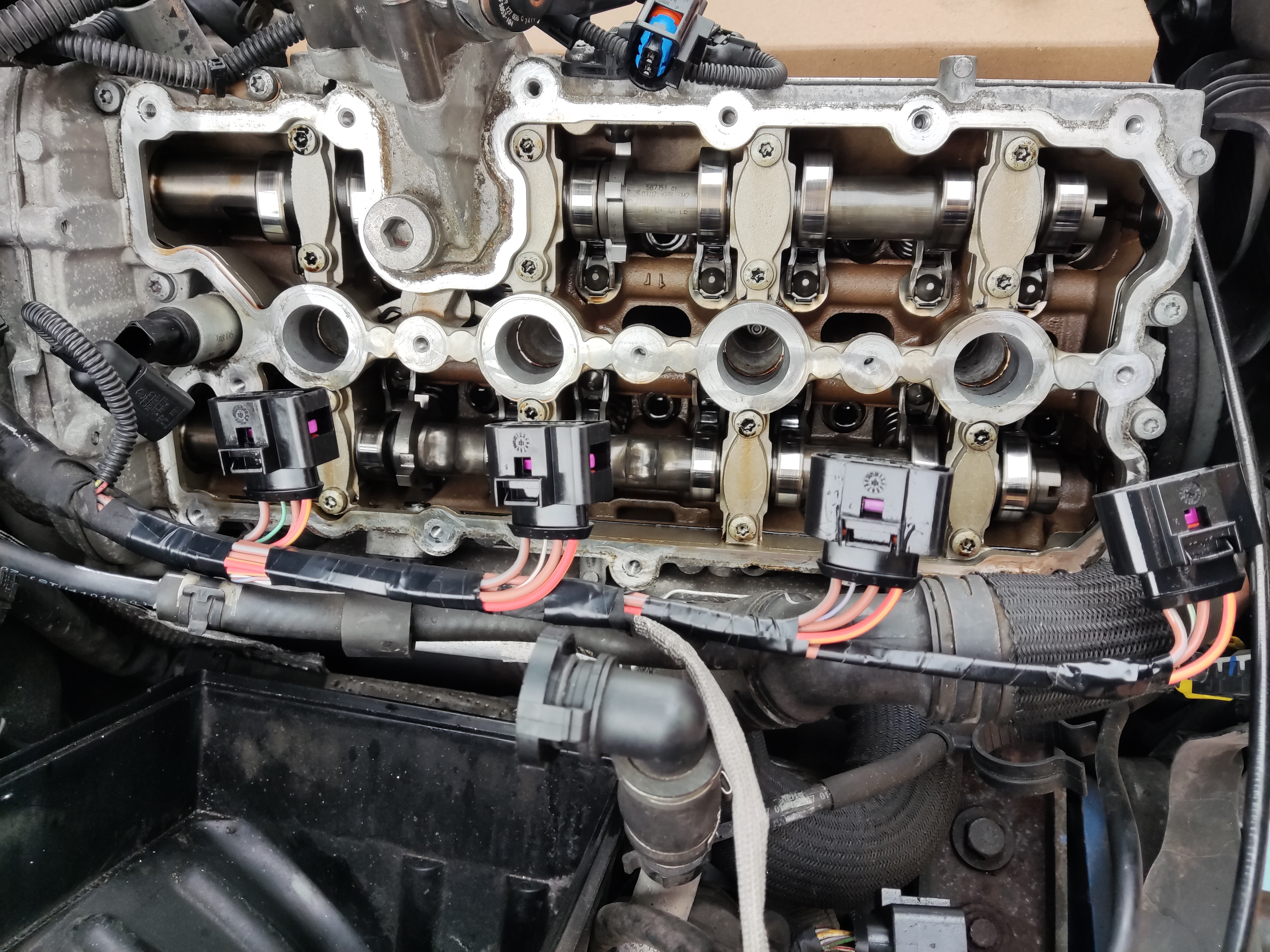

ok, so whilst renewing spark plugs, broken coil pack connectors and rocker cover valve gasket .. I also have the envious task of changing some of the rusted rocker cover torx bolts.
You would think they should slip out 'fairly' easily.. but they're really stuck in there.
Knowing how old and likely brittle from years of engine heat the rocker covers are.. I'm little apprehensive of causing damage to the covers - as they're not cheap!
Anyone know of the procedure / trick of replacing some of the rusted rocker cover bolts.. ?

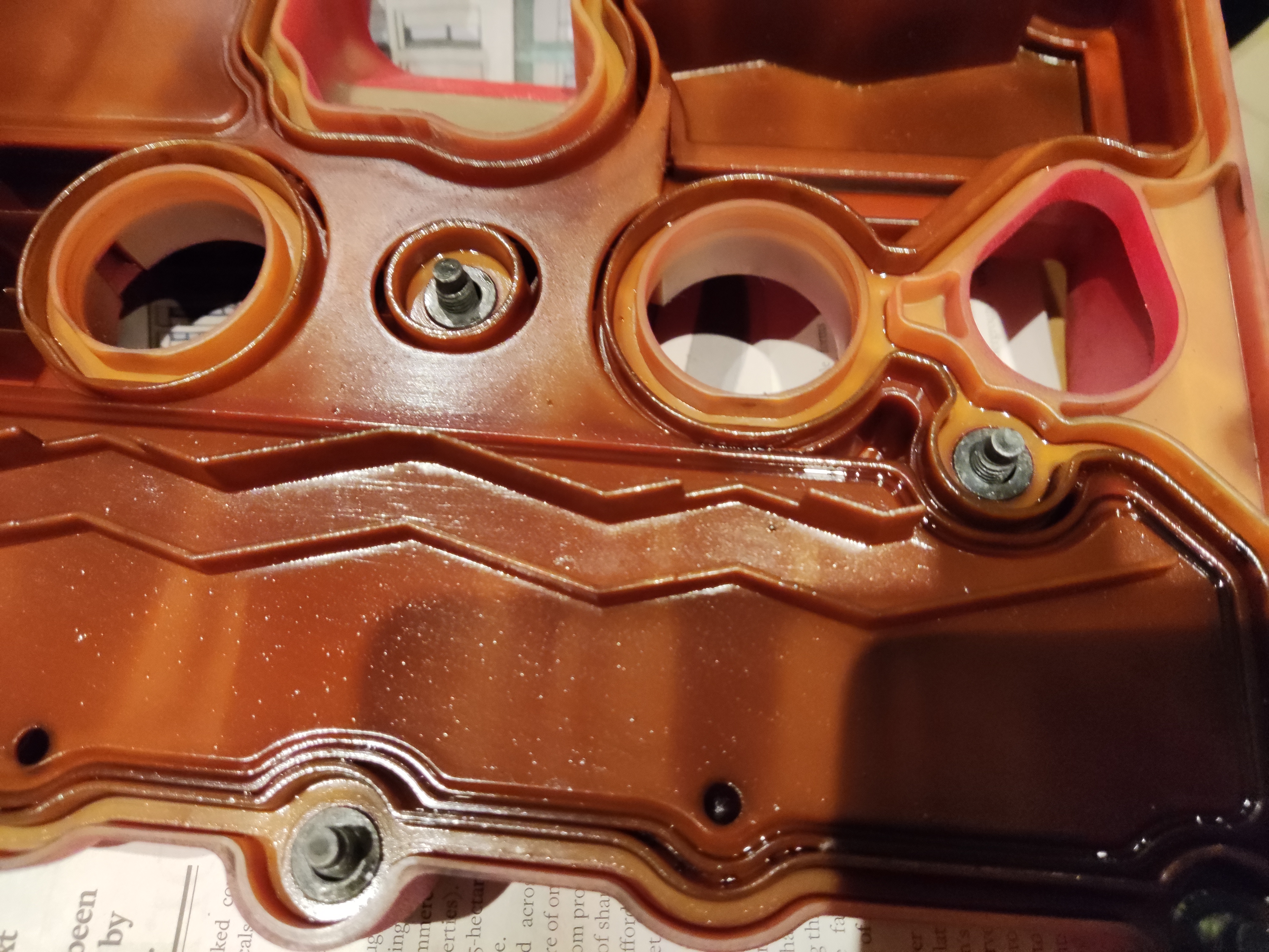

ok. scratch that.
managed to get some out... applied some wd40.. and .. waited.
then very carefully pushed them through from underneath (using hands only, not easy)
Will update with pictures once all done and cleaned up.

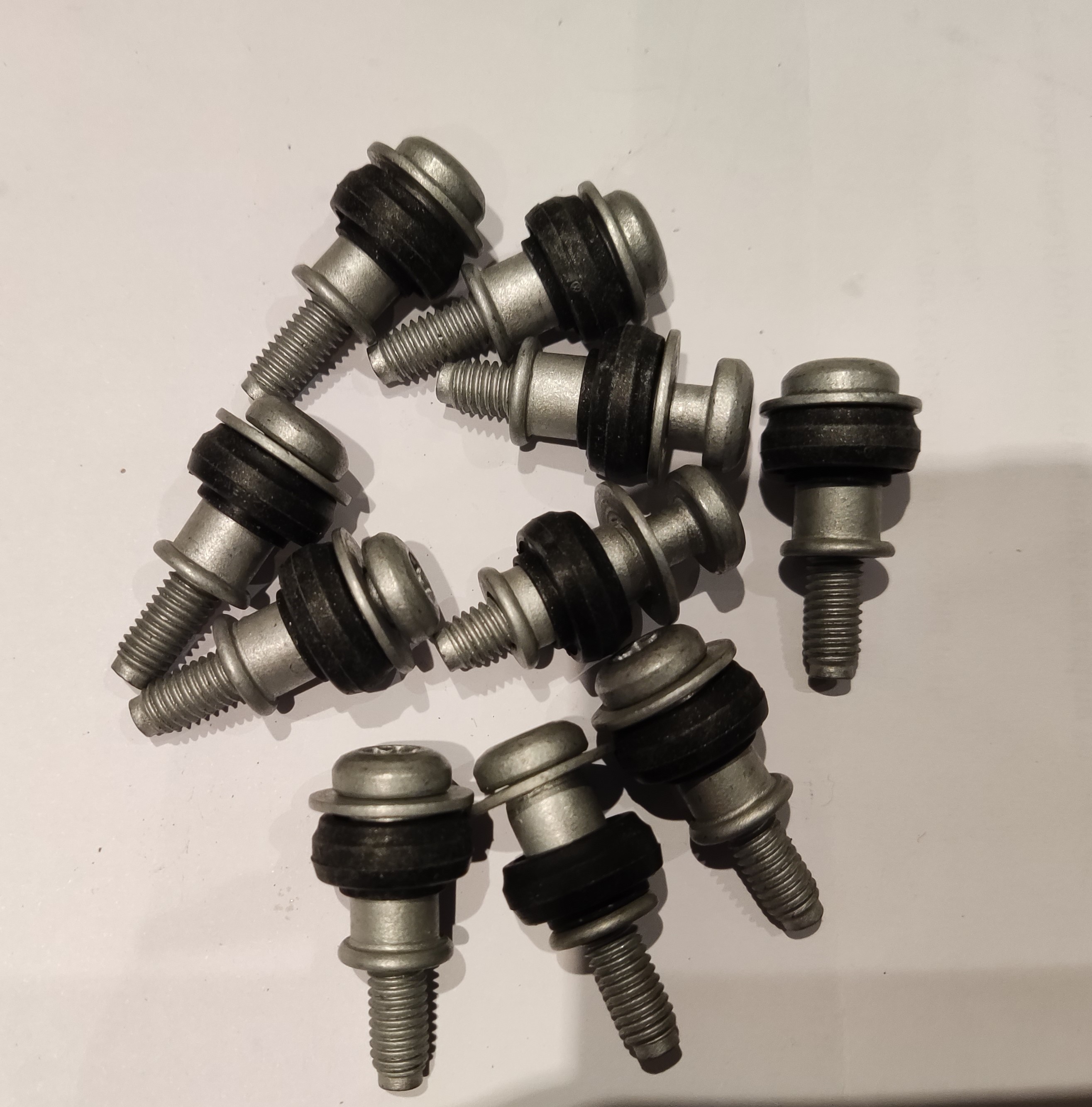

fyi. Genuine Audi Hexagon collared bolt with guide sleeve
Part # 03G128773A

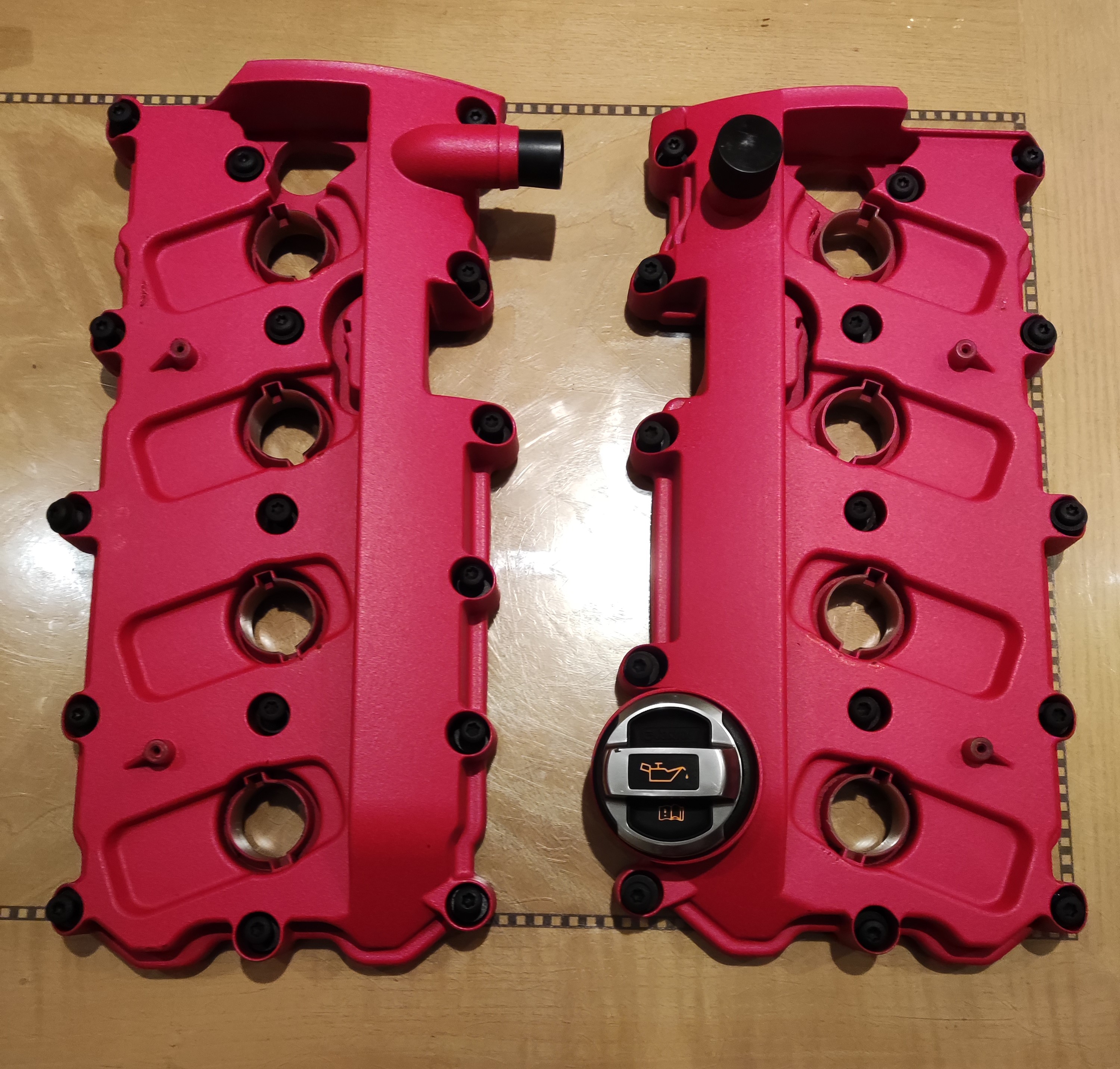

Post by r8wut » Sat Apr 13, 2024 9:52 am
cleaned up nicely.. with general 'elbow grease' spray..
would have been nice if Audi supplied the replacement rocker valve cover bolts in black :roll: to match with existing ...
anyway, just carefully painted bolt heads in Hammerite black.
